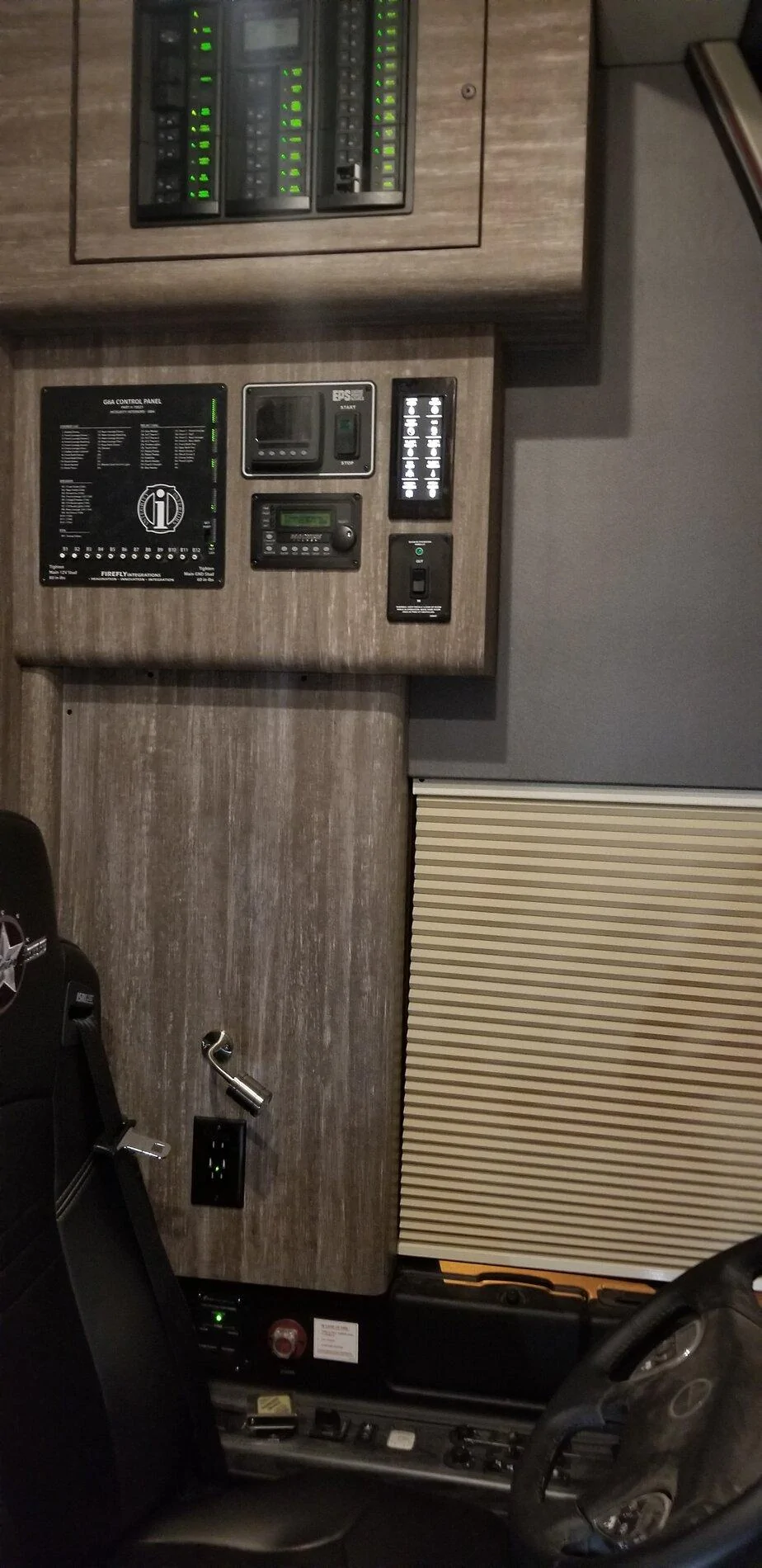

What all’s going on in that photo, just for my education?
That's 6 lithium batteries with a 265 amp aux alternator and a 30 amp solar charger. This rig is meant to go off grid for days without a gen. There is a 3000watt Victron inverter/charger. It has a 30 amp shore inlet to keep charged will plugged in.
