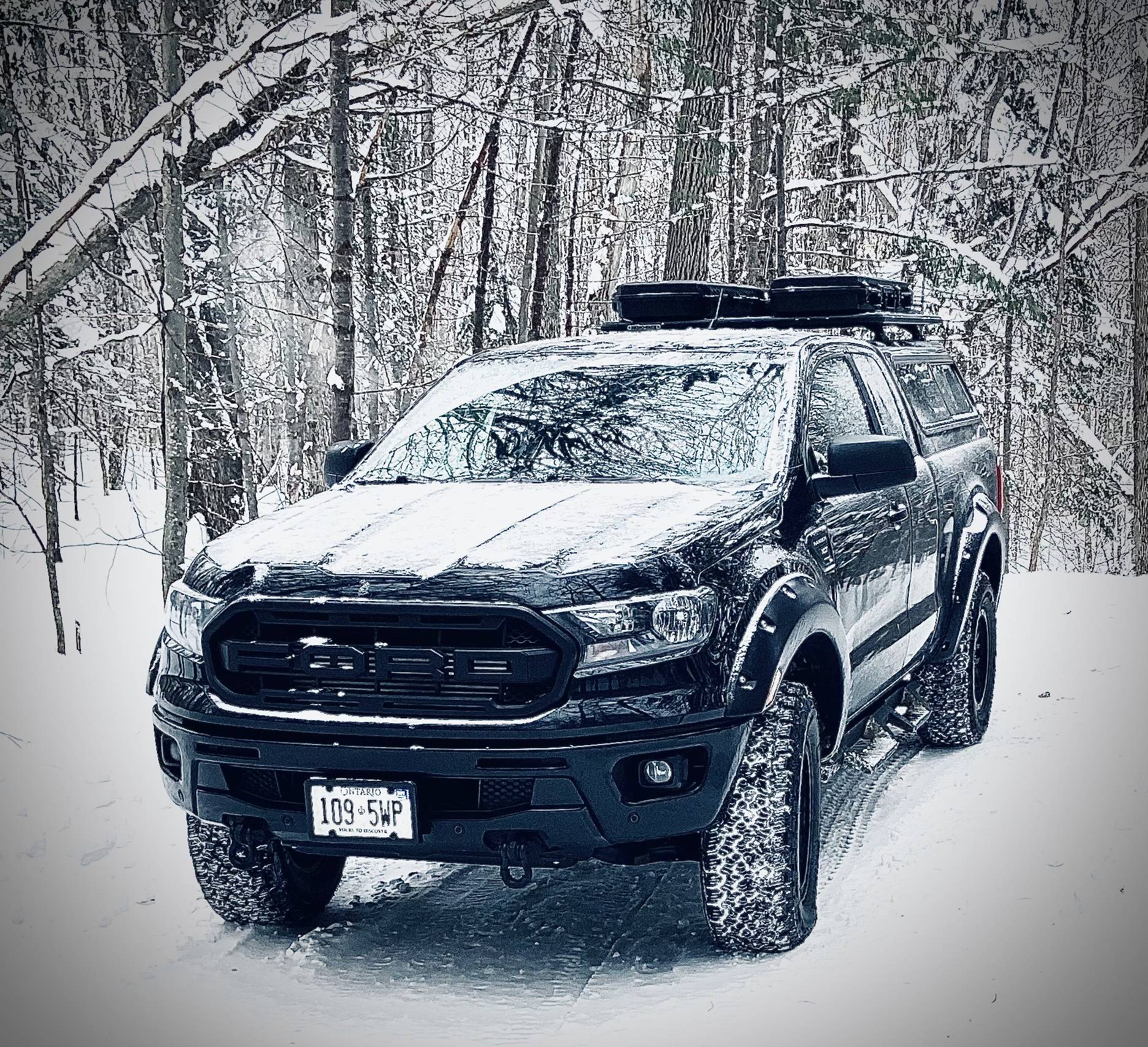

Hmm, I have to say there were plenty of Rangers out there that looked a lot like this before the Ranger Tremor was even announced - this is a 2019 - no spacers - more capable tires - step nerfs - better suspension - on a Canadian backroad - not a mall parking lot.

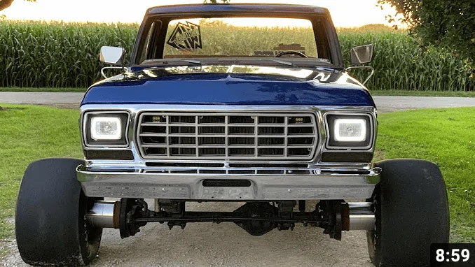

There is always someone!
We had one of these on the farm growing up but I don't remember the wheels sticking out QUITE that far.
