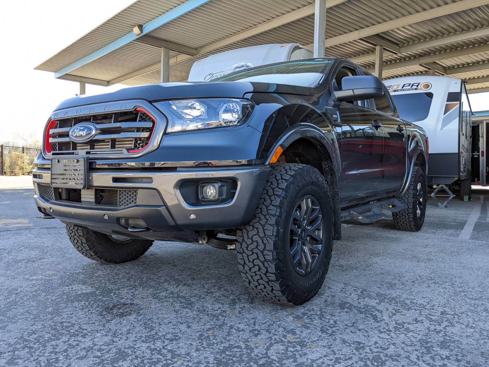

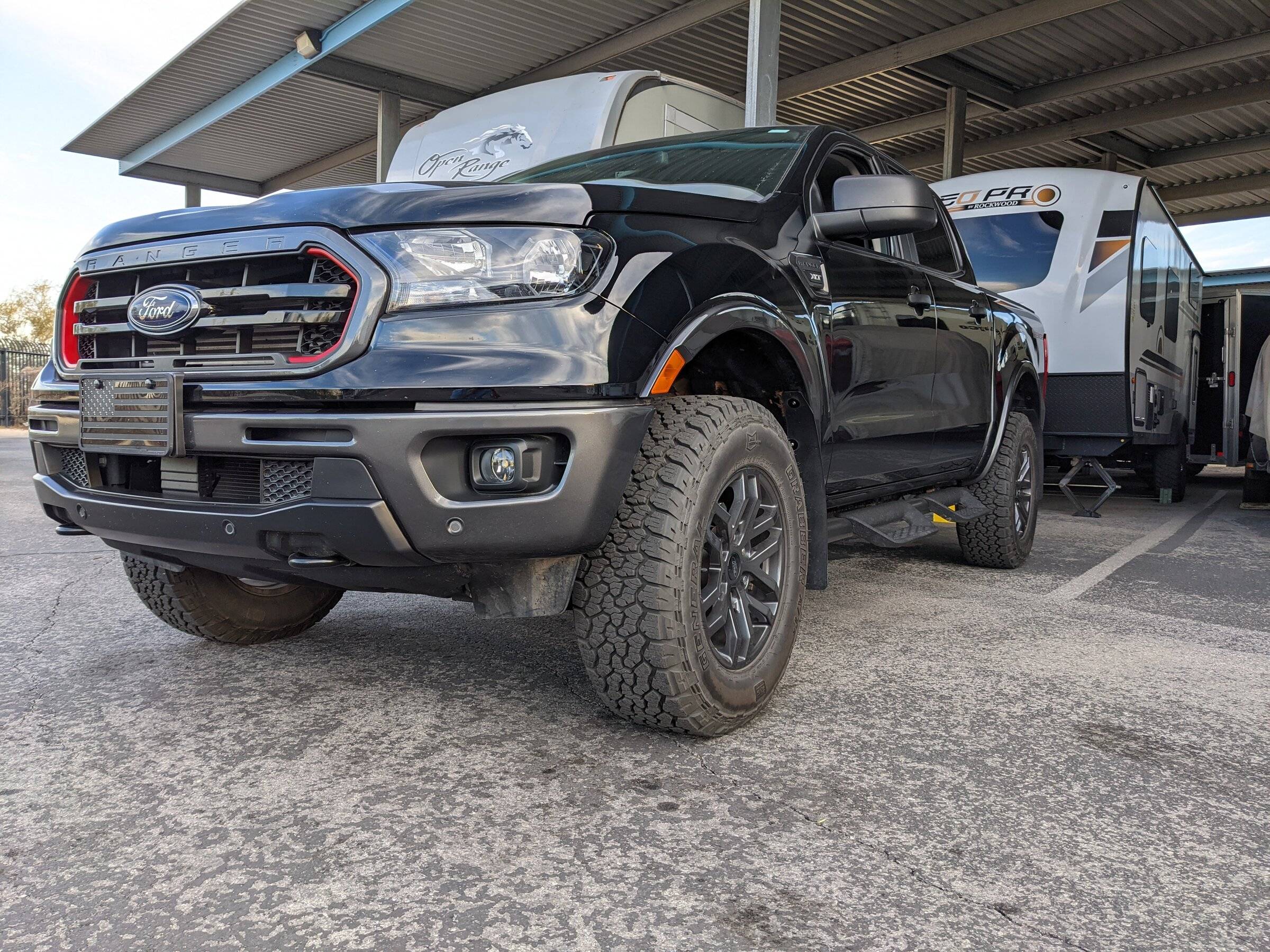

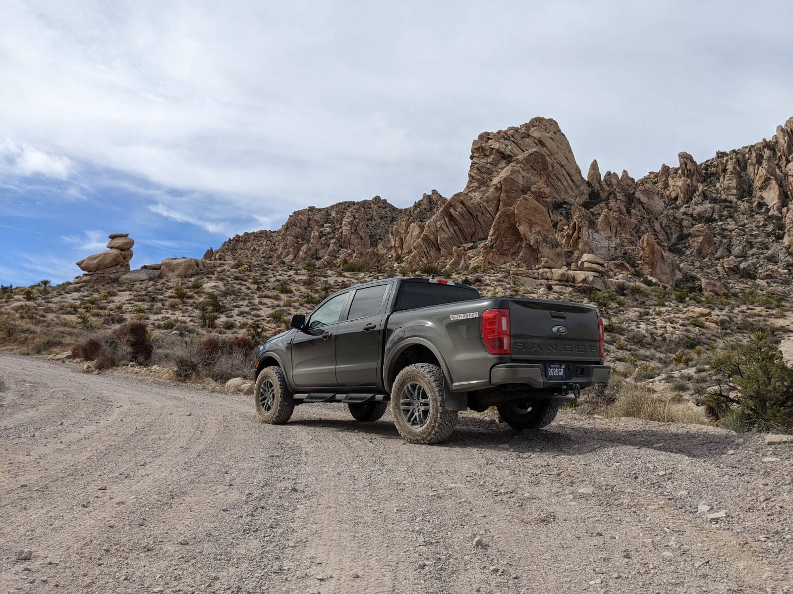

Depending on how wide you want to go, just some mud flaps if you want to save your paint a bit. I have 1" wheel spacers on my Tremor and that put the wheel about flush to maybe a pinch outside the body. Sounds like you may want the 1.5" wheel spacer though.
With the Tremor wheels and tires and the 1" wheel spacer, all I needed to do was push the intrusion bars out some to stop rubbing. I had a PINCH of rub only in reverse with steering locked to the right. When I did the 1" level, that stopped it all completely.
This image was stock height with 1" spacers on the Tremor. 1.5" spacers might be what you want though.
This is with 285/70/17, 1" level and 1" wheel spacers
