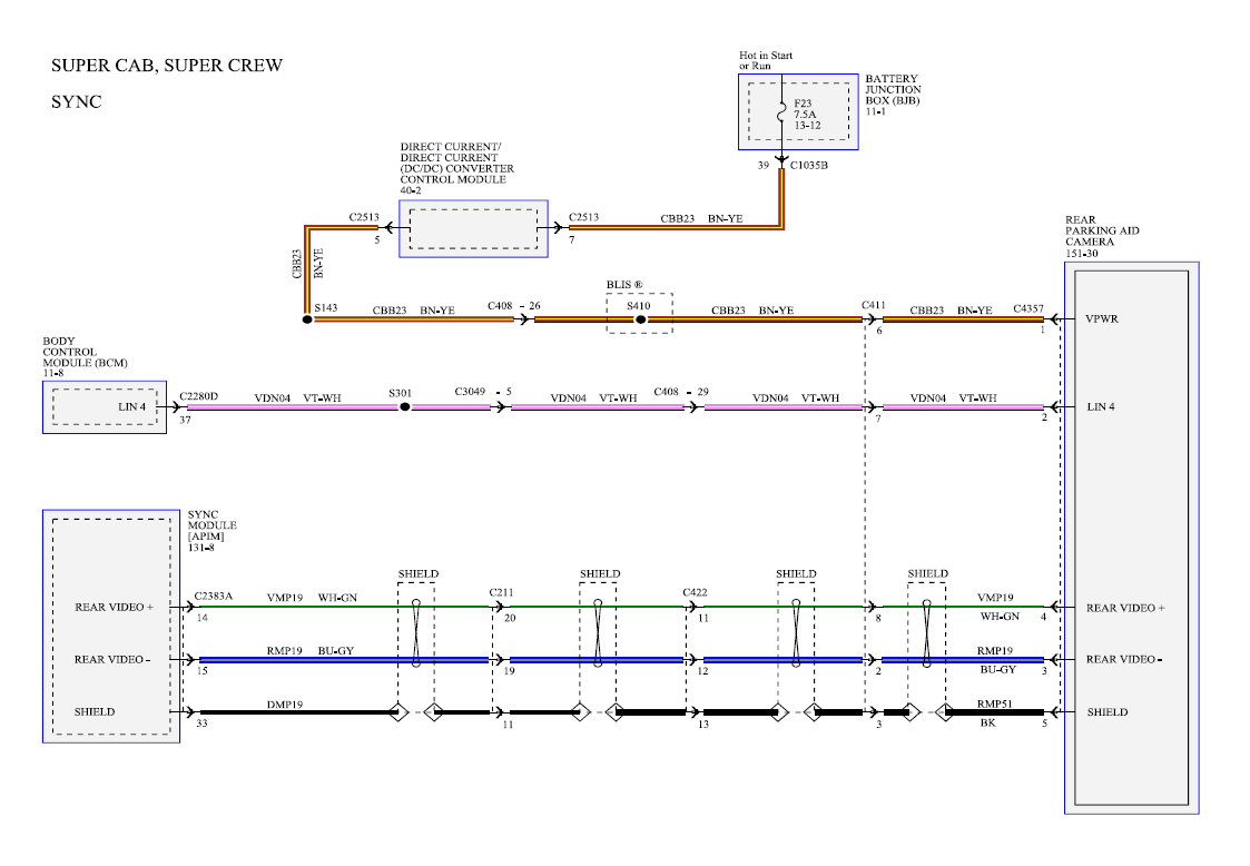

UPDATE - see attached pdf. It appears LIN4 is a 2 way communication line.
If this is correct - DO NOT TIE IT TO GROUND!!!!!!!!
Redacting my earlier musings.
Pulling the schematic, the camera, as expected, is controlled by the BCM.
3 of the wires are video, 1 is PWR, and the last is "LIN4".
I am making guesses here so proceed at your own risk!
LIN4 is the control line that turns the camera on, as Pwr is hot when vehicle is on LIN4 is likely a switch to ground to enable the camera. If this is the case its pretty easy to add a switch. I would go with a momentary - no reason to try to leave it on for extended periods of time and no idea if this could be detrimental. So a momentary is safest bet.
NOW - whenever tapping into Module line Proceed with Caution. If I was going to try this I would pull the terminal pin from the connector (at the camera) or cut the wire to the BCM and apply ground to the camera and see what happens. Or if someone has a spare camera try it on the bench 1st.
The other unknown is just because the camera is on doesn't mean the head-unit will show it. The shifter probably communicates with or thru multiple modules; PCM, BCM, APIM, etc. I suppose its possible when the APIM sees a Video signal it displays it, but not guaranteed.
Good Luck and if anyone trys this report back!

Hi
Can you expand ponts like : Pinpoint test A please ?
micl9
Dec 21, 2019
1,373
1,969
Apex, NC
2019 Ranger XLT Fx4 302A
Hi
Sorry its not included in my manual. the link in the table goes to the end of the section.
PINPOINT TEST A : THE REAR VIDEO CAMERA IS INOPERATIVE OR DOES NOT
OPERATE CORRECTLY
which is a dead link.
