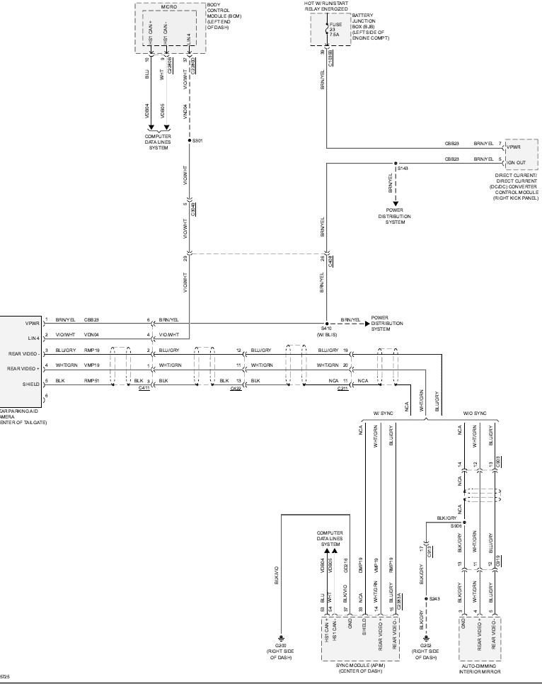

Camera:
B115E:08 is a generic code - Cam Module Bus / Signal Message Missing on LIN Circuit
It leads you down a in depth wire check, which may be a wiring issue.
But first try finding anything in Forscan about Rear Parking Aid - Initialization as it may just need to be reconfigured.
So, it may take some Indepth wire checks for a fix, but I would try to at least pull and clean C411.
and with a trusty helper - put truck in reverse - - to get camera up and shake the harness where it comes out of the tailgate and note any camera display difference
Thats all of the easy checks and depending on how comfortable you are with a meter; the rest is checking for circuit integrity. But for a full test involves ripping part of the dash out to get access to the APIM Connector, the BCM Connector is at least easy access.
If all above options do not work, then it is a dive into the wiring.
I would at least start with a simple Power & Grd check:
C4357 = Camera Connector
Key On
C4357 - Pin #1 to Grd - 12 Volts
Key Off
C4357 - Pin #5 to Grd - 3 Ohms

If we only focus on the message -Com Bus Signal Message
And think outside the box, I would focus on the LIN Circuit.
The Lin Circuit is the customizing control (zoom) of the camera.
So, with that known and you have checked and cleaned connector C411.
The BCM controls this via the Input from the APIM, (Sync-Screen)
1. Reset - The Sync Screen (if no help)
2. Pull and Reseat Fuses - At the BCM - Fuse 34 - Lin Circuit Feed
Fuse 31 - APIM Sync Screen
3. With Rear Camera On - Try adjusting the Camera Zoom and any other camera control, as I think the camera just needs to move (focus wise)

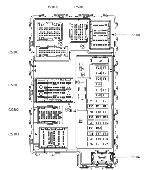

There are a few more connectors in the cab,
If running a new install initialization on it does not fix the issue we can check the other connectors.
But try the easy access first. C2280D - BCM - By your left knee.
