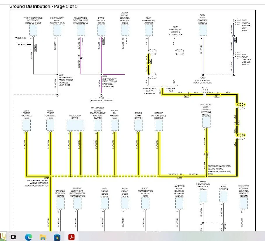

Here is where the Camera ties into the Headlamp Switch circuit and I see exactly why the camera is not working. The issue is with the Camera ground circuit and how it is tied into the Headlamp Switch (itself)

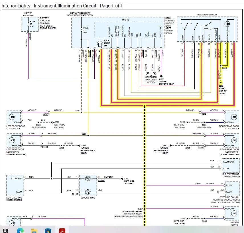

If you look below at the Interior Lighting Circuit
This also shows the circuit (Command) from the headlamp switch and BCM.
Ref: the 2 codes for headlamp (Auto) & (Off) - The common between the 2 codes is the ground pins 4 & 5 - (Pin 4 is ground for the Headlamp Switch / Pin 5 is a ground for the O/H Console Lights and Rear Cargo Lights and Background Illum (Ambient) lighting they tie together with a splice S243 - see next Ground Diagram
I am thinking the (Autolamps) Auto & Off is being disabled by the short circuit. That is why you see the codes for this.
I am thinking you are possibly manually turning on the headlights, they are working but most likely seeing a weak light output or flickering, the amperage draw is greater with the lights on and overcomes the ground issue, the camera though is not able to get a good ground.
Look at the diagram below and picture the Right parking / stop lamp and license plate lighting being shorted to ground.
So, either the issue is at the headlamp switch by the (switch) codes, or the exterior lights circuit is taking out the (switch) circuits (Disabled by Circuit Protection)

Now look at the ground circuit, note the Headlamp Switch shares the Ground with the Rear Camera. So, with your specific issue it looks like you have a short with voltage on the (Ground) circuit. Coming from either the Headlight Switch circuit or the Right-Side Exterior Lighting circuit

I am curious if you have any other lighting issues, interior lights or exterior lights, the interior lights to look at the Overhead Console, Footwell Lighting, Background Illum and the Rear Cargo Light, just wanted to see if those are affected as well with this issue.
The Common Ground Point for this is G202, it may be worth just checking this point and while having access - Use a meter on voltage scale, and with engine running check this point for voltage. Use a nearby ground point as (-) and the positive lead to G202. This will serve as a check point if you get a voltage reading here, as you disconnect lights etc. look for the voltage reading (If any) to disappear.
It may be possible that all you have is a bad ground here, and the Park Light code is a separate issue. That's why you should at least check this ground point.
If by chance you do not have voltage on the G202 then the Headlamp Switch codes are generated by a bad ground connection and the Park Light is a separate issue and may just be simply burned out.
So, in case this is a Bad Ground connection, with looking at the ground circuit above you will have lost ground between the Headlamp Switch and G202.

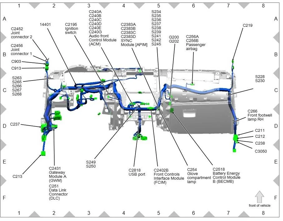

There is (1) splice point in that run between them S243
I suspect your Footwell Lights would be a quick visual for a ground loss, as they would not work with a ground loss.
But before you rip dash appart for a bad ground, I would check the headlamp switch connector ground on pins 4 & 5.
You might try turning the switch to off or disconnect connector , and try camera. This should prove a lighting issue vs a ground issue. Might isolate the issue, as you should not have any voltage on the lighting system with the switch disconnected.

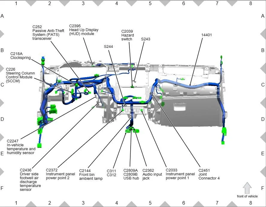

The best I can get is approx location: Near the Hazzard Switch

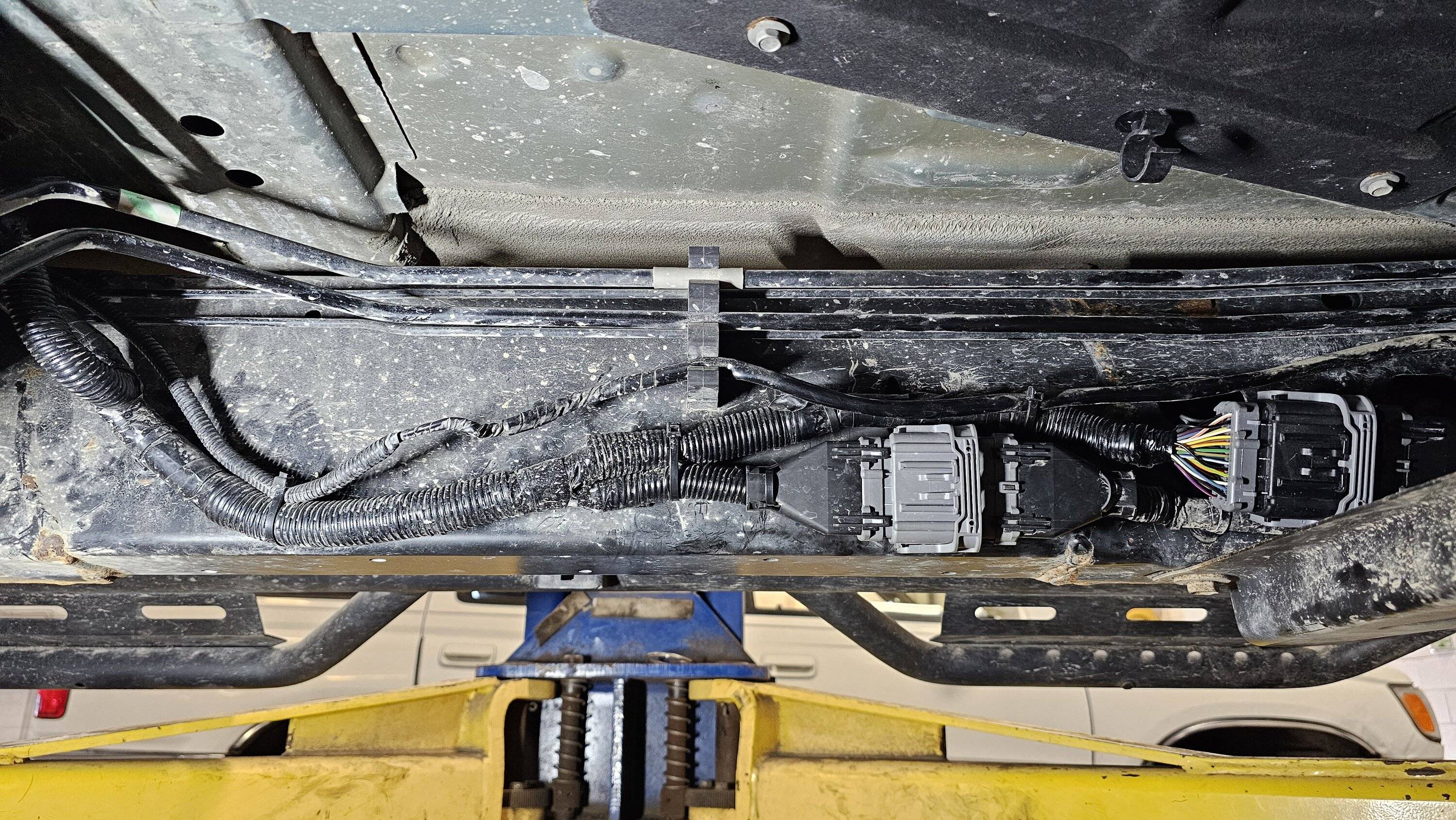

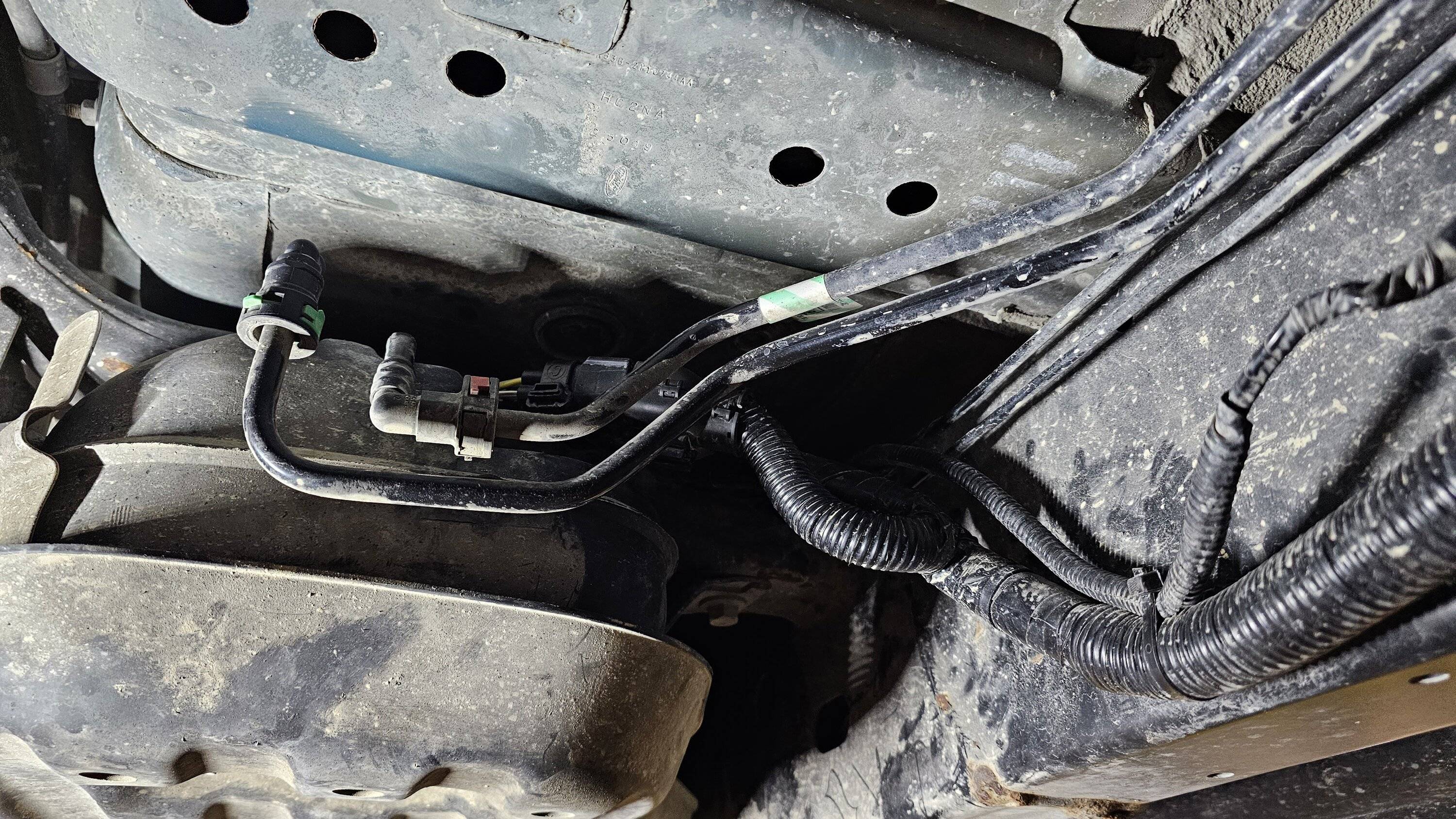

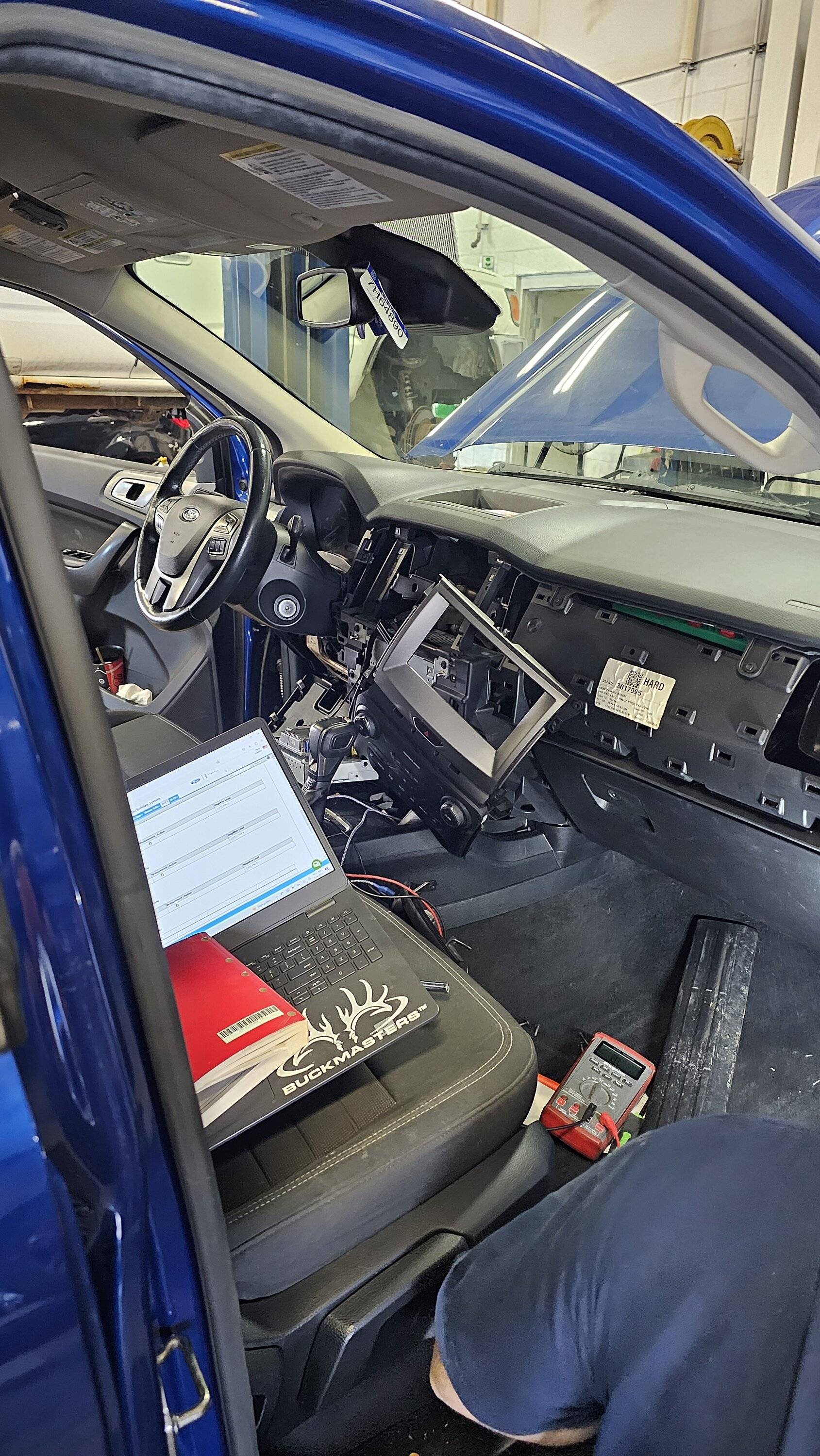

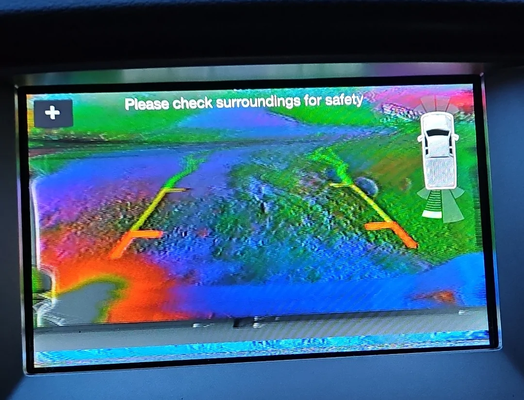

Quick follow up now that I've exhausted my level of comfort with the wiring intricacies... I am at my local dealer and it has been finally determined that someone at some point did some harness work underneath the truck and had pins either missing or placed wrong in the harness in the run from the drivers side to the rear camera harness that runs up into the tailgate. This is after the diagnostic path took us all the way to the APIM. I now have a working camera. I have no recourse as the purchase was as-is and the warranty coverage I purchased does not, to my knowledge, extend to wiring harnesses. That is a discussion I will have to have with them but I don't hold out much hope. Attached are pictures for reference. Notice the cleanliness of the harness compared to the rest of the underbody which I haven't washed since I bought the truck.
Jason B
May 19, 2021
3,103
8,691
Louisiana
2021 XL STX SE 4x2
machinist
Looks like someone swapped connectors, possible due to water intrusion or corroded pins. IF that was done by Ford, there would be a record of it.

Glad - the issue was finally resolved, it sucks it was not an easy find.

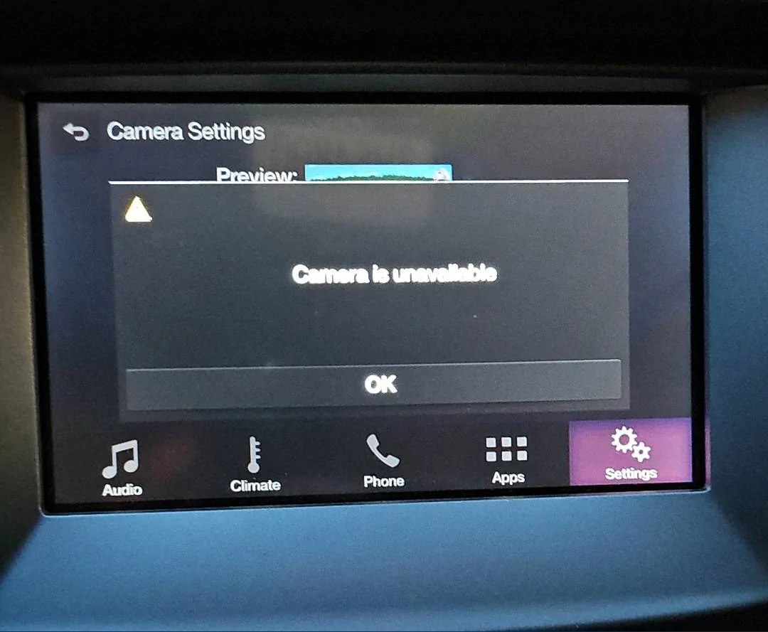

my investigation just restarted - and I found 2 errors :
B115E(08) Bus Signal/Message Failure
and wher the Reverse gear is on - another fault : C1001 FORD Vision System Camera General Electrical Failure
Camera is checked on the other car - works
Possible causes :
– Video Camera harness is open or shorted
– Video Camera circuit poor electrical connection
And again - it is a bit difficult to find without a diagram
Is there anyone with FORSCAN which is keen to advice ?

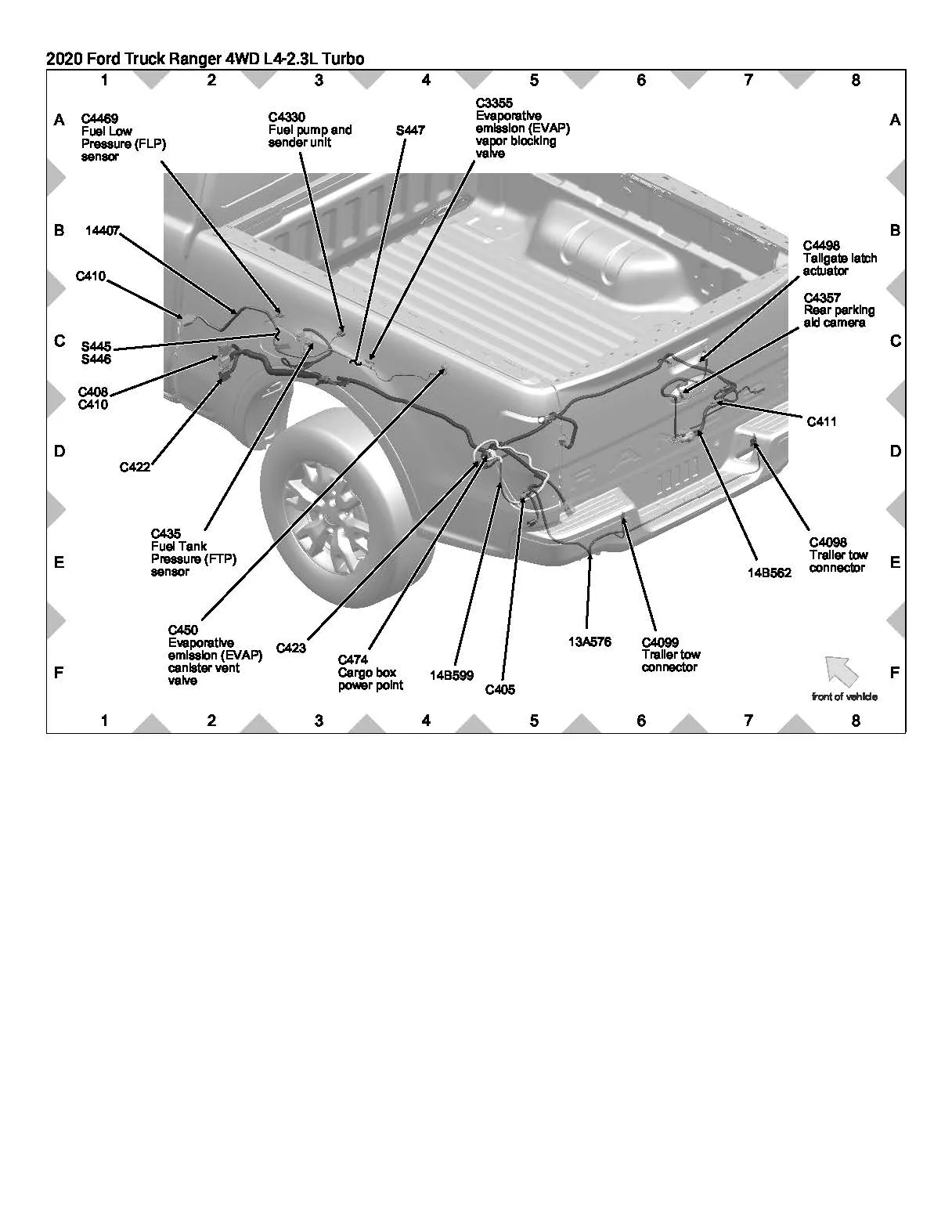

I would possibly go to the connector posted above - disconnect and clean , check for corrosion as well.
It should be on the left frame rail near the left rear tire.
I am pretty sure that the pic taken is in that location.
