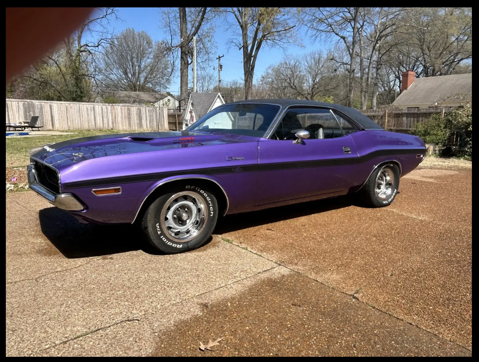

I’d drive it, too.
Closer, but mine has the Magnum 500 wheels, and was not an R/T. It's impossible to find an Internet pic of exactly how mine looked. most have the Rallye wheels as shown above. Back then you could spec a car with any options you wanted; no packages.You had a choice of the new at the time filament grid rear window defroster, or a fan mounted under the package shelf, mine had the latter, also an am/fm monaural radio. As I look back, that car was a unicorn!
Fender mount turn signals// Magnum 500 wheels
