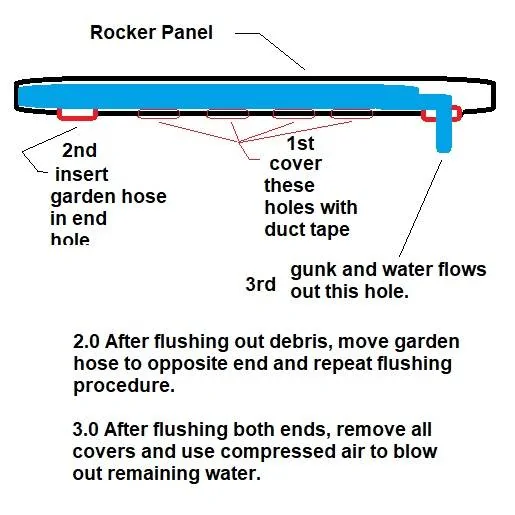

it is a concern about moisture inside.....as it would be with any scenario, whether originally plugged or not.
if its sealed properly, you won't add to it. but you might seal in some moisture inadvertently.
i would suggest anyone who plans on plugging their holes to wash, blow and thoroughly dry their rockers inside before putting the plugs in and then do so with silicone around the, to maintain the seal.
otherwise you may be doing more harm than good.
Do you think a blow dryer would work? Or should they just get down there and blow into the holes?
Seriously this is a good point, I'd definitely blow it out with compressed air, and probably take a shop vac to it. You can make custom attachments for a shop vac with decreasing sizes of heat shrink, that'd work pretty good I think.
While that might sound plausible, you'll never get all the crud out. Think of the rocker panel as a round tube with the ends capped and holes along the side. Blow air in the hole at the side, it blows the crud to the end of the tube, where it stays.
Maybe try this.... then take it to the dealer to install factory style plugs. maybe use silicone on the plugs before installing them.
All a matter of how far you want to go with it. After seeing your idea, seems doable. I'd maybe make that the first step, then some air, then let it sit for a bit, then a shopvac with a custom heat shrink "anteater" nozzle, then seal. If you're really worried about it you "could" try to work some POR-15 or the like in there. But I think that would be overkill.
