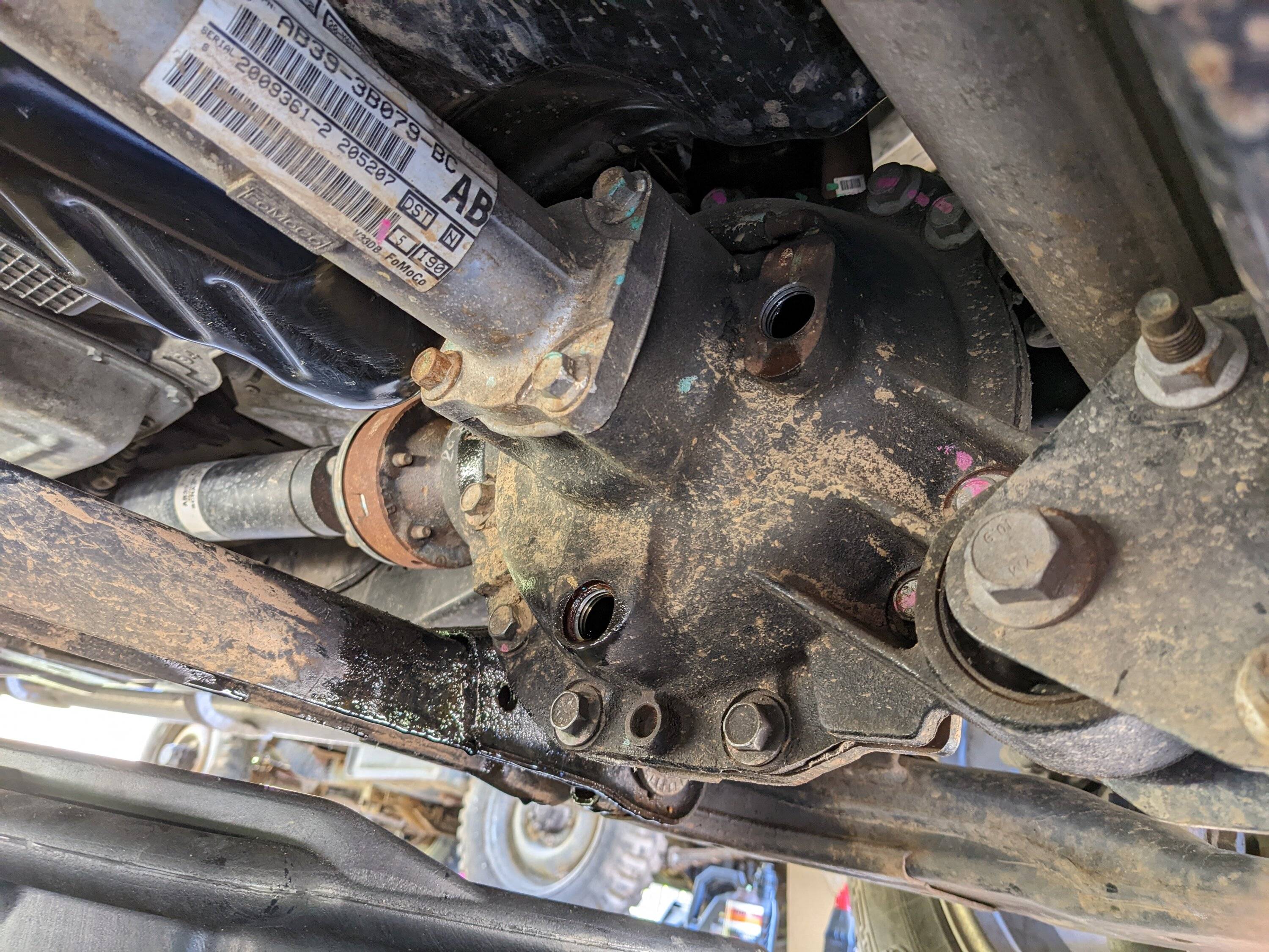

Australian models had a problem with the front transfer case seal leaking, replacements used to leak too, finally Ford released a revised design seal but to replace that you had to replace the whole flange. Interestingly in line with the whole alloy knuckle / steel knuckle thing, my front diff looks identical to yours, but the casing is cast iron, not alloy. I'm changing the oil later today and I'll take a pic.

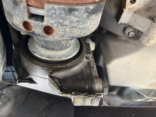

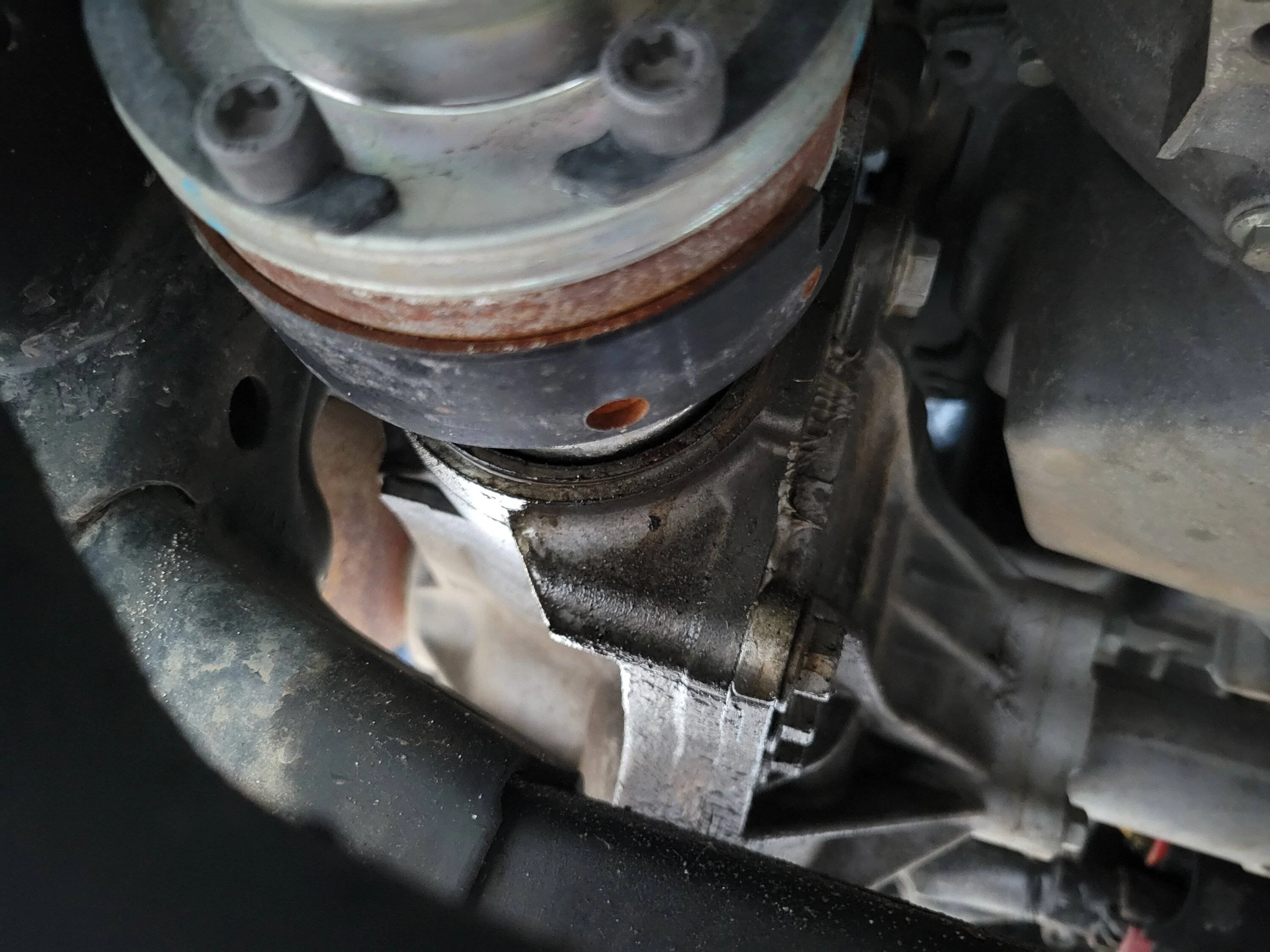

Well, I guess this will be the first major issue I've had with my Ranger. I peaked under my truck today after noticing some Oil drips on the pavement and it appears
that the front diff. has sprung a leak. From what I can see, it seems like the seal between the half shaft and front diff. is where the oil is coming from. Take a look at the pictures and let me know what you think. I called the dealer and the earliest I can get in is December (the truck is under warranty, currently at 35,000 miles).
Here's what the cast iron clamshell looks like on a global, I did an oil change yesterday. The other mess isn't a leak, I did an oil change on the engine as well and the filter dumps oil everywhere when unscrewed.

Here's what the cast iron clamshel looks like on a global, I did an oil change yesterday. The other mess isn't a leak, I did an oil change on the engine as well and the filter dumps oil everywhere when unscrewed.

Hey, mine had the same oil leak at about 15000 mi. It turned out to be a cracked valve cover. My leak dripped down the back of the engine from the valve cover.
Interesting.... I've been trying to solve my oil smell problem for a year and look what I've just found...same exact issue as OP...need to check again and verify what kind of fluid it is...

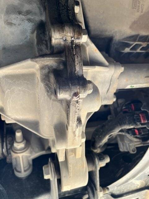

I checked to make sure engine oil wasn't leaking from the oil filter or drain plug and both were dry. I too had the same concern about running out of oil in the front diff and possibly causing damage. I opened a case with Ford corporate explaining that the shops were backed up and that I didn't want to be held liable for any damage.
Any word from Ford? I have the exact same problem. Dealer cant get to until Dec 16. Keep in mind, if the seal is bad, it too, is on backorder. I'm going to order one now in hopes that it comes in before I can bring the truck in....

Both the dealer and ford corporate didn't seem to care that this could possibly destroy the front differential. I thought about trying to order the seal as well... BTW this may sound creepy but I know where you live. You're the only other guy in my area with a black tremor lol. I built a house just a few miles down the road from you.

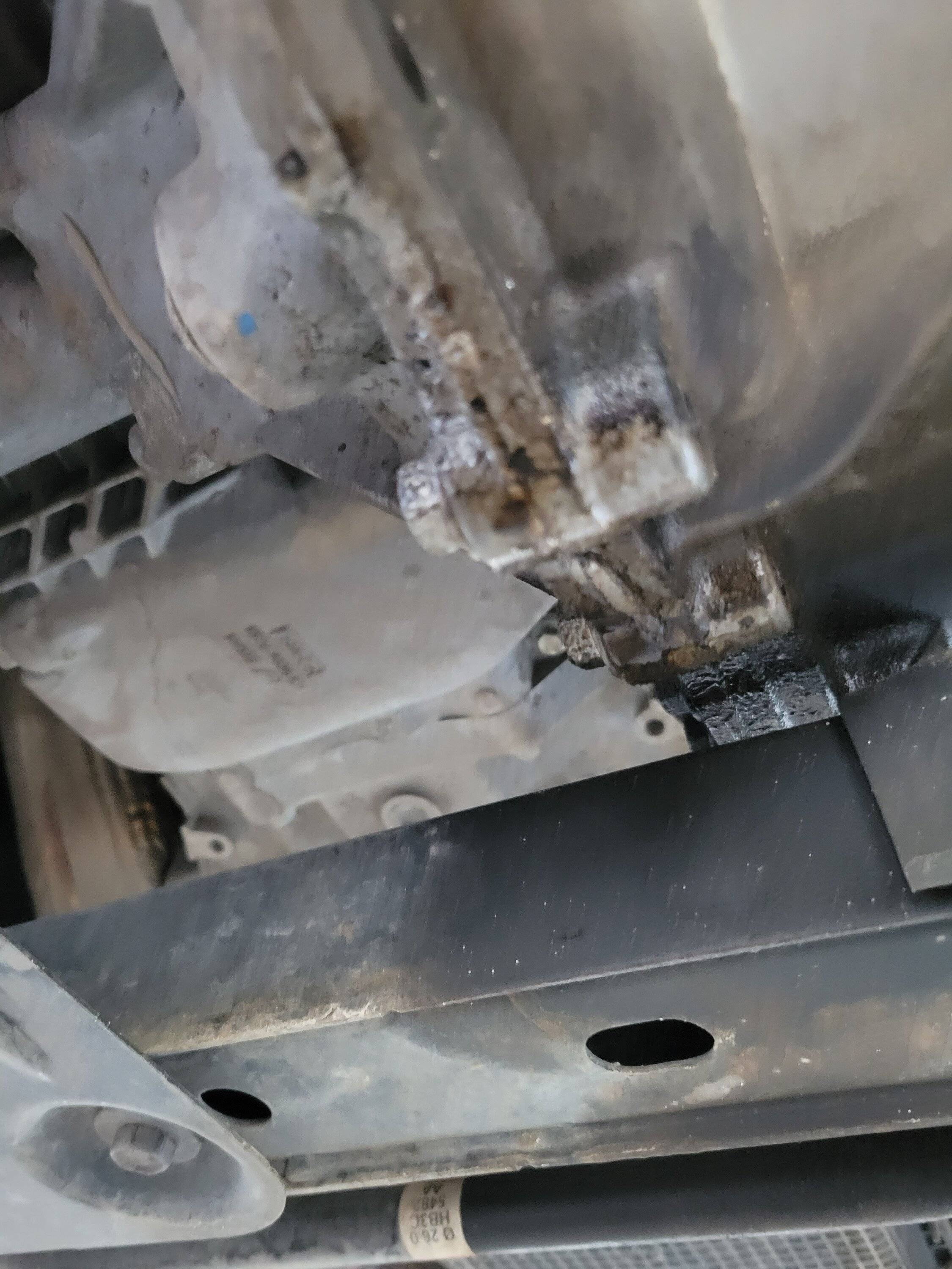

Just noticed some small drip marks under my 2020 several days ago. Looked underneath and it's in the same area as everyone else's. Oil on the frame by the back edge of the driver front tire and also felt that drain tube/channel and it's got oil in there as well. Last oil change was June/July so it's not like they didn't get the filter on tight or didn't seal properly, that would have shown up before now, right?
Checked oil and it's a little above the full line on dipstick. Was going to take it in for an oil change right after Thanksgiving, now looks like I'll have to make an appointment to get it looked at.

You might want to look again to pinpoint were exactly the oil is coming from. The oil channel coming from the filter was dry on my truck. The only oil drip I was able to find was right at the bottom of the front differential casting... and the oil itself was clearly gear oil rather than motor oil.

I took my truck into the dealer this week hoping that they would top off the differential oil and I was turned away with the explanation being that it was "very difficult to just top it off." The service rep clearly had zero mechanical experience and at that moment I realized that I was wasting my time.
I picked up a bottle of gear lube and it turns out that the front diff was roughly 1/2 way empty. I'm glad I topped it off because I've had to use 4WD on icy roads for the last couple days...
With the step bar hanging down, I was limited how far underneath the truck I could go. If I get time over Thanksgiving I might jack it up for a better look. It's definitely engine oil, that much I know.

Update: The dealer finally had a chance to look at the front diff leak. As expected, the pinion seal and flange has failed and they don't have the parts to fix it. The service rep. claims they can't even order the part as it's "unavailable," so they will have to reach out to Ford corp. to figure out a solution.

Update: My truck was fixed on Jan 6th. They replaced the "Rear seal" on the front differential and that seems to have fixed the issue. Still not sure why the first one failed but hopefully this seal lasts a little longer!
