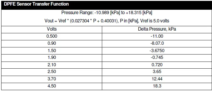

Ok, time to reset and reevaluate the readings:
What I find odd is this:
and then look at your readings:
I took off the hoses at the DPFE an ran live data with Key on engine off and it read -3.65 PSI, basicsally the same. I hooked up the OEM FoMoCo DPFE sensor. It read -0.38 to -0.43 PSI
I hooked up a third DPFE sensor and it read -3.63 PSI. All of these readings are with no hoses on. I checked each one twice. This is PID:
"Differential Pressure Feedback EGR(Exhaust Gas Recirculation)
Sensor - Raw" I will reverse the hoses and try that tomorrow
So, the Ford DPFE appears to be producing a (PSI) reading and the other 2 are producing a (KPA) Reading.

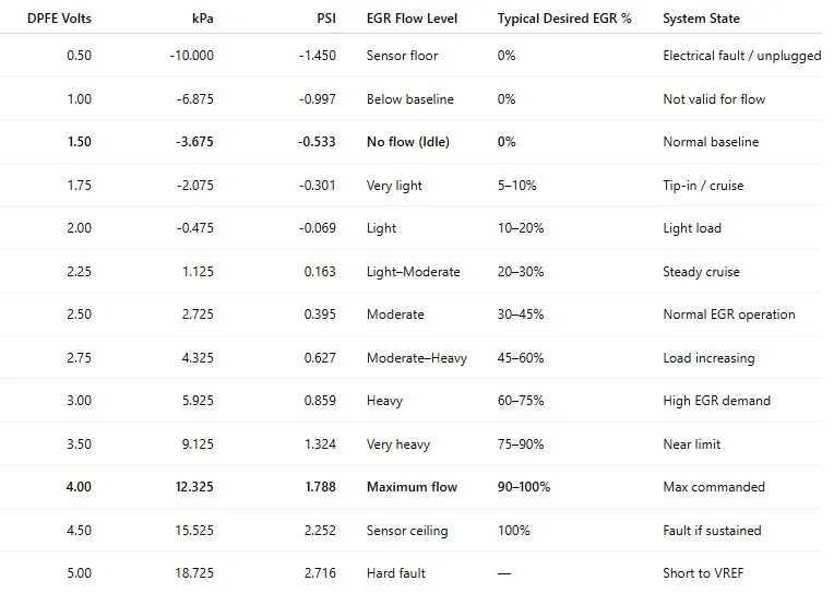

The important PID that you are not seeing is the (Voltage) PID, this is what the PCM is actually looking at to determine what the (DPFE) PSI or KPA is and converts it.
We know that 1.5 Volts = 0 or close to 0 (-0.07) or (-0.09) PSI reading from the Scan Tool PID.
So, in Reality per True Math and the chart above -3.675 (KPA) = -0.533 (PSI)
So, it makes it confusing when looking at the PIDS - especially when you have a missing PID (Voltage)
The scan tool will display the (PSI) reading in a simplified form in a scaled value of the True Math.
So, for (VIEWABLE) information only the pressure reading will show (In PSI or KPA) is appears the PSI is more simplifed as even with my Snap-On I show 0.0 PSI and my others Autel & TopDon will display -0.09 PSI at 1.5 volts.
So that brings us to - being confused on the different readings (I will accept) that yes, I did not catch this until now (Confused)
So, the bottom line is and what made me look closer at this - is the 3 readings you are getting from the sensors - something did not look right.
So, let's start with the Ford Sensor - Reading -0.38 to -0.43 PSI
Note that this is closer to (True Math) conversion of -0.53 PSI from a 1.5 Volt Scale
slightly under (noted)
I see on my scan tool a - altered reading of -0.09 PSI for the same 1.5 volts
The Scan Tool (Difference) shows here and how it is displayed, so the question is.
If you were to plug in a (NEW) Ford sensor, would it move up closer to (True Math) -0.53 PSI - Sensor Skewed, or are we seeing a slightly altered (Display) of the actual -0.53 PSI
Now for the sensor readings - I think the tool is giving you a PSI reading for the Ford Sensor and its giving you a KPA Reading for the other 2 - Why? IDK
If we back up to your post #7 - you stated a 3.67 PSI reading - I think this is actually 3.67 KPA and is normal. I think the scan tool is displaying the pressure as KPA but might have it labeled as Pressure or PSI (Confusing)
So, if we focus on the other 2 DPFEs and only look at the values you posted.
3.67 KPA - Normal (True Math) Reading of 1.5 Volts
-3.7 - -3.4 - While Driving
-3.63 & -3.65 - KOEO Readings
The While driving pressure might be what I see on my tool (slight pressure) change with EGR Closed (Exhaust Pulses) and (Intake Manifold) Pressure changes (-0.2 to +0.1) PSI, but it does appear to be just (SLIGHTLY) under the -3.67 of a 1.5 Volt baseline.
Since we know that -3.67 equals 1.5 Volts, we can see that at least by True Math these numbers are just (SLIGHTLY) under.
Is this the scan tool (produced) display PID or is this REAL Pressure? is the defining question.
If this is REAL - then all the sensors are shewed lower than what is the expedited pressure should be at 1.5 Volts.
Remember - The PCM is not looking at the Pressure, it is looking at the Voltage (Only) to determine what the pressure is - and the displayed pressure (PID) is just a display parameter,
I would have to double check - but I believe even my scan tools (if I were to change) the display to KPA it would show (0) as it is only deriving the pressure from the voltage reading and the tool itself is changing the way the PID is actually displayed. (Confusing the User) until you realize that the tool itself is converting the pressure to show (1.5 Volts) for the DPFE sensor equals (0) or very close to it and it displays it as such be it PSI or KPA.
This is where I got tripped up and stated - KOEO should show (0), not thinking about some scan tools may display a different (PID Reading).
So, all 3 sensors appear to be withing normal range but just slightly under spec, but it really depends on the accuracy of your tools display.
We can do some wiring checks on the VREF circuit, more focus on the Signal Return side as this would pull the (Neg) pressure reading lower than normal.
But first: Disconnect the DPFE connector and note what the PID (Pressure) Reading defaults to.
airline tech
Aug 24, 2022
4,499
8,591
Midwest - KS
Aircraft Tech

OK - I also did a REF: Test Today
Mainly for Voltage Checks on the DPFE and what the Scan Tool PIDs Defaulted to with the DPFE & MAPT Connectors Disconnected as I wanted a (TRUE) Test vs Manual (Guideline)
This is only a @ Idle Reference for a (PSI) to (KPA) Compare - Scan Tool
Switched (Display Units)
Below is the PID Readings for (BOTH) PSI & KPA (Normal @ Idle) Real Live Data
DPFE Pressure: -0.06 to -0.07 PSI & -0.39 to -0.51 KPA (Fluctuating)
DPFE Voltage: 1.48 Volts
MAPT Pressure (High) Resolution: 5.05 PSI & 35 KPA
MAPT Pressure: 4.93 PSI & 35 KPA
MAPT Voltage: 0.53 Volts
Same Readings: @ KOEO plus a Barro PID (Ck-Match) for MAP Pressure
DPFE Pressure: -0.06 PSI & -0.39 KPA
Barro: 14.21 PSI & 98 KPA
MAPT Pressure (High) Resolution: 14.32 PSI & 98.75 KPA
MAPT Pressure: 14.21 PSI & 98 KPA
MAPT Voltage: 1.51 Volts
I wanted to see what the PIDs would (DEFAULT) read with the DPFE & MAPT (Disconnected)- KOEO
Reason: Circuit Test (Results) to see if wiring or another sensor is affecting the (PID Display)
DPFE Pressure: 12.67 PSI & 87.35 KPA
DPFE Voltage: 5.0 Volts
MAPT Pressure (High) Resolution: 47.23 PSI & 325.75 KPA
MAPT Pressure: 36.98 PSI & 98 KPA
MAPT Voltage: 5.0 Volts
I also wanted to (Physically) Test the DPFE Circuit with a (Fluke Meter) -Connector Disconnected:
Verifies VREF Voltage is Good & Signal Return is Good
Pin 3 VREF to Pin 2 - Signal Return = 5.0 Volts
Pin 3 VREF to Body Ground = 5.0 Volts
Voltage Drop (Test) for the Signal Return - under 0.020 is Good
Red Lead: Pin 2 Signal Return--- Black Lead: (Neg) Battery Post= 0.014 Volts
A secondary verification the Signal Return is good to the battery.
Test (Signal) Wire for (Voltage)
Pin 2 Signal Return to Pin 1 Signal -= 0 Volts
You are testing if the signal wire is (Touching) Voltage - shewing the PID Display Reading when the connector is connected.
Note: To see the actual reading that the Scan Tool is Displaying - Comes from the signal wire and it sends it to the PCM.
So, without a scan tool - to view this voltage (1.5 Volts) you reconnect the connector and back-probe. Red Lead - Signal (Pin 1) and Black Lead - Signal Return (Pin 2)

OK, I did some digging and found this: ,
Again, it's the way your Scan Tool is displaying the data, that makes it confusing and it is using TRUE RAW Data vs many other High-End scan tools that simplify the pressure reading to see it jump from (-Press - No Flow) to (+Press - Flow) - This is done within the tool and takes away the exact readings you are getting from your tool --Is it a GOOD READING? 🤷‍♂️🤷‍♂️
All ford documents that I found - only have the basic chart I posted earlier and took some time to get this chart - exactly how I wanted to see it (A tighter window - range)
So, with this chart = you can actually use your readings (Live) and compare to the chart for a better visual reference.
Your (In Drive) Load Test
The desired and actual % went from 0% at idle to 14% @ 2000 rpm.
The Dfpe is -0.25 to-0.30 psi flows up to-0.09 to 0.56 psi at 2000 rpm
By this chart - The Ford DPFE is just slightly (under reporting) and this is the point of where the (Meter) Checks will help diagnose (Sensor) or (VREF Circuit)
If VREF - Proves Good and precise measurements are solid, then that leaves only 2 (possibles)
the Scan Tool is not displaying (True-Raw) or (Sensor is Drifted) and the only way to know is to replace with a new sensor (Ford) and see if the display pressure changes using that scan tool, another Higher End scan tool may display it better, but at least you now have a better chart that matches what you have.
This is where the VREF Checks are important - and if not in exact specs of my findings above:
If the VREF is lower than 5.0 Volts or there is a Higher Resistance (Voltage Drop) test on the Signal Return - It would provide exactly what you have in the PID Reading. It is just slightly under but may be just enough for your Buck / Surge issue.
Notice: Your tool still displayed (-) pressure when the EGR Valve was commanded open (Very Confusing) unless you use the chart below.
All of my scan tools show the pressure go (Positive) the second the EGR Valve Opens - Eliminates Confusion
