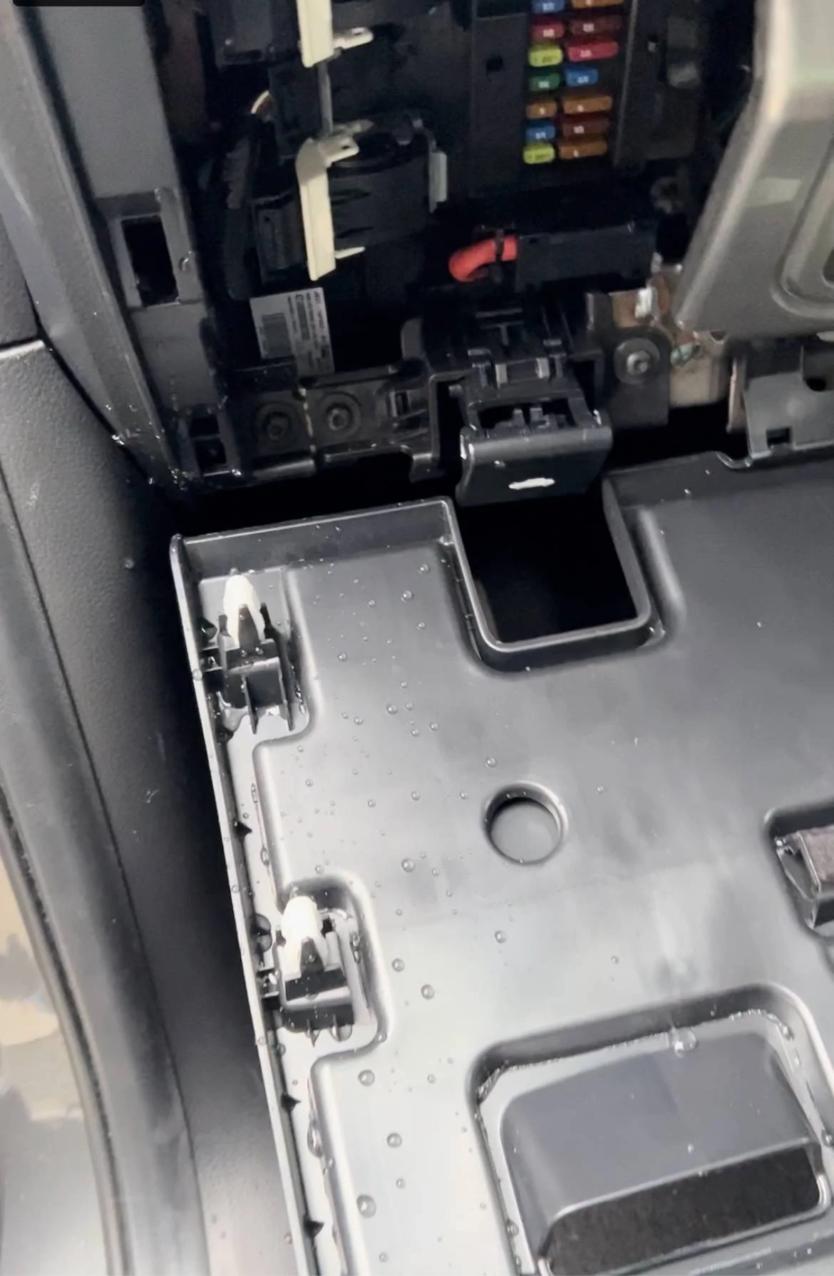

I’m glad I found this post. We got some heavy rain (heavy for Southern California) and Sunday afternoon I noticed a lot of water on the drivers side floor. The strange thing was that it seemed to be coming from the dash and not from the door. A little inspection and I found a good amount of water filling up the fuse panel under the steering wheel.
Finding this post reminds me that a few days after owning the truck, I had condensation on the inside windshield when heading out in early morning. I thought it was weird but may have been related to the dealer detailing the truck before I picked it up.
I traded my ā€˜19 XLT for this ā€˜22 FX4 and so far I’m not 100% happy. I’m missing a couple of the items that ford deleted, been going back and forth with the dealer on a finance issue and now have to worry about water in the cab. I attached a screencap from a video I took for the dealer.

yeah that sounds like the windshield. there is a recall on it for certain rangers. mine leaked on both sides. they replaced the windshield a couple of weeks ago and so far no leaks. other than this issue i am very happy with this truck. of all the vehicles i’ve had in my 45 years of driving i like this one best

Thanks! This gives me hope. ?
I loved my 2019 and was kicking myself for not getting all the features I wanted out of the gate.
As long as the leak is fixed, I’m sure I’ll regain that original love affair.

So you’re all fixed up now?

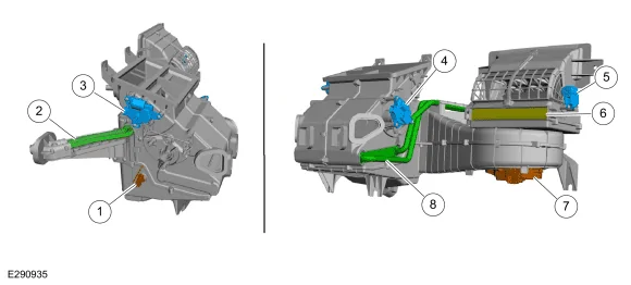

Just to point you in the POSSIBLE right direction, I have noted on this forum that some have had issues with the (Fresh Air Recirculation) door- staying open after truck is shut off, allowing mice to enter the glovebox- I questioned this operation and plan on digging into what that door does after power is removed. (Truck Off) Luckily, it's parked in a garage - so not much of an issue for me.
Note: This door is located behind glovebox
Pull glovebox out - If I remember correctly - press in on the sides and it comes out easily
Use a garden hose and run the water across the lower windshield
Select the Recirculation (ON) this Closes the door. --Check for leaks
Then select the Recirculation (Off) - this Opens the door- Check for leaks
I believe this is your rainwater point of entry, now I think it should drain out of the (AC) condensate drain in the engine compartment- That drain (MAY) be plugged or you have a gasket/seal in that door inlet that is not sealing correctly or missing - I'm leaning towards the seal, as it is a 22, I would find it hard to believe that a 22 would have a clogged drain (this soon) but it's still a possibility
Here is a image:
#5 - Inlet Door Actuator (The actual door is to the left) - Note the open (screen)
#6 - Cabin Air Filter - Possibly soaked (wet) IDK - needs checked
#7 - Blower Motor, I would think that the rainwater is puddling in this and dripping down to the floor around the case seal
This is located right behind glovebox and above passenger feet
See Link Below- It shows Pics of Air Inlet (Recirculation) Door - As Viewed from inside, you see daylight
https://www.ranger5g.com/forum/threads/my-only-complaint.21027/post-457511

Yes all fixed up. I left it out overnight in rain and no leaks! Happy camper
Ok awesome. So you had the "windshield recall" performed and it still leaked. What is the fix for this recall? Windshield resealed?

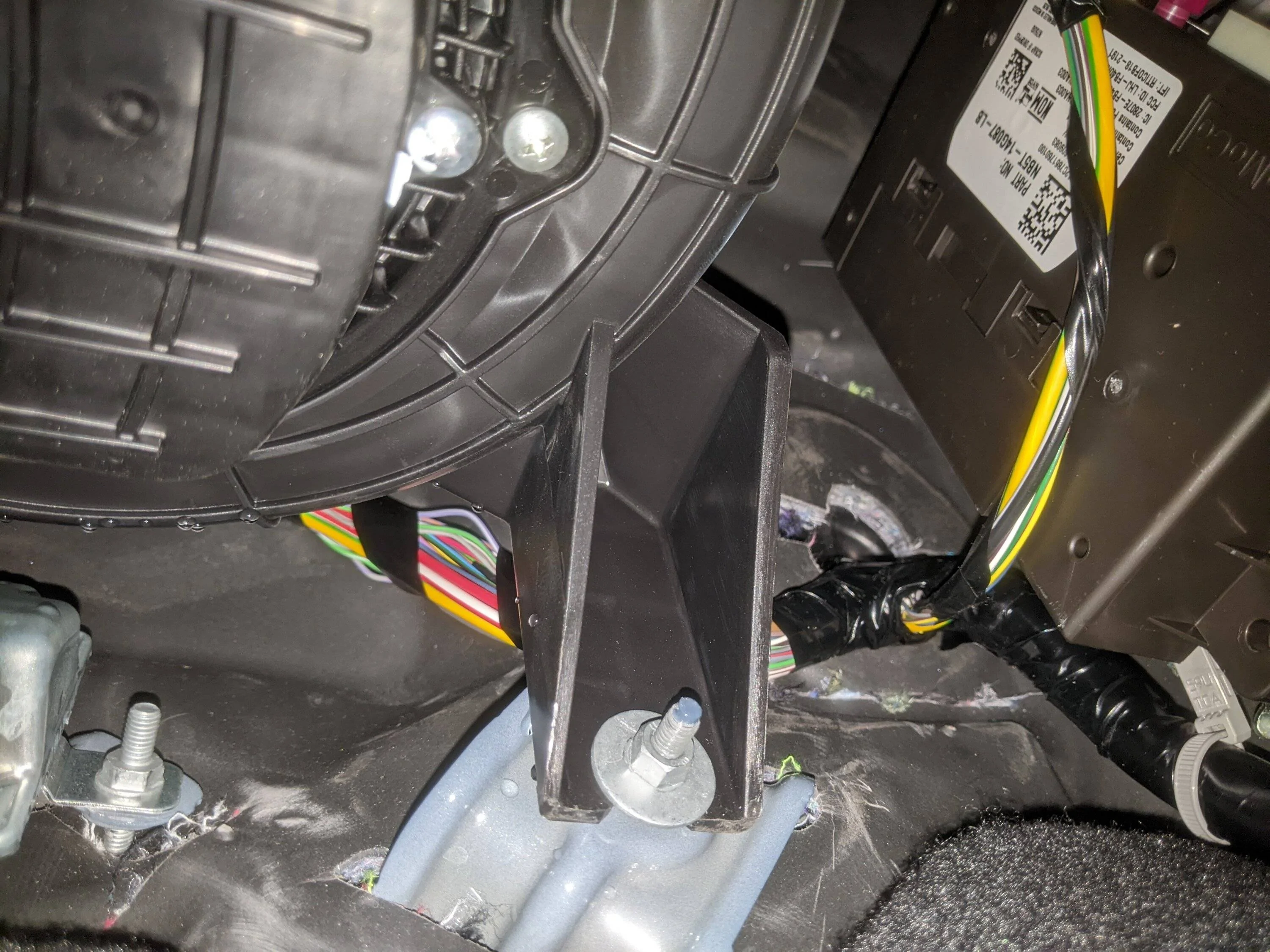

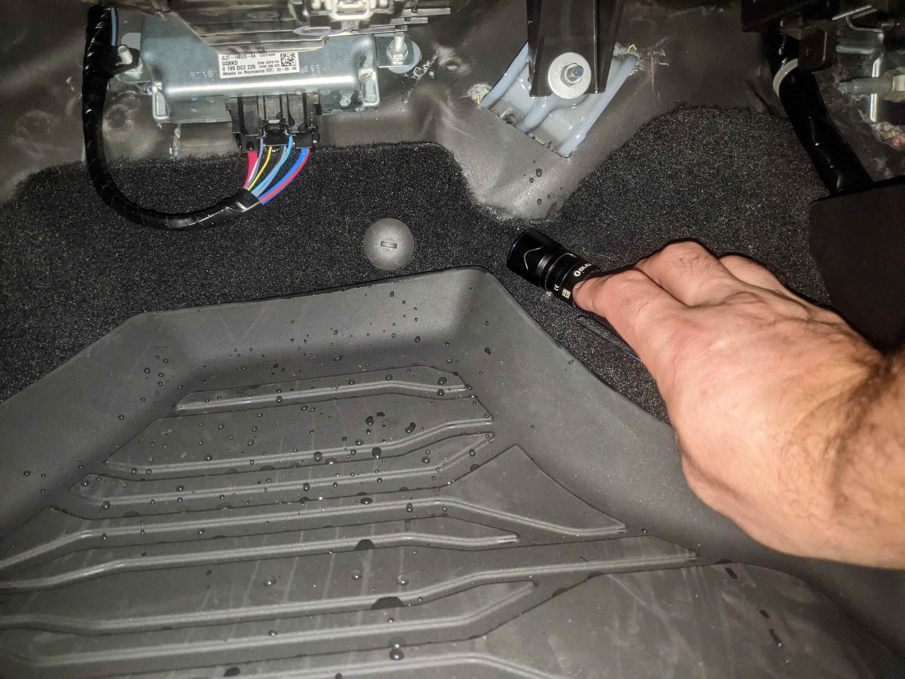

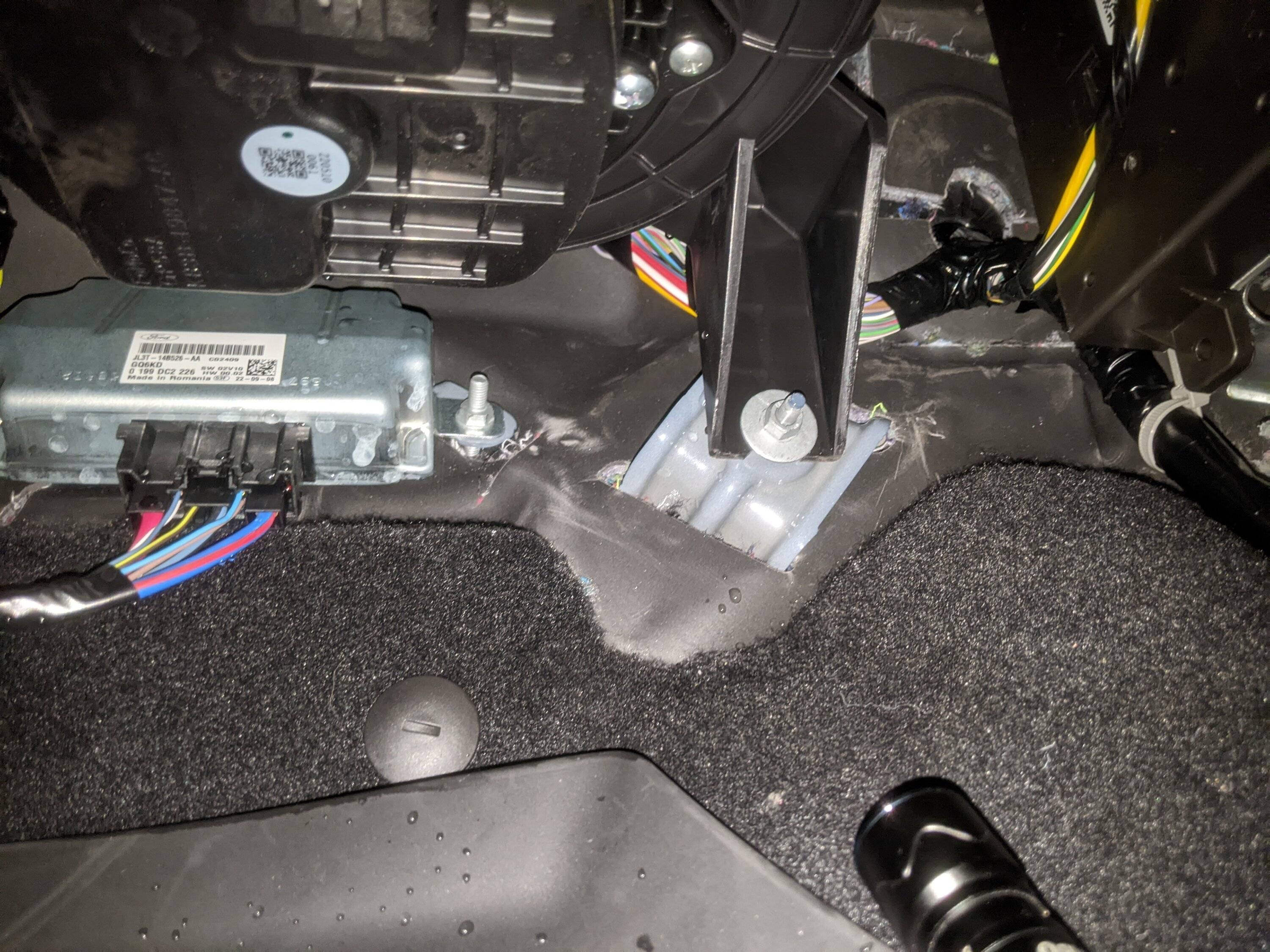

So, I owe you an apology.
I came out after this evenings rain storm and there was a puddle on my passengers side floor mat.
And water droplets up under the dash. On the silver box, on the cables and on the metal. The carpet up by the corner was wet to the touch. :-/
'23 xlt tremor.... <7 days into ownership.
