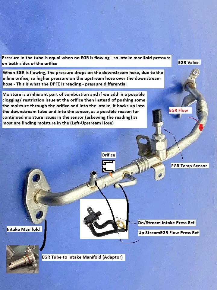

What I believe is happening and why the issue returns, the tube is clogged and the DPFE diaphragm is being held in the max pressure position for so long it damages the diaphragm- and locks it in place - this is why your old sensors (x4) are all reading negative- you installed the new sensor - reads normal at KOEO and off off spec at idle - eventually it going to do the same as the previous sensors , if I am correct and you actually had a good reading at first - it’s a clogged tube that is producing your issues.

This is a - NORMAL - EGR Event and if you would have added the EGRT to the list, you would also have seen the EGRT - Temperature climb along with EGR Flow and when EGR Valve closed the temp would drop back down.
Since you (frame by frame) reviewed - you noted that the EGR Event is actually very quick (Only a few seconds) Open to Close.
Let's use this as an example of what happens - failed DPFE or under reporting DPFE
Failed DPFE Example Only
Using EGR Command & Actual - 10%
DPFE - would be under reporting (say still showing negative) or a lower Differential Pressure
Map - is still showing - 13.6 psi
PCM - expects the DPFE to be a (More Positive) reading than what it is reporting
PCM - Responds by - Commanding the EGR Valve to open farther
DPFE - Reports a slightly higher pressure - but still does not match (what the PCM wants to see)
DPFE - Reports a pressure of some positive flow - PCM finally is happy and EGR event ends
So, as you can see and note - The MAP pressure will increase each time the EGR Valve opens farther - chocking the engine or (over diluting) it with EGR Gas for your current engine and vehicle speed.
The EGR flow is still there - it's just overloading the intake with un-needed EGR flow, so what should be 10% EGR - turns out to be 70% EGR.
This would be a visual on how the DPFE fails and also how moisture can plug the Ref port and skew the pressure readings.
