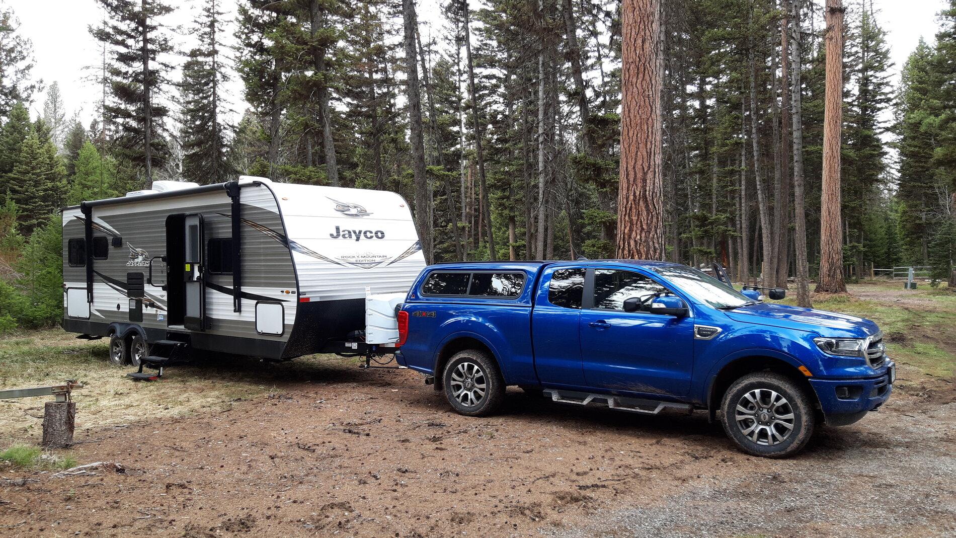

Last year we did about 6,000 miles towing our 24ft (29 LOA) Jayco at about 6,000 lbs dry with my 2019 Lariat SuperCab with the Ford/Redarc controller and an Equalizer E2 WDH rated for 8,000. I don't raise the tire pressure on the stock Hancooks as they don't appear to be distorted at all under the load, but I do adjust the headlights down in the summer. We average 60 mph on the highway and never exceed 65, where handling starts to feel less confident. (The mileage/range goes to hell at speeds over 60)
Handling has been adequate. It's not a relaxing highway drive by any stretch of the imagination as you always have to be on alert for crosswinds and passing trucks. But that's the case for towing any travel trailer with anything less than a big rig. The Ranger has more than enough power; we're easily able to pass the big rigs going up the steep passes we have around here at any altitude. The transmission in tow mode works extremely well, automatically downshifting whenever you touch the brakes, although I do use sport mode when going down the steeper highway passes to keep the speed down around 55 and for lighter use of the brakes. You do notice the lack of compression braking with the small engine and it does make some noise as you go downhill at 55 in 3rd gear nearing the redline on the tach. The Ford/Redarc controller works perfectly, as expected. I've had only two occasions where an unexpected sway initiated, but I believe that the automatic sway control on the Ranger corrected it before I had a chance to do anything about it. After the first month/500 miles, I got pretty comfortable with it. Higher crosswinds just means we go slower.
I have been considering a Hensley-type anti-sway hitch. They are rather expensive and add more weight at the tongue. But being more relaxed driving long trips across the plains might be worth it.
