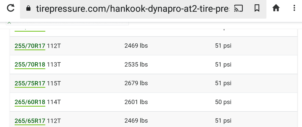

Over inflate was a poor choice of words on my part. I should have stated, much higher inflation than recommended, which will decrease tire contact patch adversely affecting controllability. Apparently you feel that's not the case so we'll just have to agree to disagree on that point.
80 p.s.i. sounds ridiculous!
From Hankook webpage, the last two sizes are for Ranger 17&18 wheels, last column is MAX pressure:
The center of the tire will become bald quick, not to mention spinning out on cornering, unless you are doing doughnuts and drifting!
Info from Firestone on dangers of overinflation:
Firestone on Over Inflation

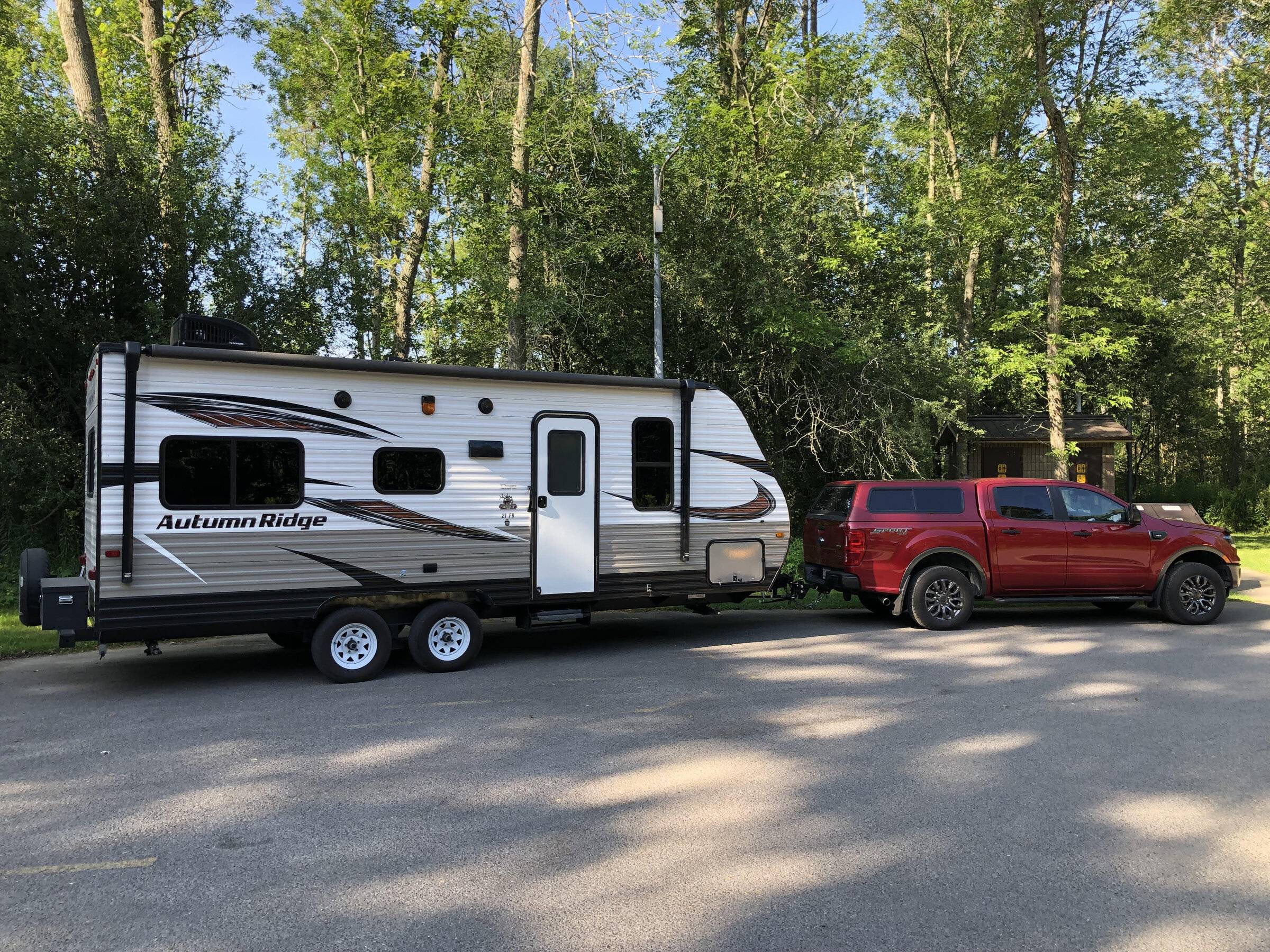

I run my Bridgestone Duelers up at 40 PSI cold for towing. Road handling has improved a lot.
Trailer is 21 ft long, wet at 6500 lbs and WDH is Husky with friction sway and 600-800 lb bars.
My next change is moving away from OEM shocks.
I've pulled my trailer about 6000 miles this year and no issues other than the peanut sized gas tank.
