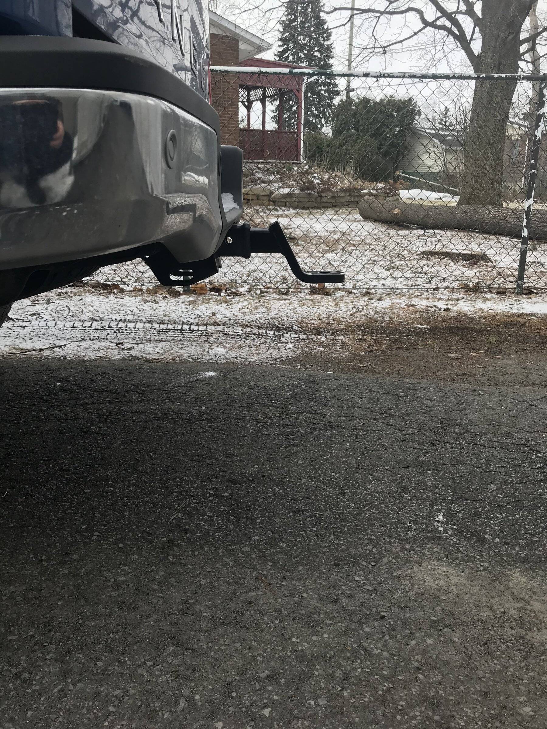

just took a pic, looks good to me..

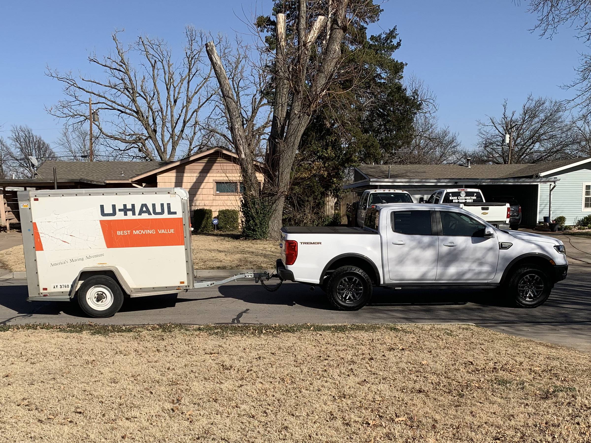

Looks like you got your answer, but I will add that I think you will be just fine. I recently towed the same trailer over 300 miles with my Tremor. The U-Haul location that inspected my trailer setup suggested the 2 inch drop hitch. Frankly I think it was not enough for the Tremor, but your truck should be one inch lower than the Tremor.
For reference, here is how the truck looked with the trailer loaded. I will probably buy a 4" drop hitch for future towing needs.

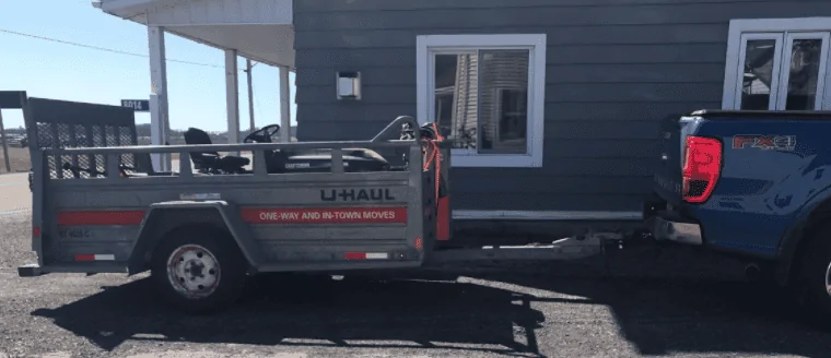

So, all good, a 2" would have been too high, I'm glad I went with 4".
I'll post a pic later.
Also, got a open trailer. Did 16mpg. With 87, oups.....
