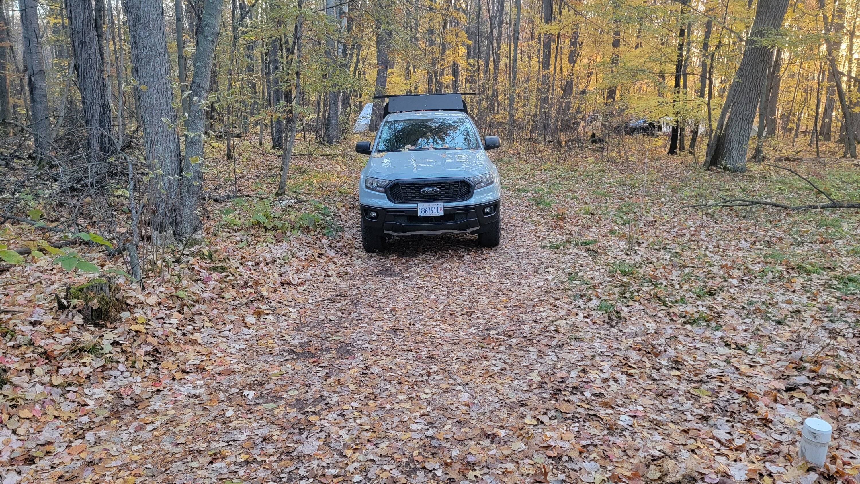

Would love to see a pic of the truck with this from a bit further back if you have one. Just want to see how subtle it is. Great work on this! Been interested in this for a while and not seeing anything as decent as this on the market!
