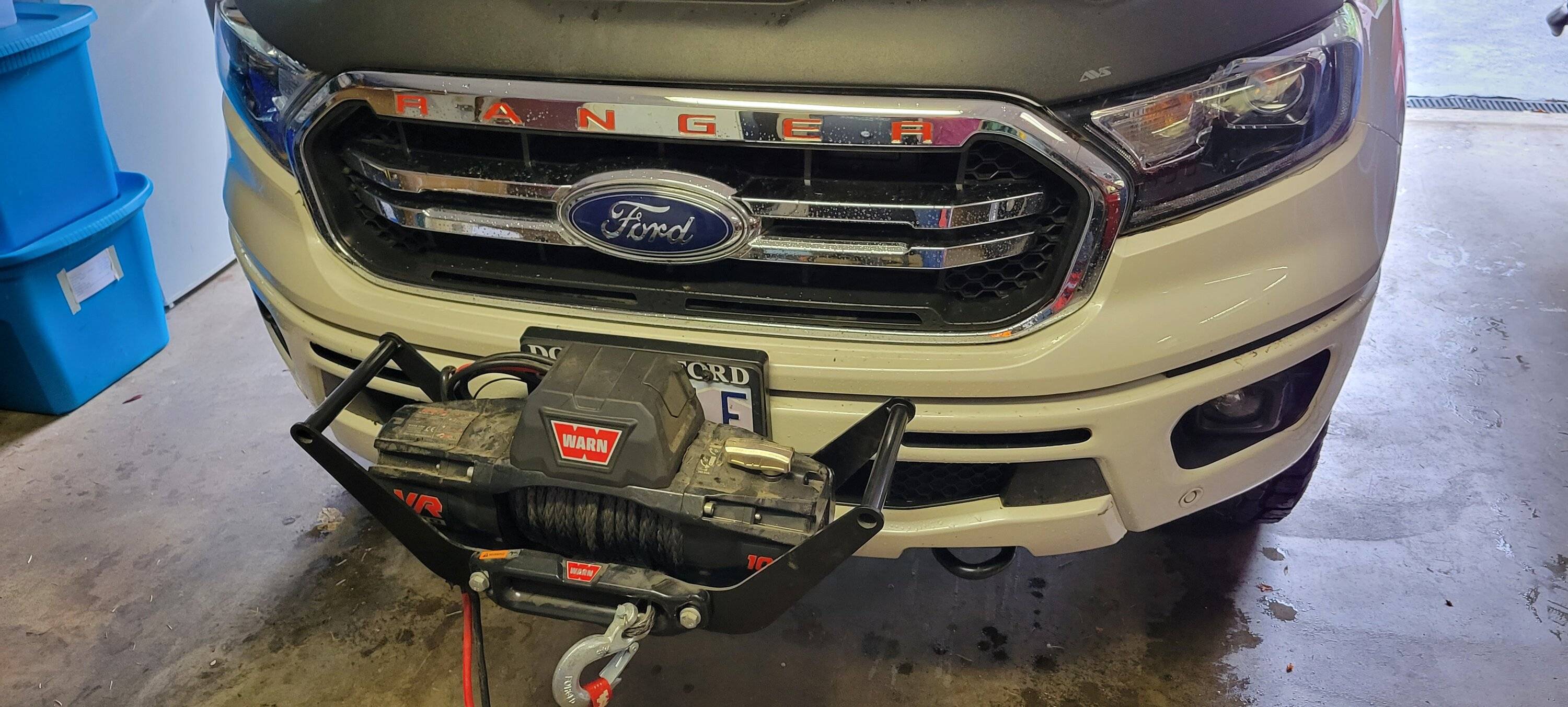

Just got mine mounted and loving it!
I don't know why, but I expect water to squirt out of that thing. Like it's got a mouth and creating a fountain.

Looks great!

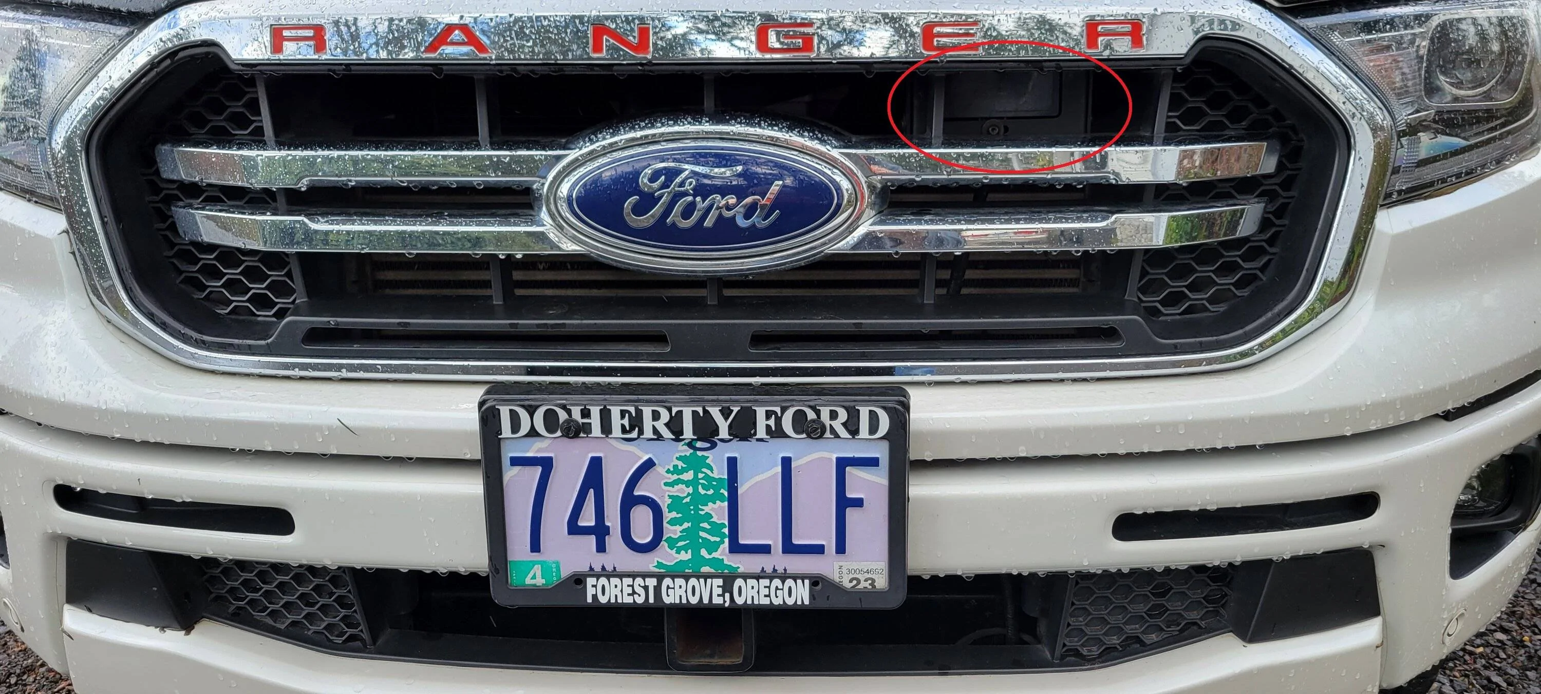

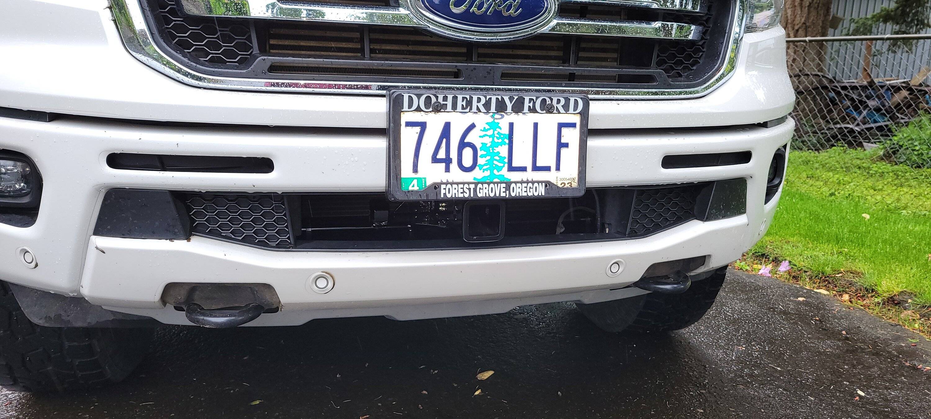

Heres the current offset hitch design, fresh from powdercoating today.
soooo....what does one of these bad boys cost? and how much disassembly does it require to mount it up? does sem like it'd make moving my boat into a tight storage unit a bit easier than the frequent getting-out-and-checking-100-times that I'm doing currently ;-).

I've got the install down to about 15 minutes. First timers usually have it done around 30min. Remove the skid plate and tow hooks using 15mm socket. Trim a piece of plastic and slip the hitch up behind the bumper using the same hardware as the tow hooks. Reinstall everything and you're done.
I'll send you a message on price.
