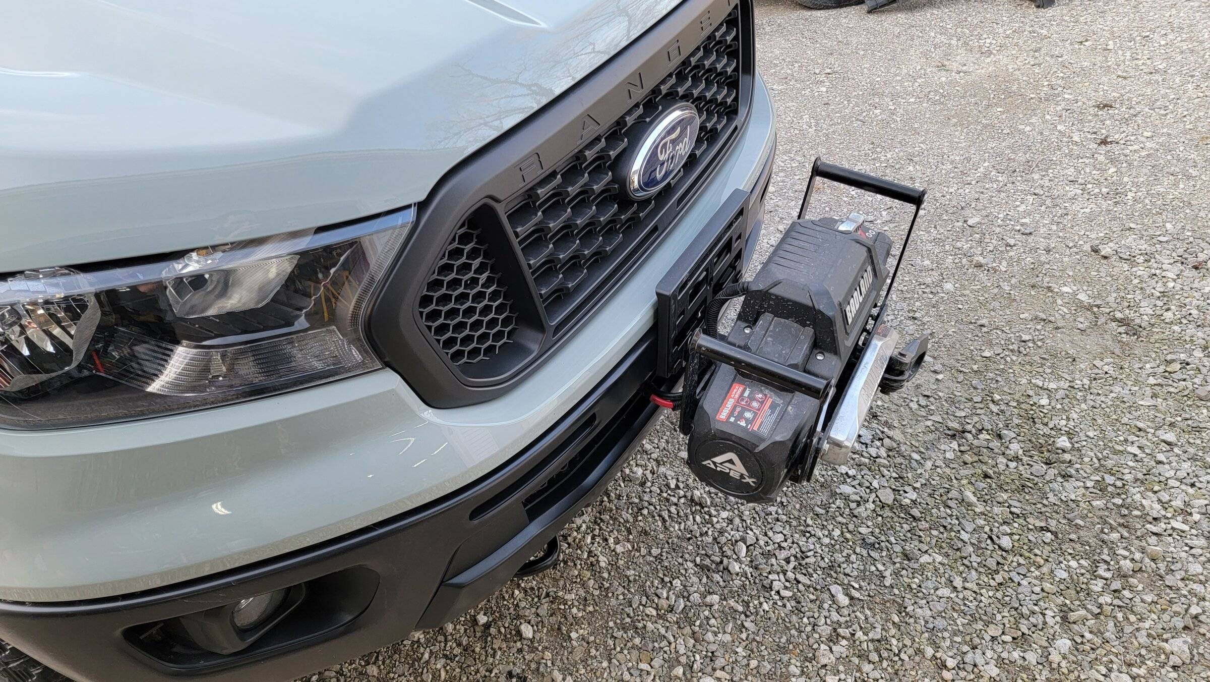

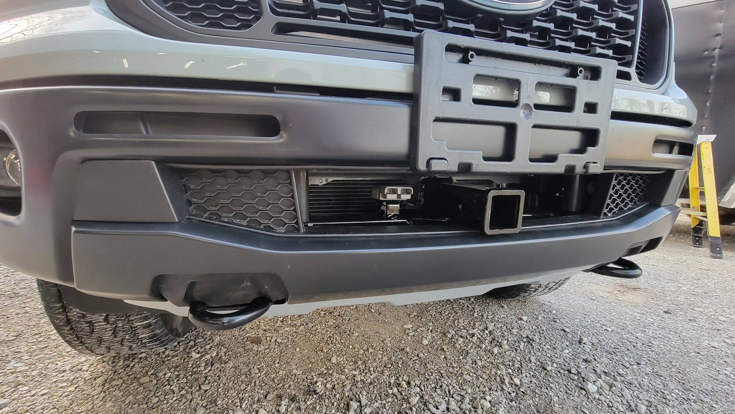

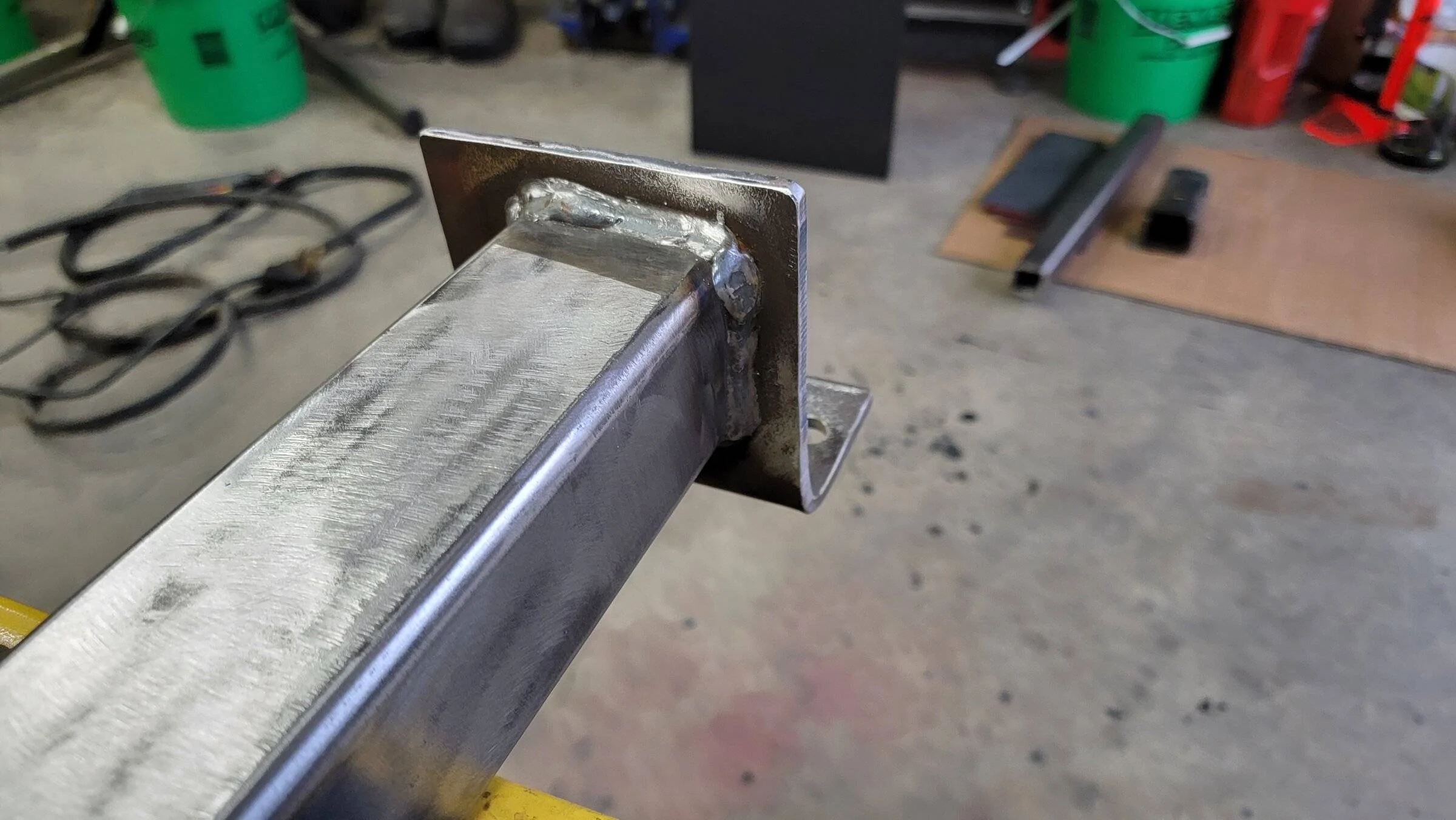

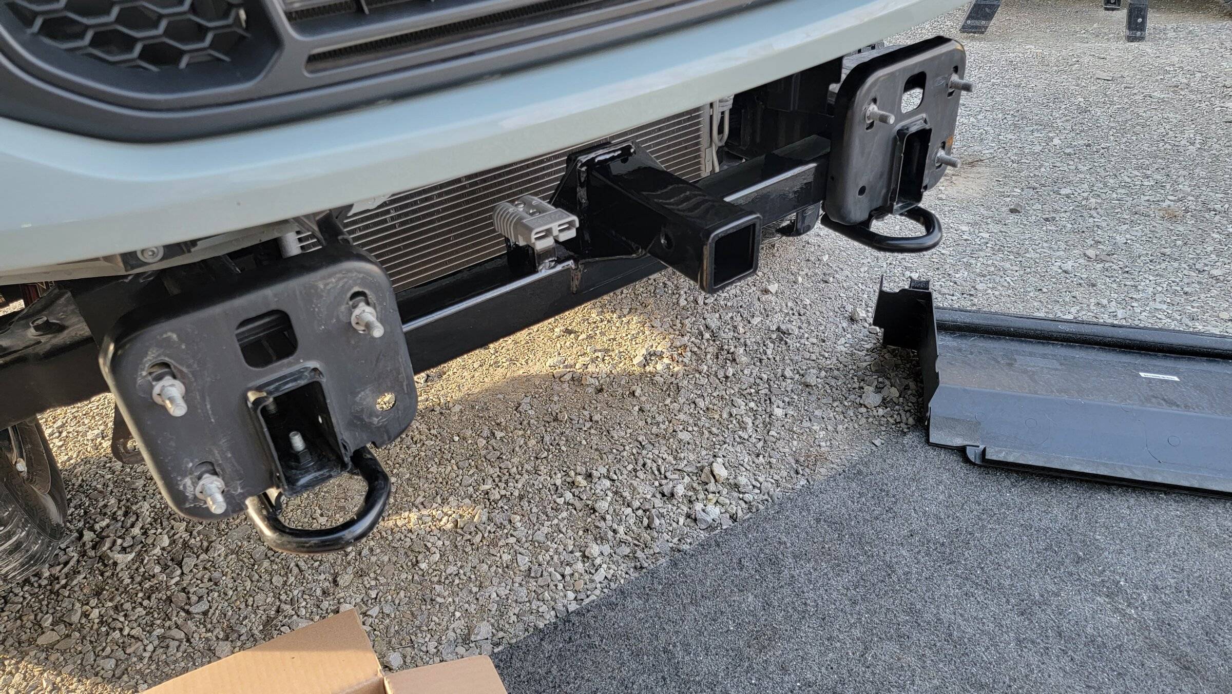

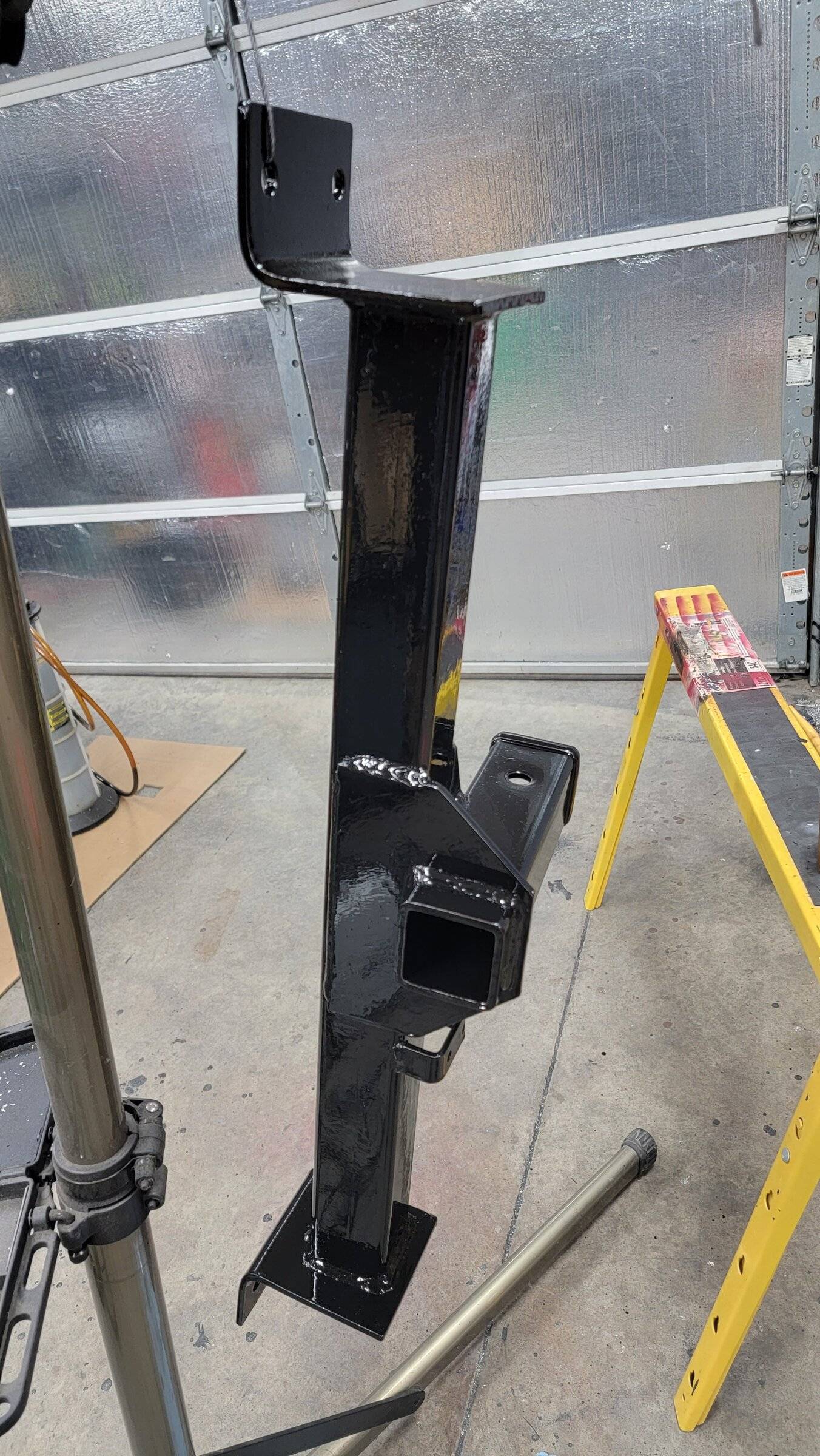

Hope you all find this useful. Let me start off by saying that I didn't like the existing front hitch options that are on the market because it keeps the winch too low and will mess with approach angle. So, I decided to make my own that would fit within the bumper, giving the truck an OEM appearance. Although this is right where the adaptive cruise radar module is located, I purchased this truck without adaptive cruise with this hitch in mind.

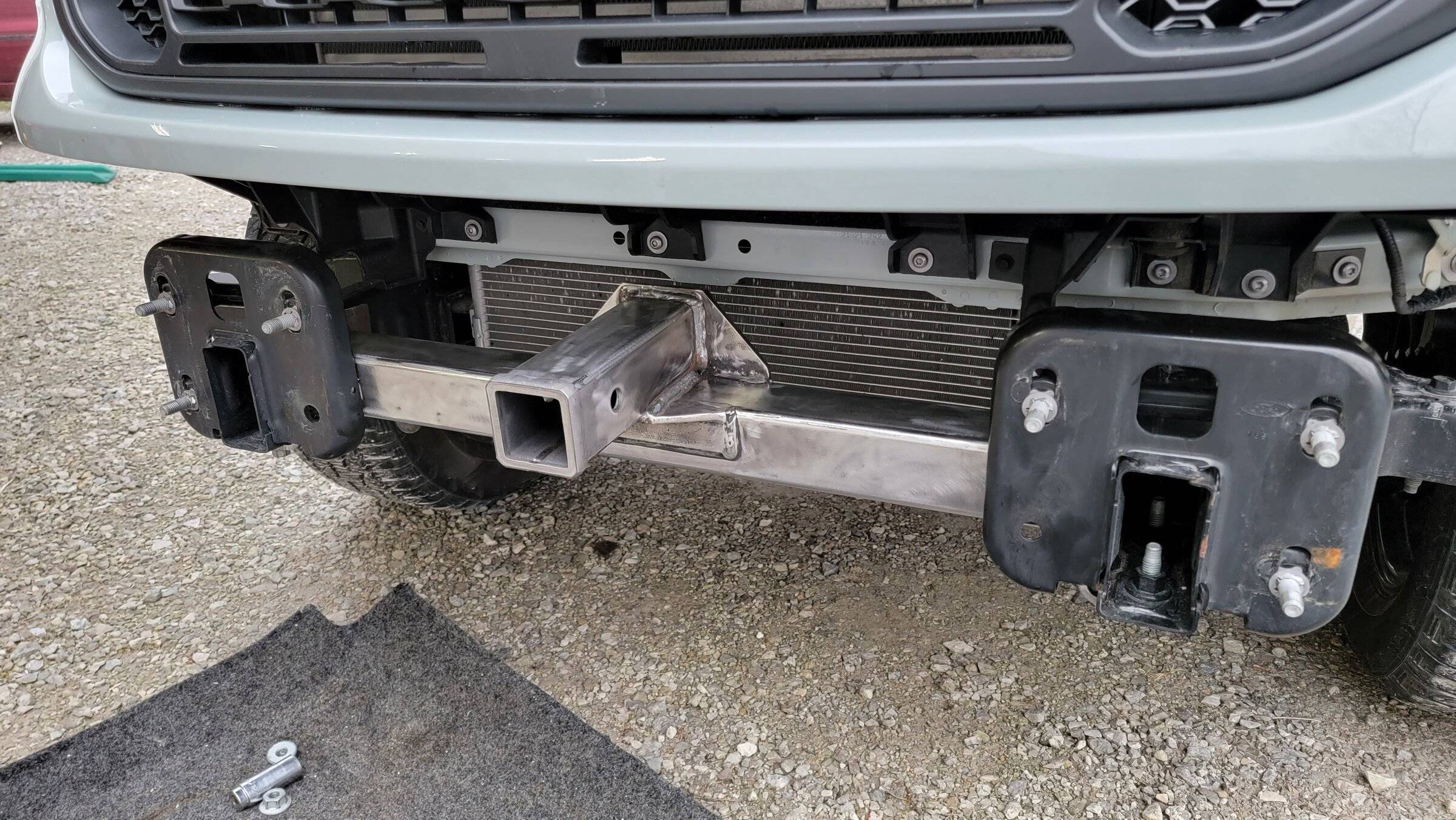

Remove the bumper, trim, skid plate, tow hooks and air diverter that rests behind the bumper.

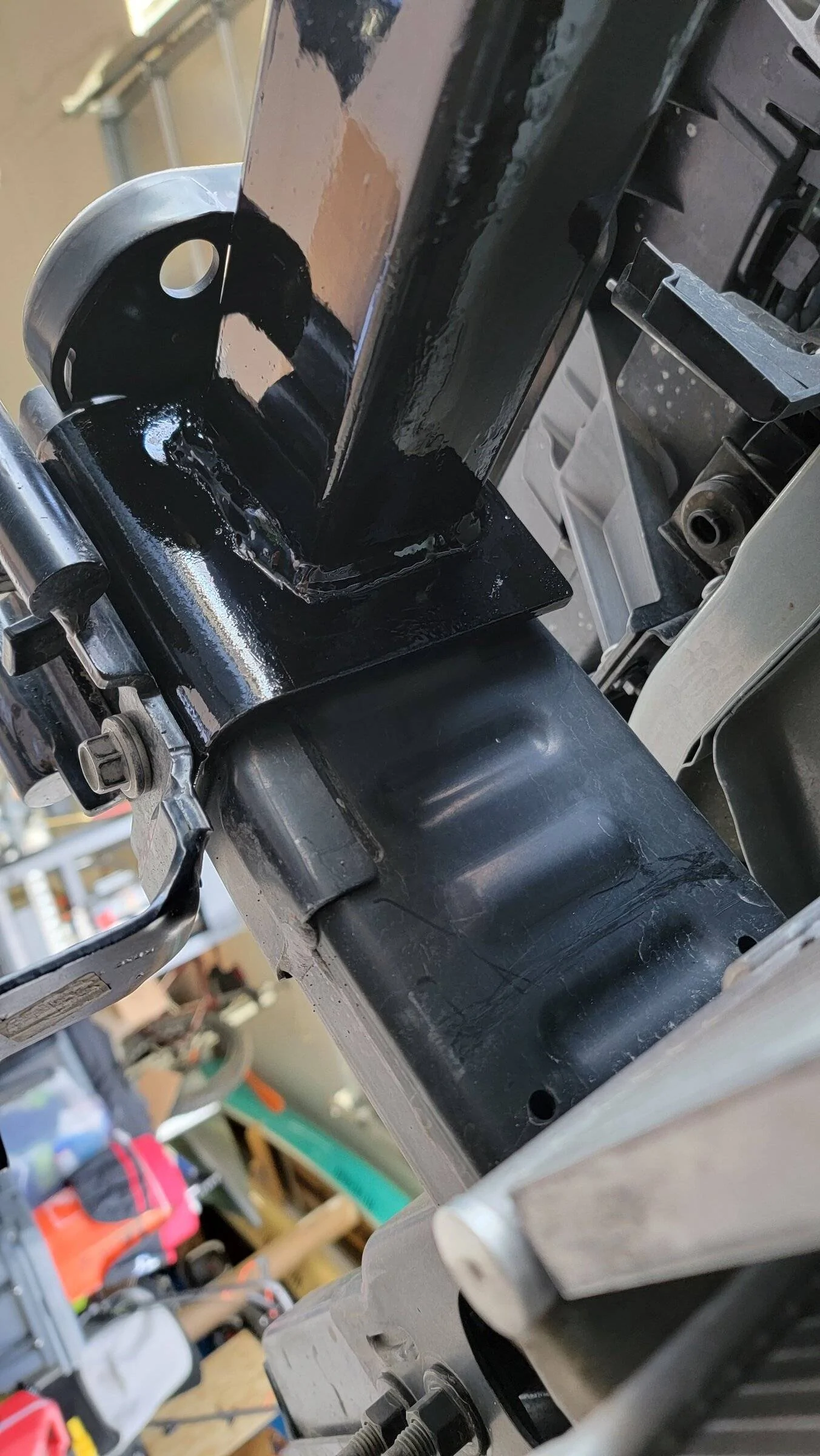

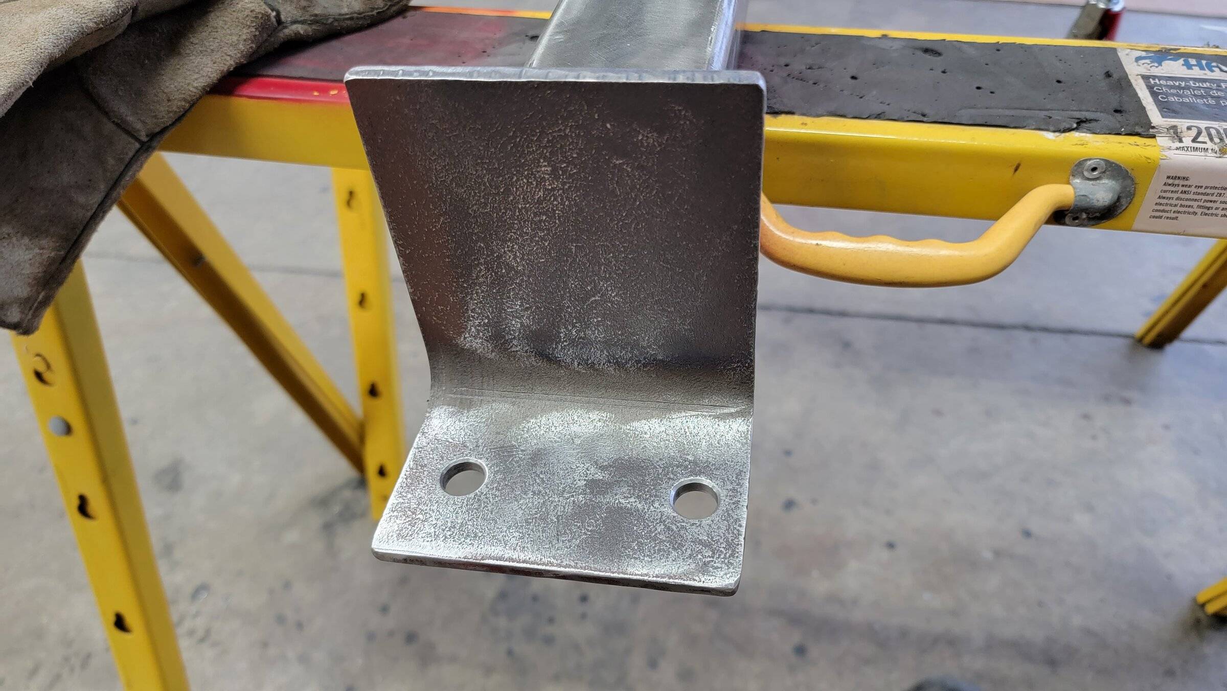

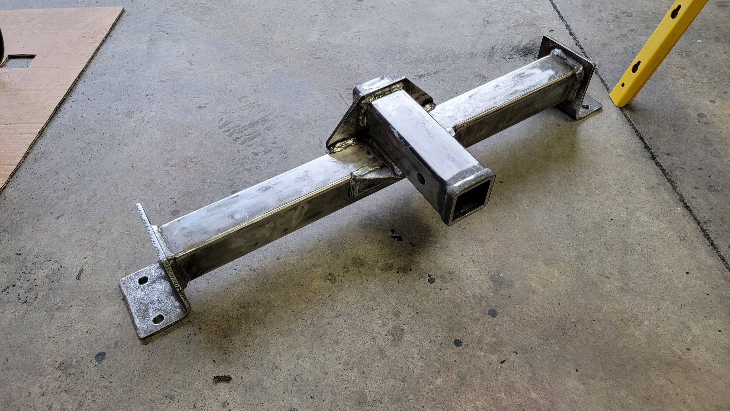

Make all the details and weld the hitch up.
Cut the air diverter an inch past where it starts to bend down to make room for the hitch.
Put everything back on using the existing hardware.
Enjoy!
Would love to see a pic of the truck with this from a bit further back if you have one. Just want to see how subtle it is. Great work on this! Been interested in this for a while and not seeing anything as decent as this on the market!
