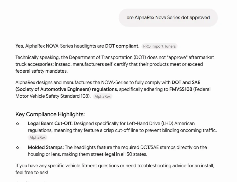

The more plug n' play the better although I've read some heated debate on which are legally DOT and which are reliable. Or maybe just buy replacement OEM.

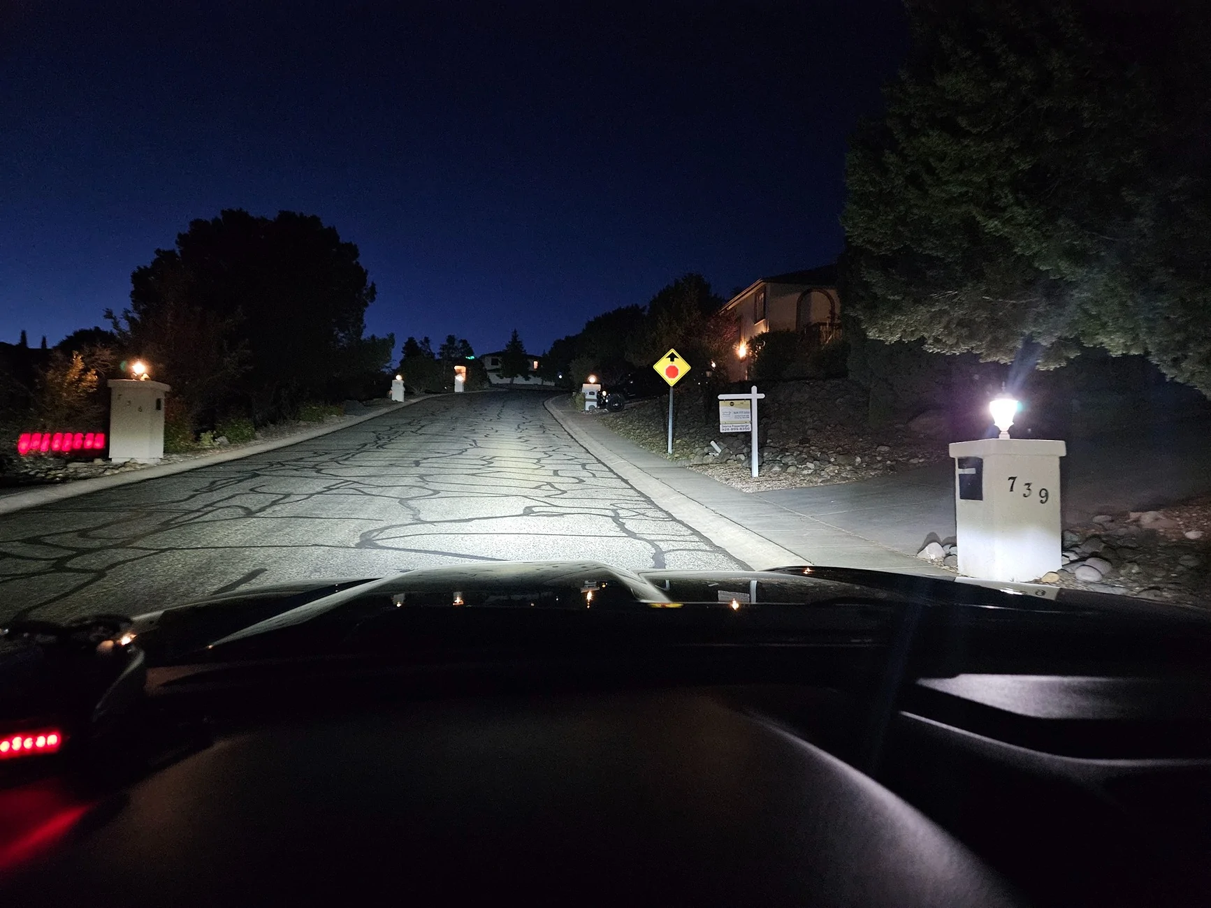

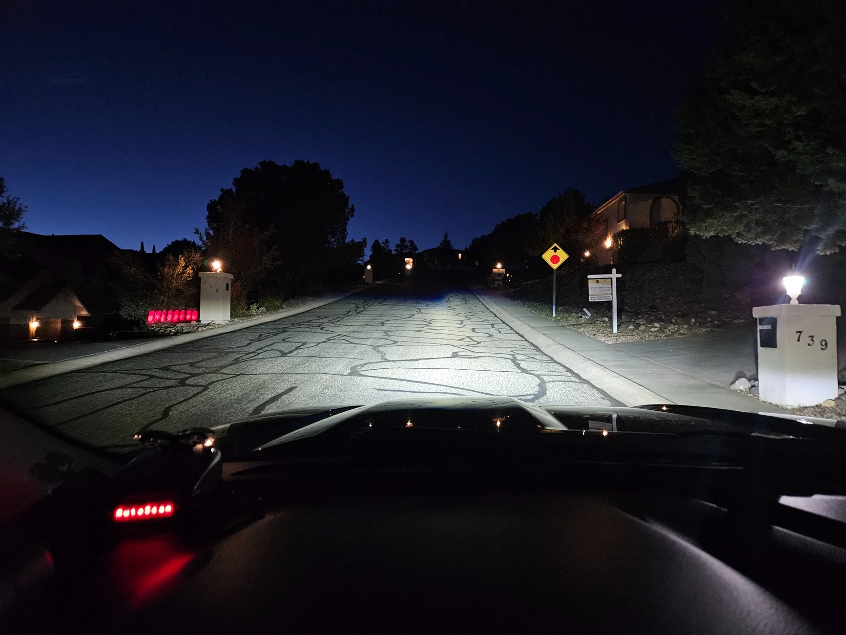

I went with AlphaRex Nova. I was blown away by how bright they are. Nice clean cut off. I have never been flashed. First photo is low beam, second, high.
https://www.headlightrevolution.com/Alpharex-Nova-Headlights-16-20-Ranger?quantity=1
