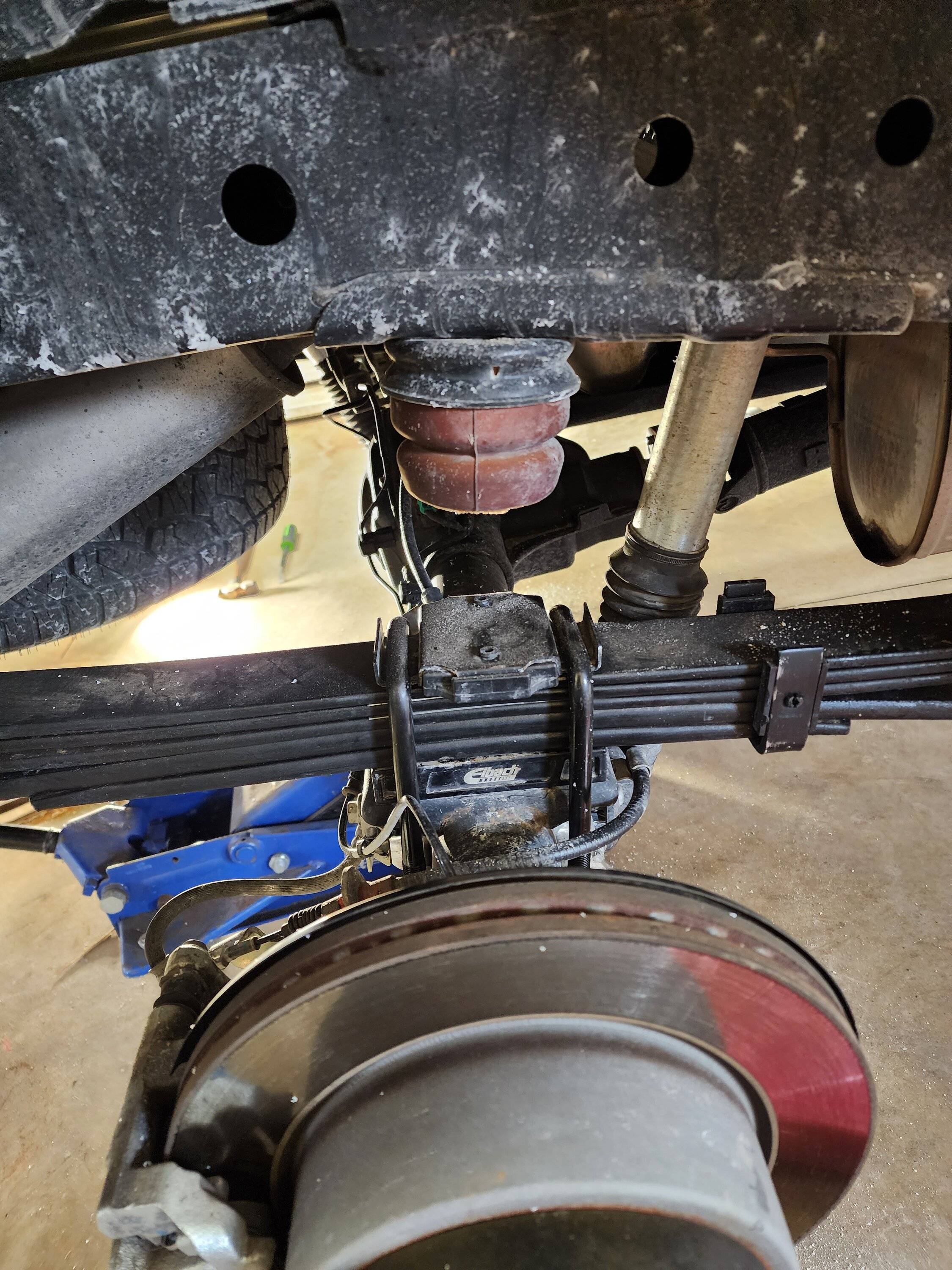

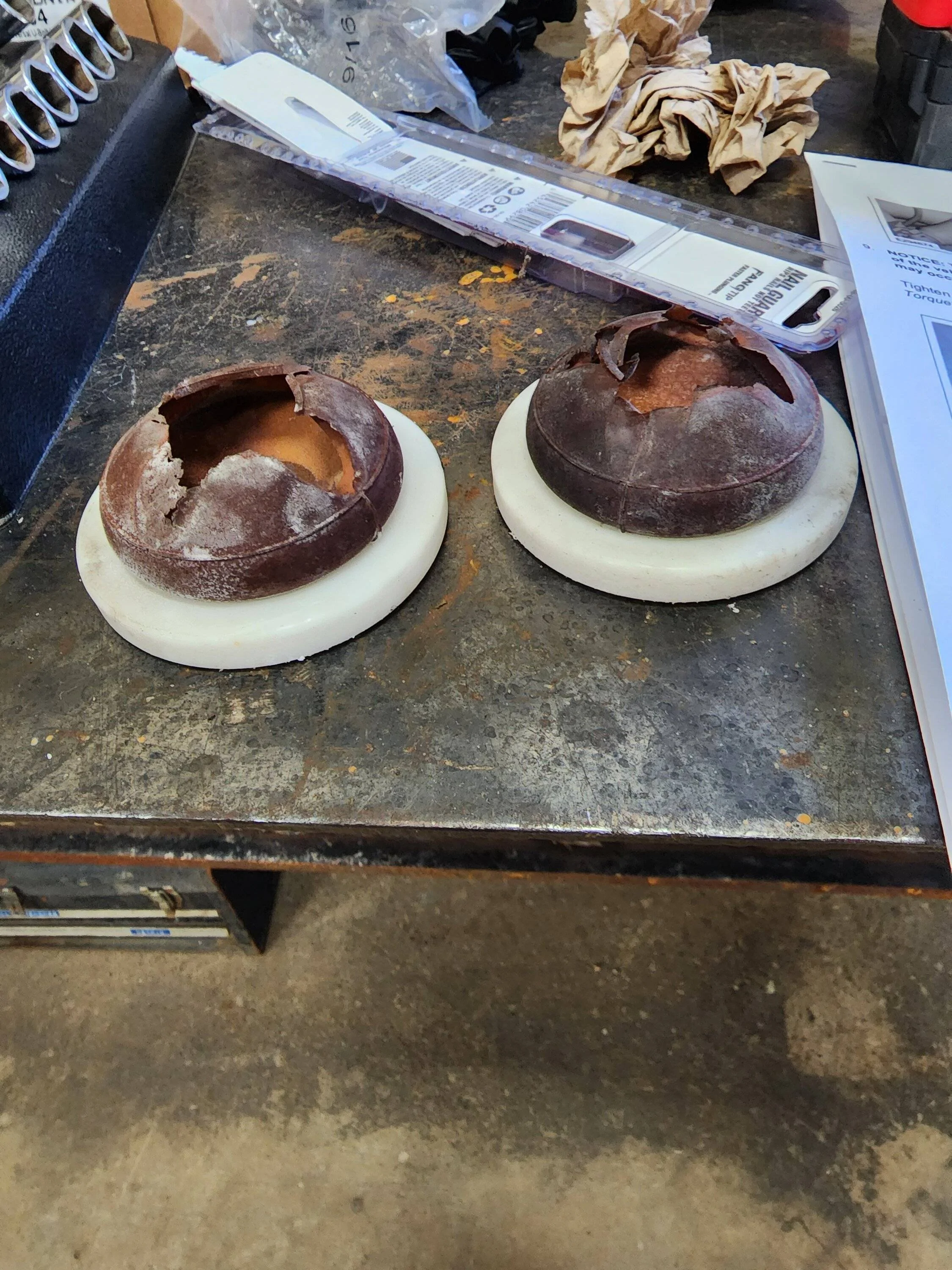

Got mine done. Only had time for a short drive but seems much better. Especially on larger hits and dips. Original springs would launch the rear of the truck up after a big compression even with the Eibach shocks. Much more controlled now. Gained maybe 1/2" that I figure will go away once broken in. Cut the factory bump stops above the plastic ring to shorten them.

Drove around a bit hit the speed bump on the turn in to my street and wow this thing rides like a Cadillac. Couldn't be happier with the outcome. Just waiting for my raptor bump stops to get here, but I don't do a lot of articulating out chasing birds so not too worried about that part.
Put some more miles on it running around town and I've come to realize the change in rear height eliminated the driveshaft launch shudder truck is incredibly smooth now, dare I say it. The way it should have been from day 1.?
My experience exactly.
There's this bit on my daily drive with a dip followed by a bump making a little mini whoop section. It displayed the weakness of the stock suspension and it's undersamped shocks very well. After my Fox and ROW spring pack install it was a vast improvement.
The truck should've come this way.
