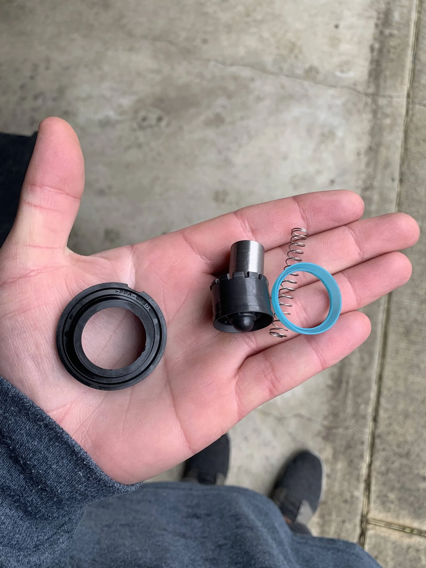

I noticed my balkingness and flat spot throttle response was back so I checked on the GFB DV and the brass piston was stuck. Kinda got crooked and wedged in one spot.
Maybe because I left the spring out but anyway I’m done with it.
If anyone wants to try one I’m putting this one up FS.
Wonder if it's a knockoff. OEM is self-tapping into plastic. Those of us that upgraded to aftermarket intercooler charge pipes use threaded now.
EDIT TO ADD: I wonder if leaving the spring out contributed to the jam?
