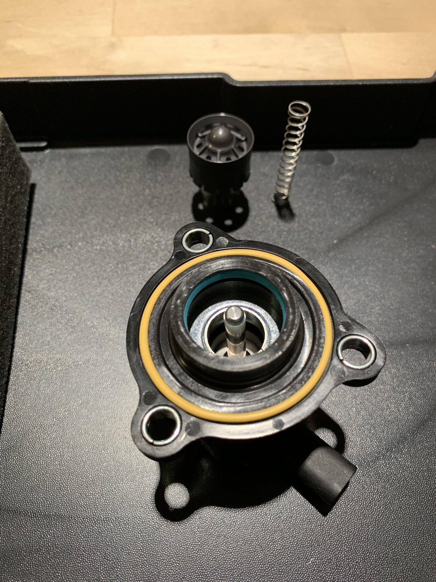

Pretty easy. Remove the 3 studs with E3 torx bit, remove the little lip from bottom of the stock valve (plastic ring thing, remove with pliers), assemble DV+ and stock valve and bolt back on. I can probably do it in 10 mins or less.

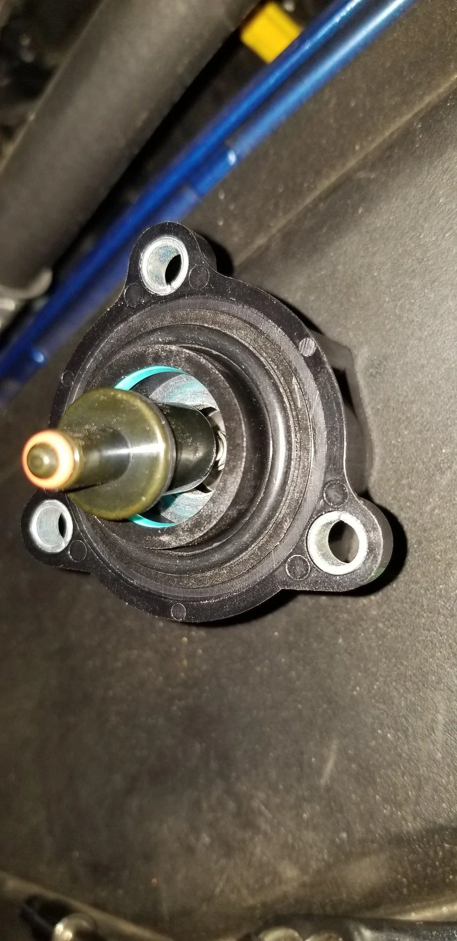

The lip/ring that sticking up needs to be removed inside of the o-ring. Use pliers and twist it off. Can be a bit tight.

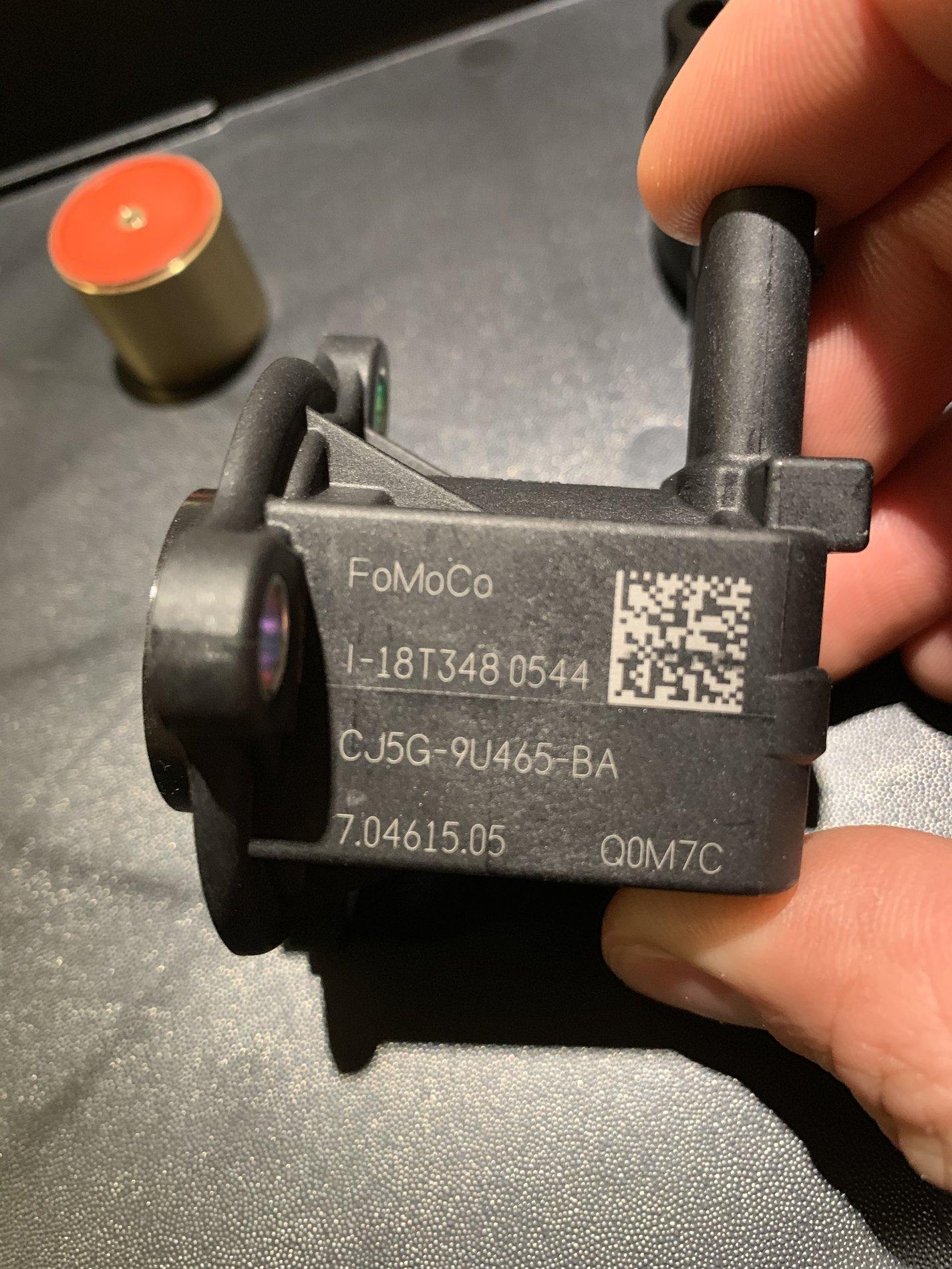

Anyone have a part number off their actuator? Mine looks different. Engine build date is 01/25/19
