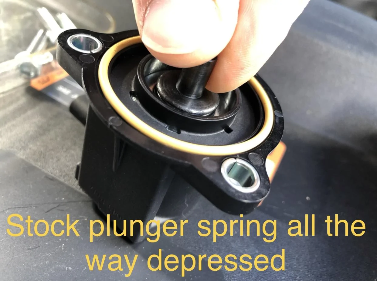

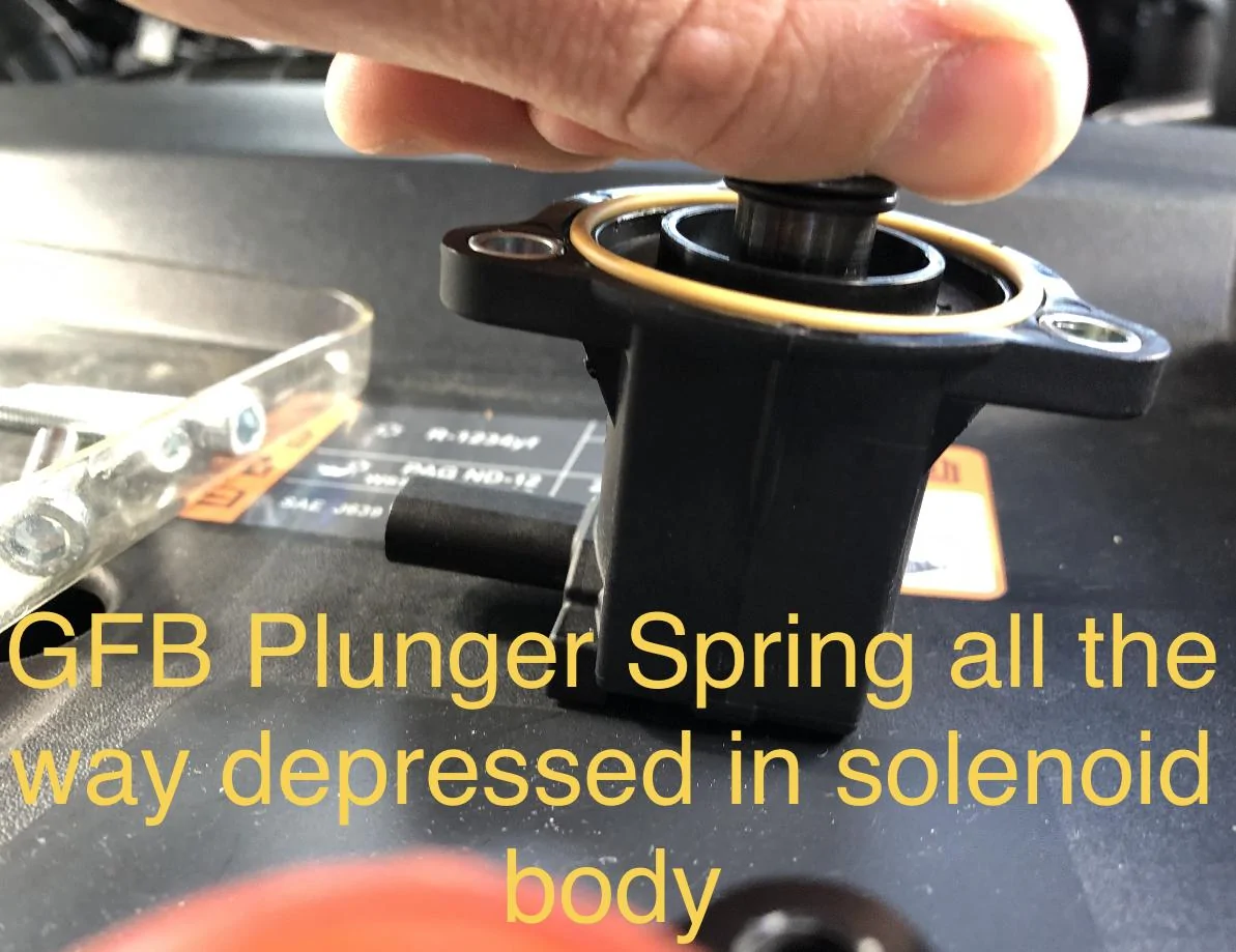

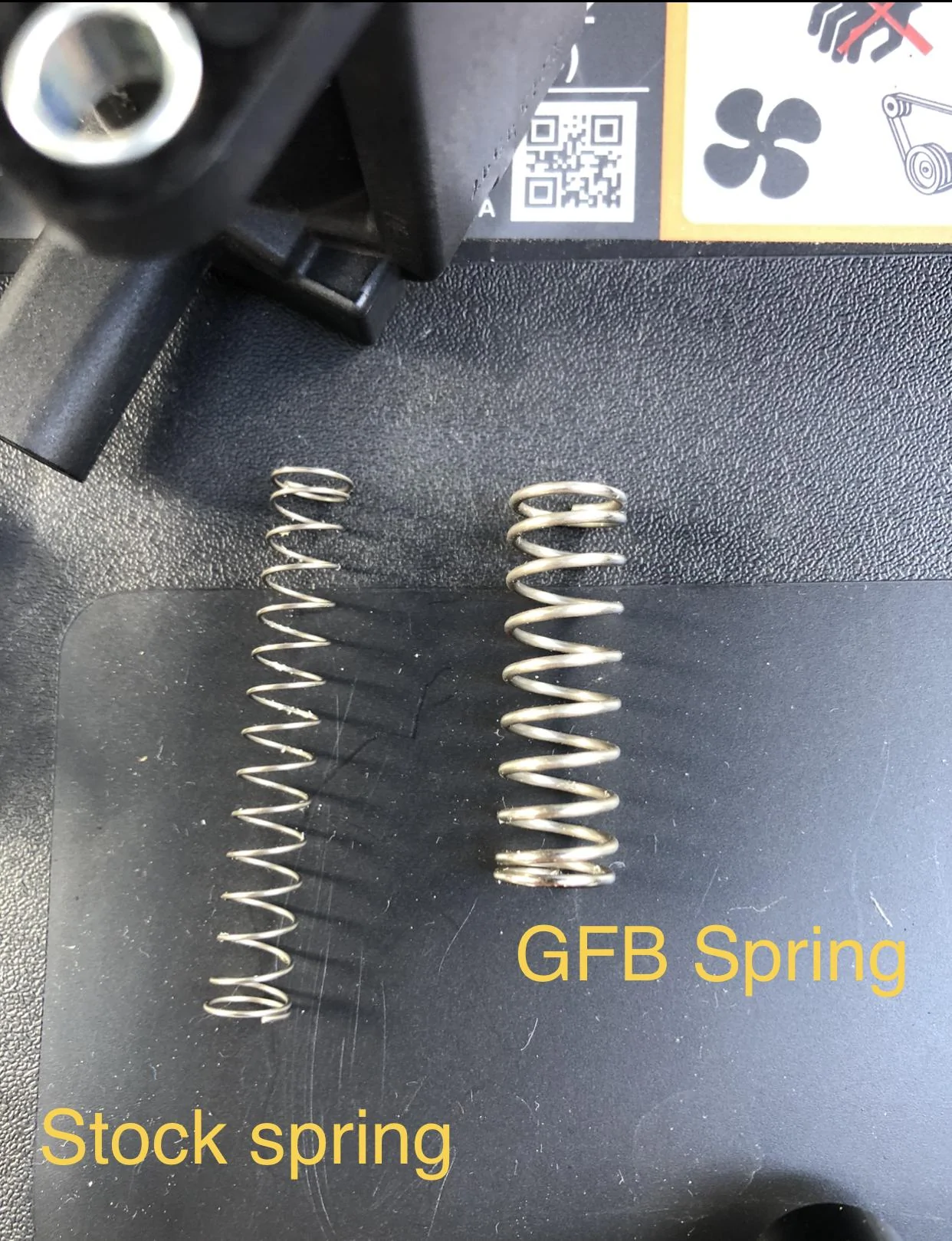

Installed my GFB DV today and had a quick question for the forum.
The plunger spring that came with my kit was much too big for the unit to assemble, and seems clearly the incorrect size as the plunger would not fully depress and seat into the solenoid body.
I ended up using the stock plunger spring along with the rest of the GFB kit and it assembled quite well thereafter.
A test drive revealed nothing but the improved turbo performance.
Any thoughts on if it’s okay or not to just run that stock plunger spring?
Pictures
Did you remove the plastic bit in the stock unit? The discussion on installation and removing the stock plastic ring starts on page 1 of this thread. I'd be concerned you are disabling the valve function altogether. You can also not install a spring at all, although that might make performance less refined.

Did you remove the plastic bit in the stock unit? You can also not install a spring at all, although that might make things less refined.
To update my issue - I emailed all the photos to GFB in Australia. An engineer there got back with me and was just as perplexed by the plunger spring as I was. He said it "doesn't even look like a spring the carry for any of their parts".
So I'll chalk it up to an anomaly.
GFB had one of their US distributors send me a new plunger spring right away so it's all be buttoned up now.
