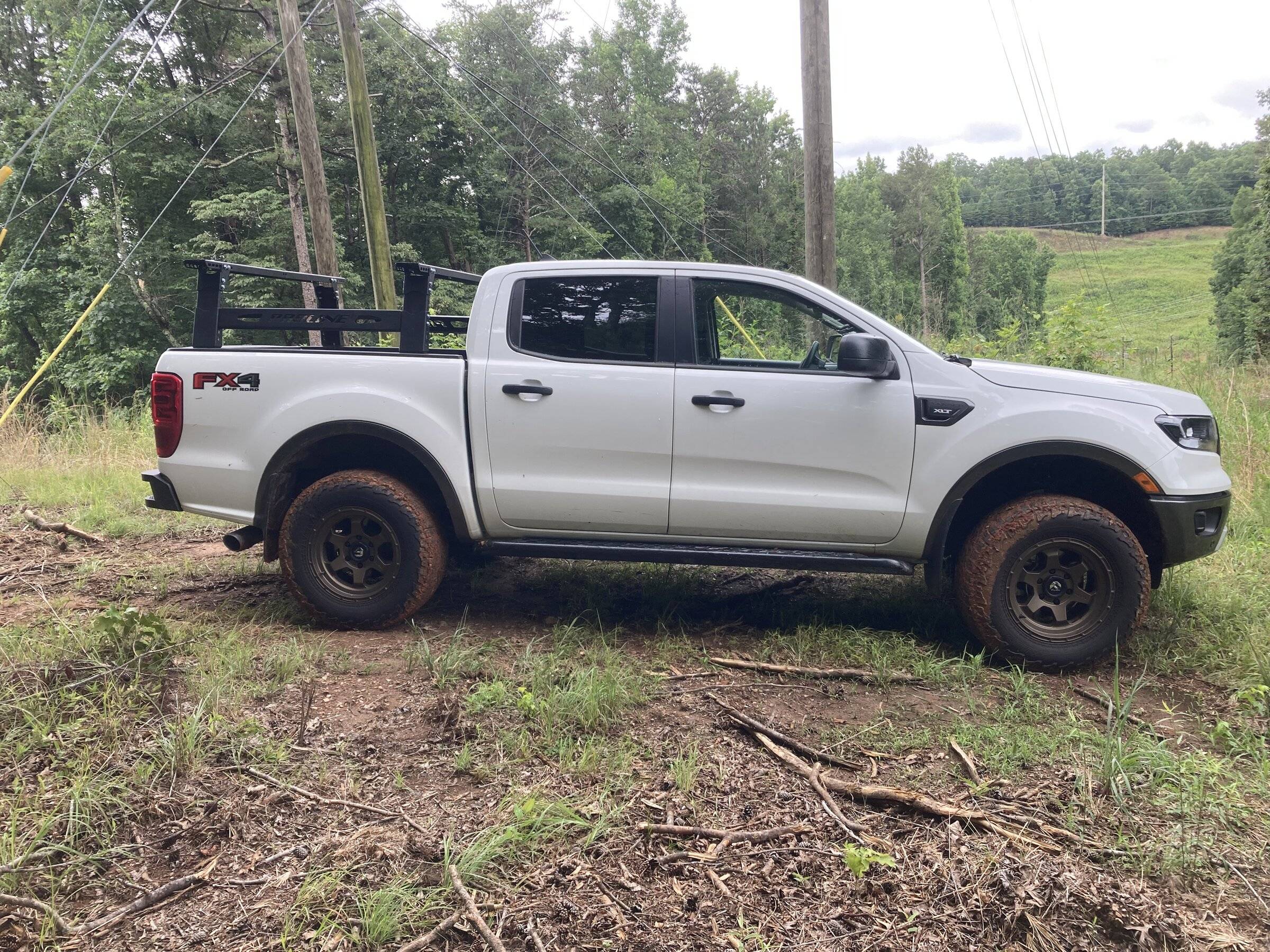

I'm running the 2" Zone leveling kit which is a bit different than the typical spacer lift in that it has a thin space (approx 1/4 inch) and a collar that compresses the spring.
I got mine at Stage 3
This gives you the lift and also firms up the front end to help with the porpoising that these trucks can do when stock.
Add a pair of Bilstein or Eibach shocks in the rear and you will be amazed at the improvement.
Here it is running 265/70/17 tires.
