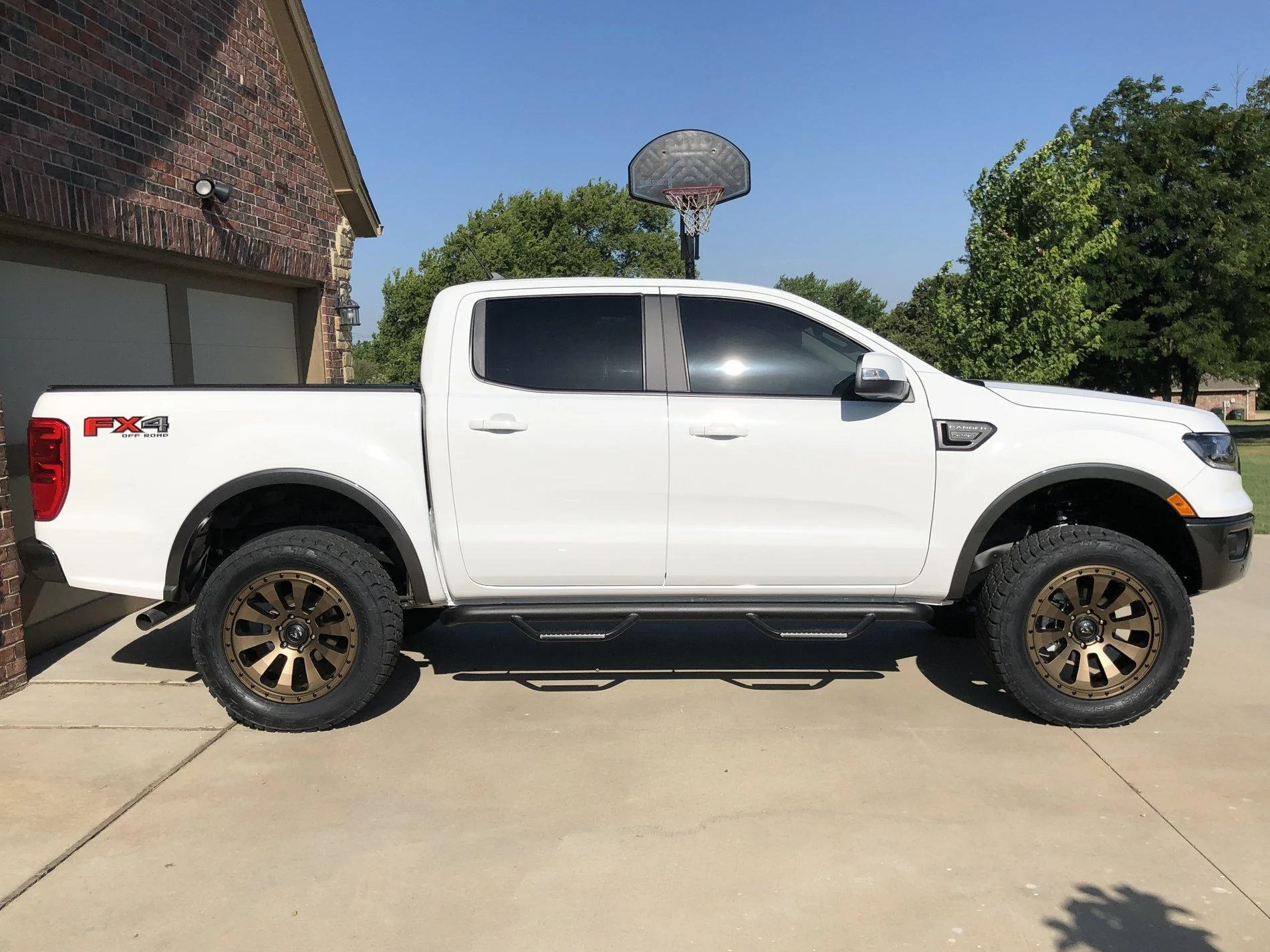

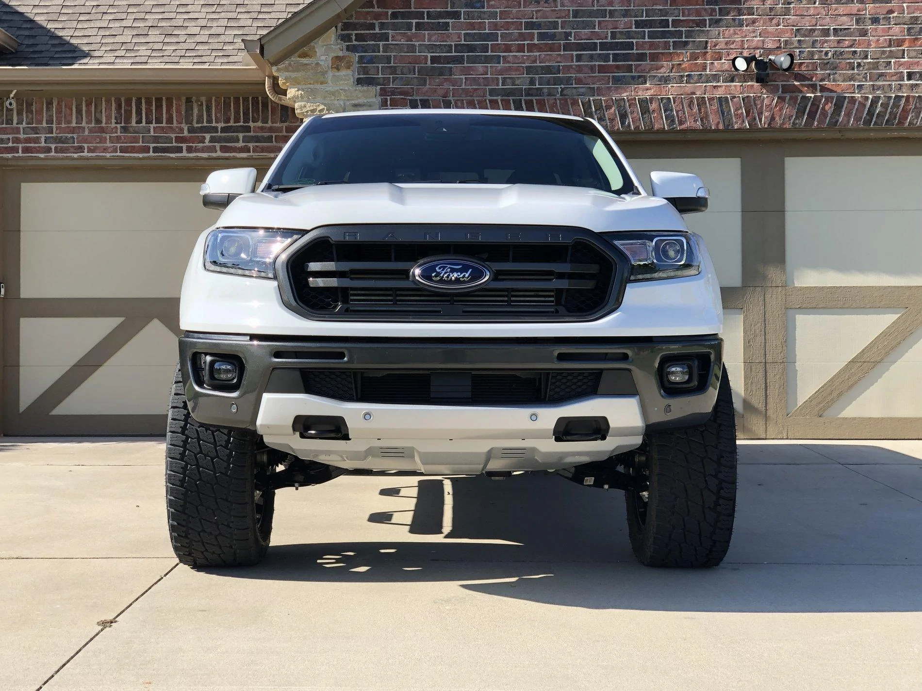

Finally was able to finish my project. This is with a 3in readylift level kit. Added readylift intrusion beams and wheels are 20x9 Lonestar with a +10 offset wrapped with 275/55r20 Pirelli Scorion All Terrain plus tires. I have no rubbing and needed no cutting. I know finding info you may be looking for can be difficult sometimes. So if anyone has questions feel free to ask.

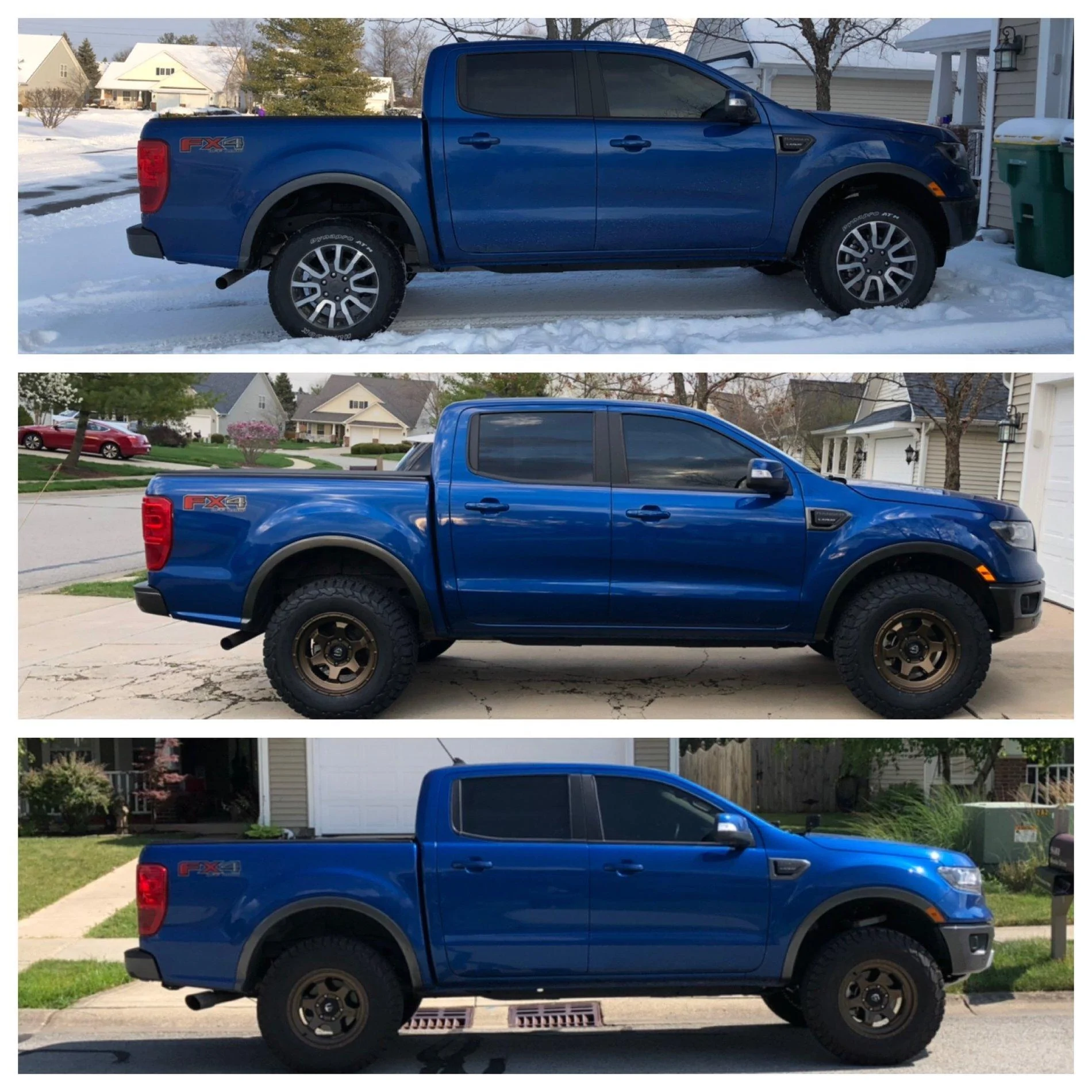

Taking this opportunity to update my own before and after shots since replacing the RC level kit.
Rough Country 2-1/2" Level Kit
Fox Performance 2.0 set to 2”
General Grabber A/T X- 275/70R17 (32")
Menace Wheels - 17" x 8" +15mm Offset
ReadyLIFT Anti-intrusion Beams
Before & After with Flares
Before & After without Flares
