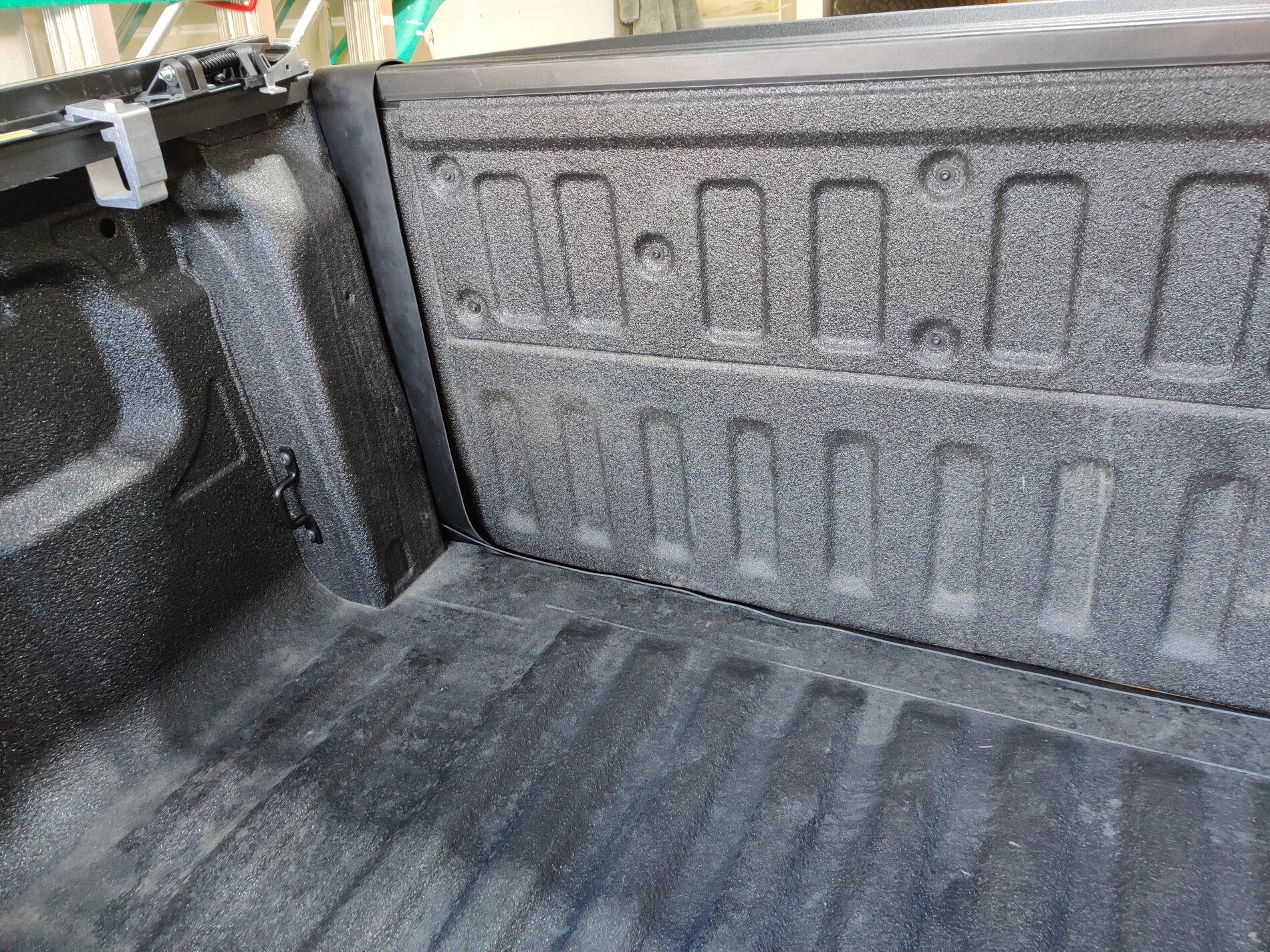

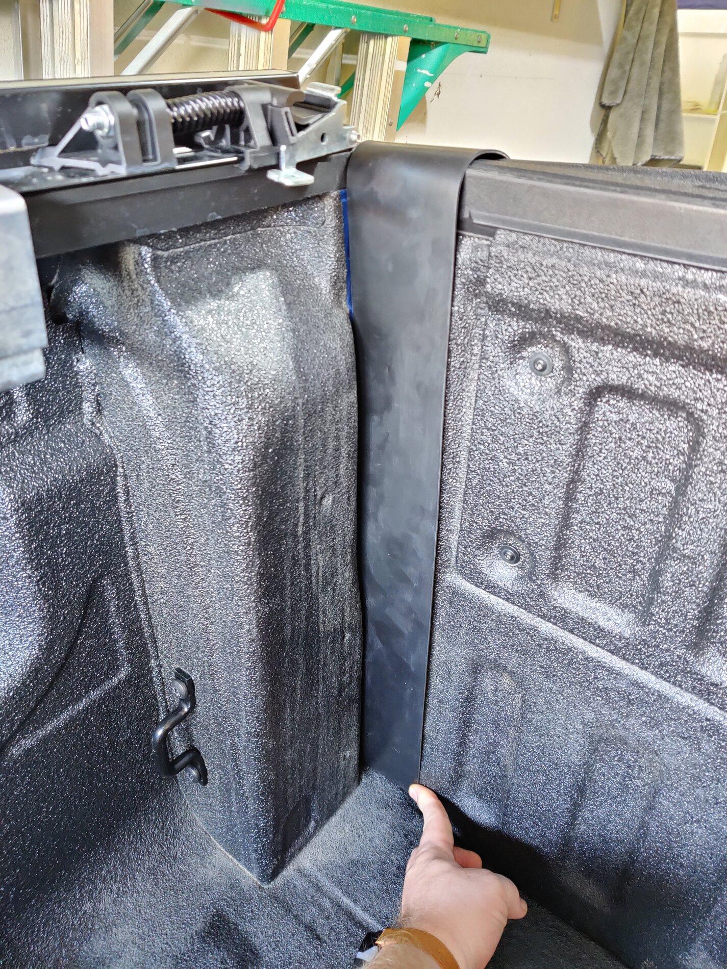

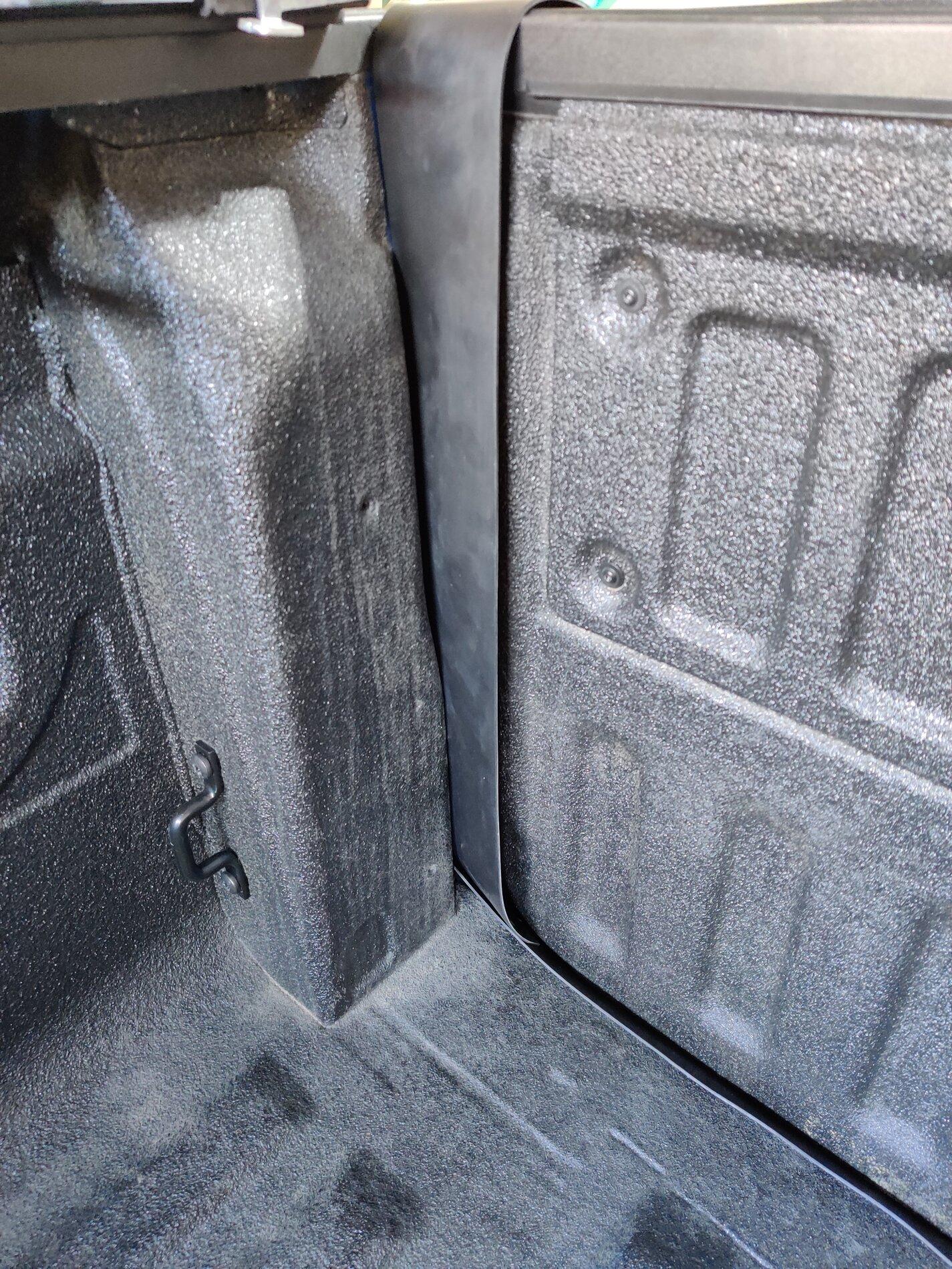

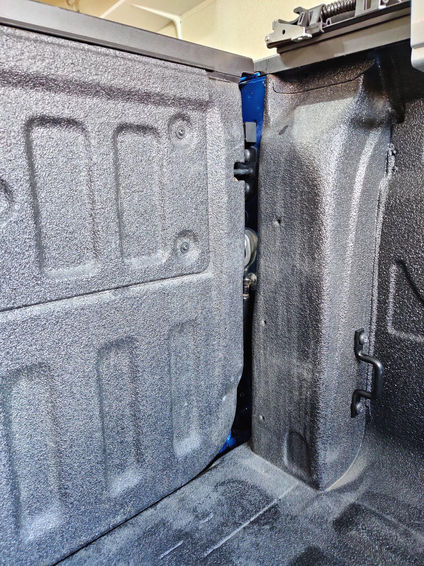

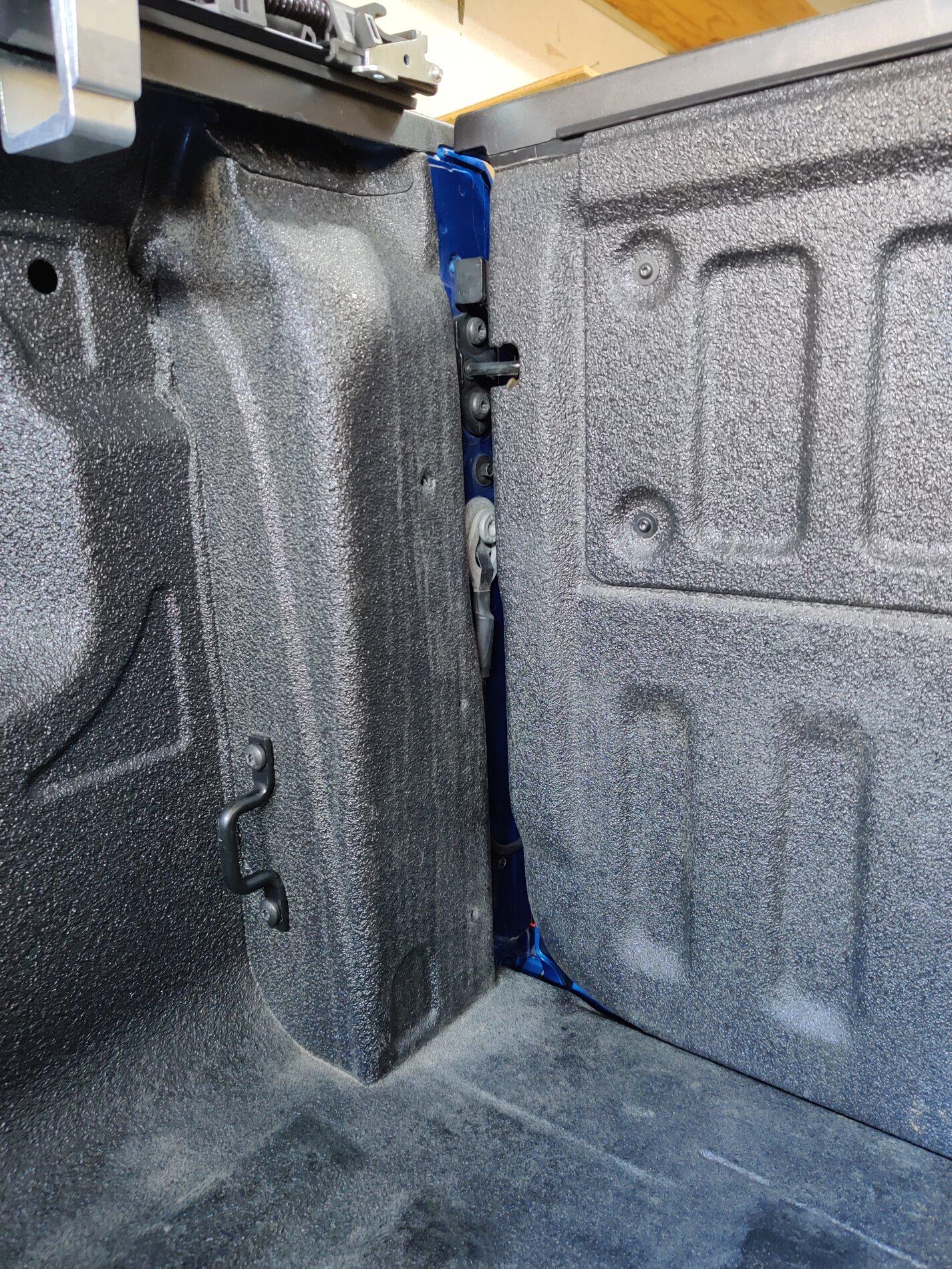

TL;DR - Quick one up here. The massive gap around our tailgates is hard to seal, off-the-shelf "universal" kits don't seal properly. What can we do to seal it?
So, a few months ago, I picked up and installed the Extang MaxSeal to try and solve the issues with the spaces around the tailgate. Despite mounting it as far back to the tailgate lip as I could it just didn't seal up for the dust from the dusty off-road/trails here in SoCal, it helped alleviate maybe 10-20%, at best, of the dust I was dealing with.
The way the gaps look from inside the bed (these are not exaggerated, the tailgate is fully closed, all the light spots you see around the tailgate are gaps all the way through, except for the yellow part of the sticker on the damper):
The bottom corners of the tailgate are definitely the worst part of it without question.
I've been trying to find materials/ways I can try to create a seal, even if it's not tight, to stop up this gap. My latest though is to use some rubber door scraper seal that I can stick to the bed and/or the tailgate to create a decent seal around it, like so:
So far, this is the best I've come up with, obviously with some trimming to make things look a bit neater and fit more closely to the gaps. Mounting (with double-sided tape?) the sides to the tailgate themselves with cuts as needed to go around the latch and catch for the tailgate, and the bottom of it mounted to the bed itself, since it doesn't need much down there to make a seal, except for the sides.
I'm curious if anyone else has come across any other solutions that have worked to really seal the tailgate. I still can't believe Ford approved these kinds of gaps.
