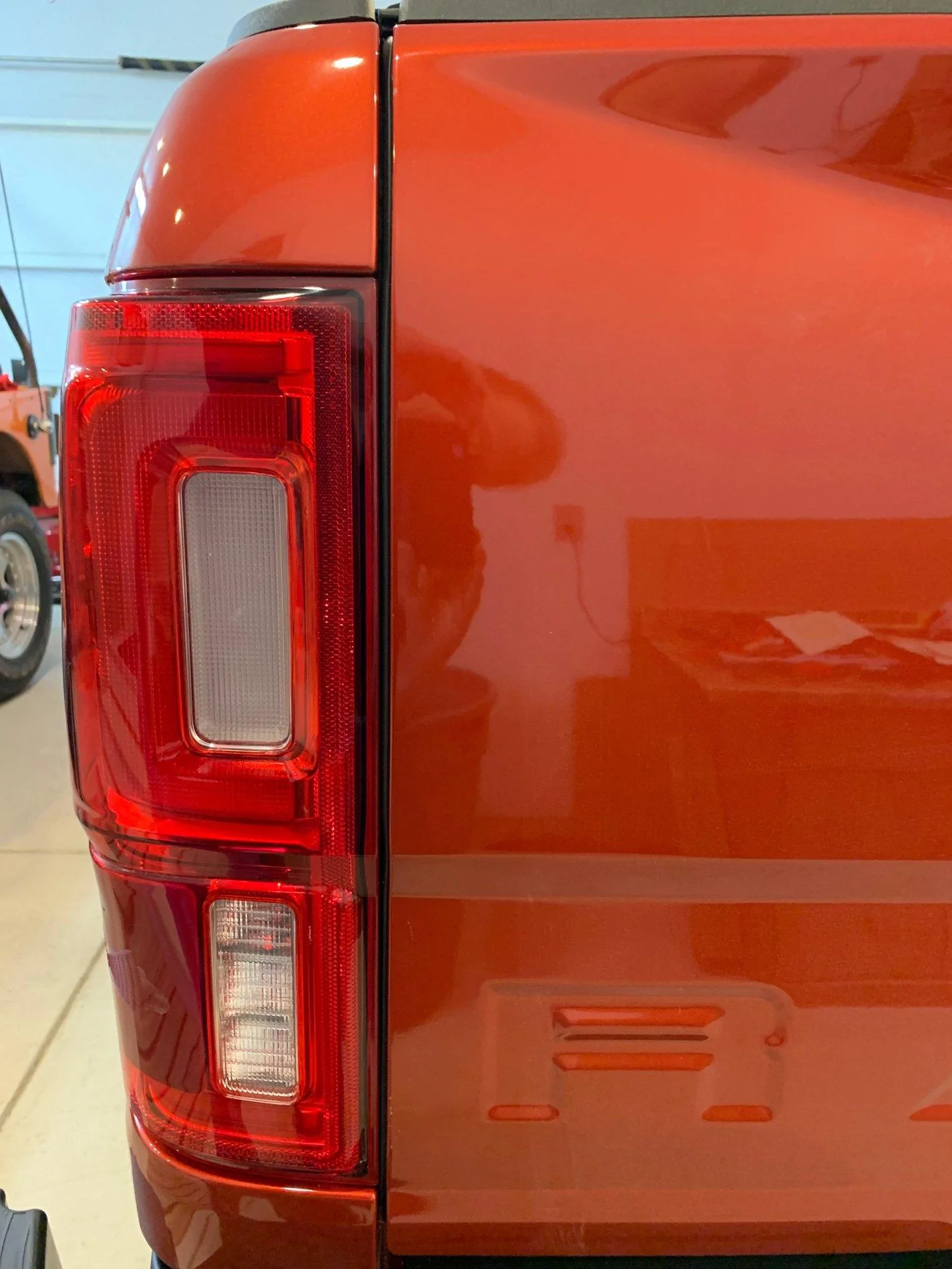

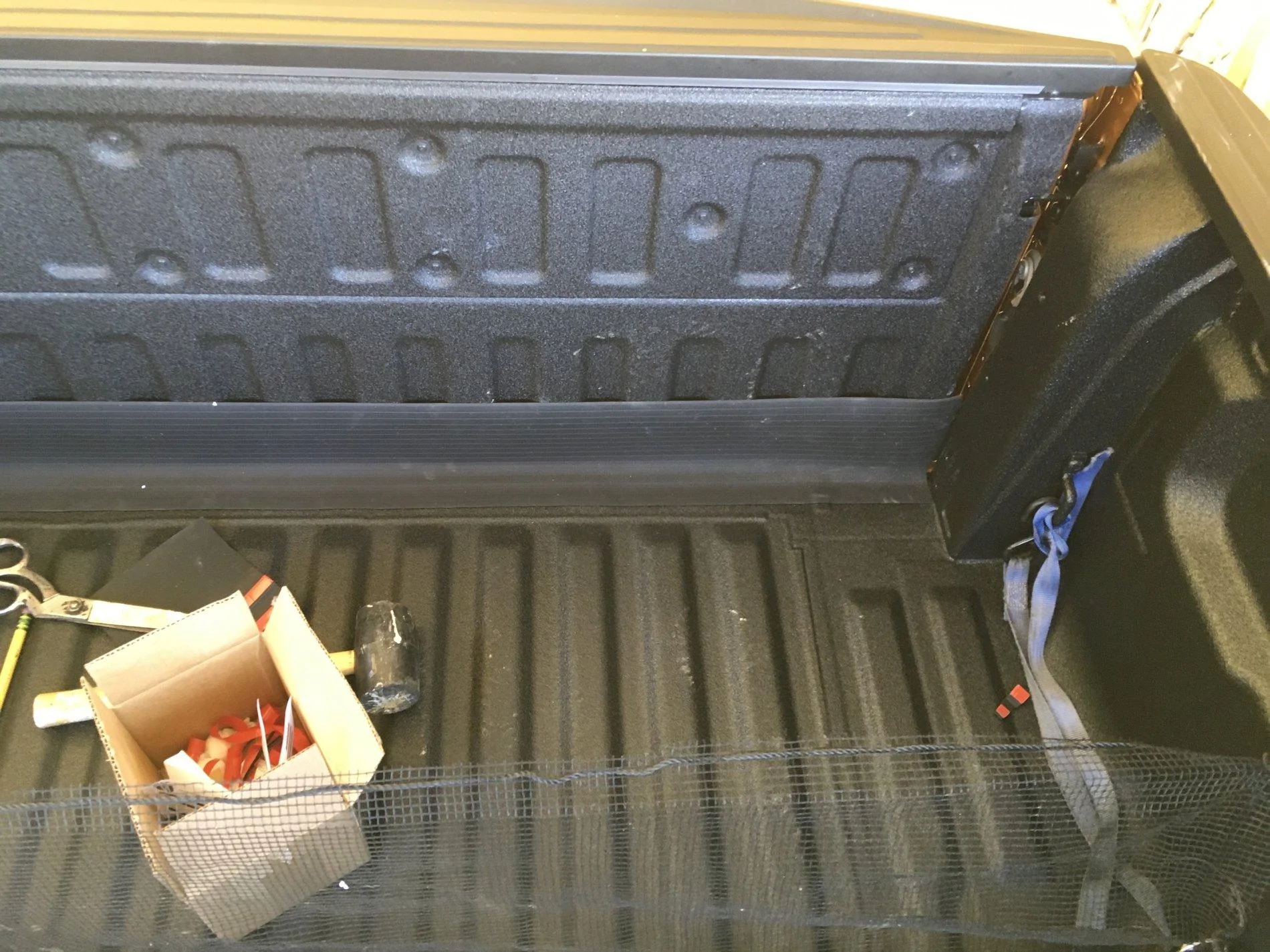

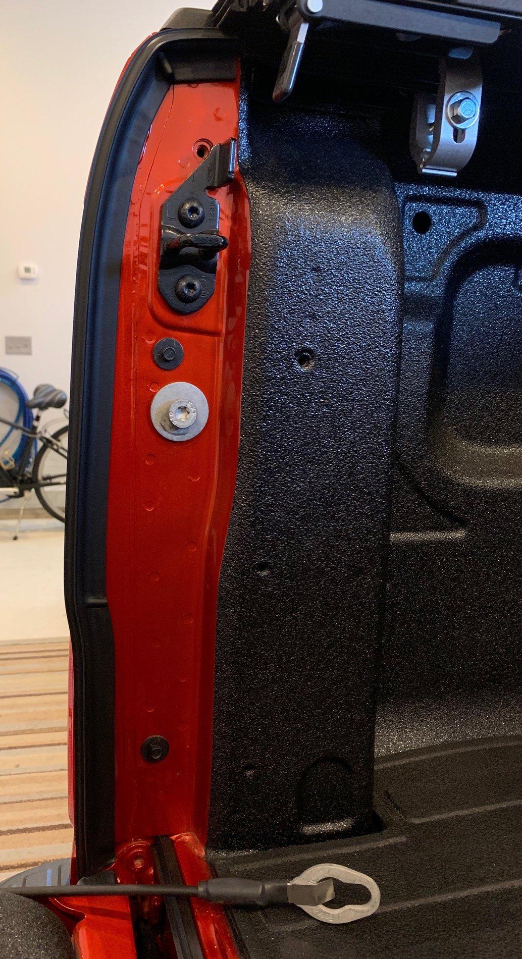

I ended up placing the bottom seal on the truck, not the tailgate. It's a little more protected as it sits lower and won't get snagged by sliding something off the bed. I did raise it more than needed to allow the glue to grab a flat area. The sides are easier to install if you temporarily remove the tailgate cable (one side only....:eek!). and I generally kept the seal even with the tailgate light.
I followed DHares lead and pinched the material to make the corner rather than cut v-notches. The pinch seems to help hold the seal closer to the truck and I think it is ultimately better than v notches:

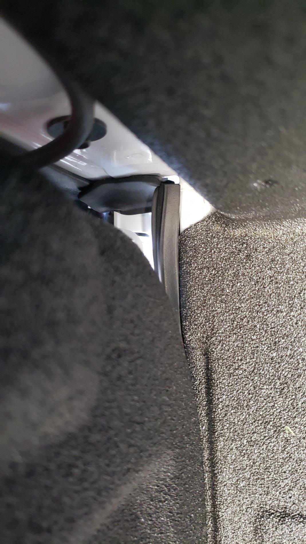

Has anyone found a way to seal the area around the hinges at the bottom corners? I still see light thru that area and dont see a way to seal it.

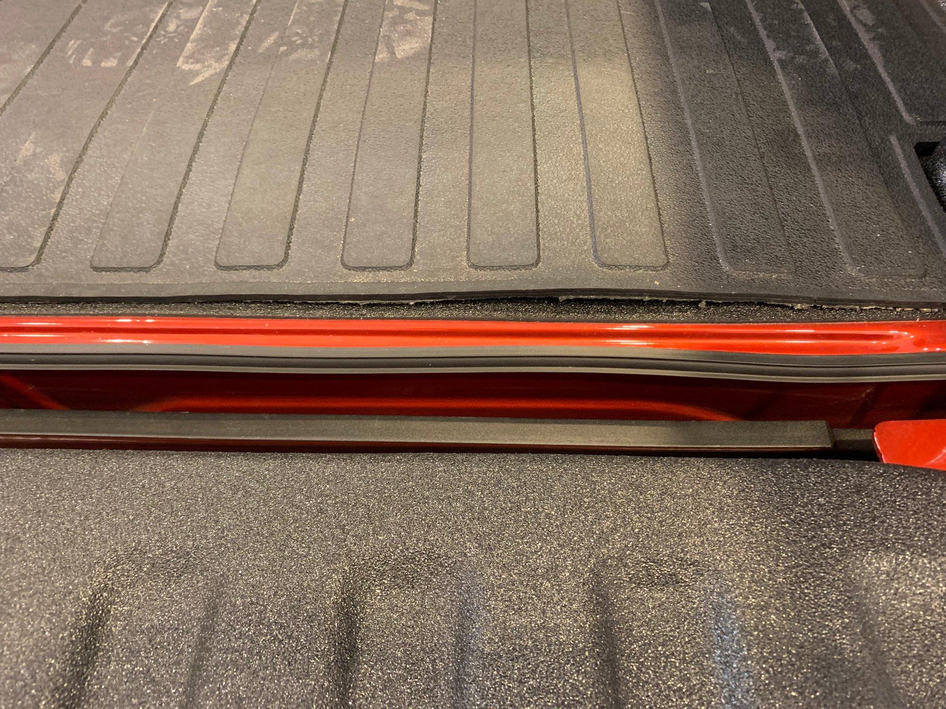

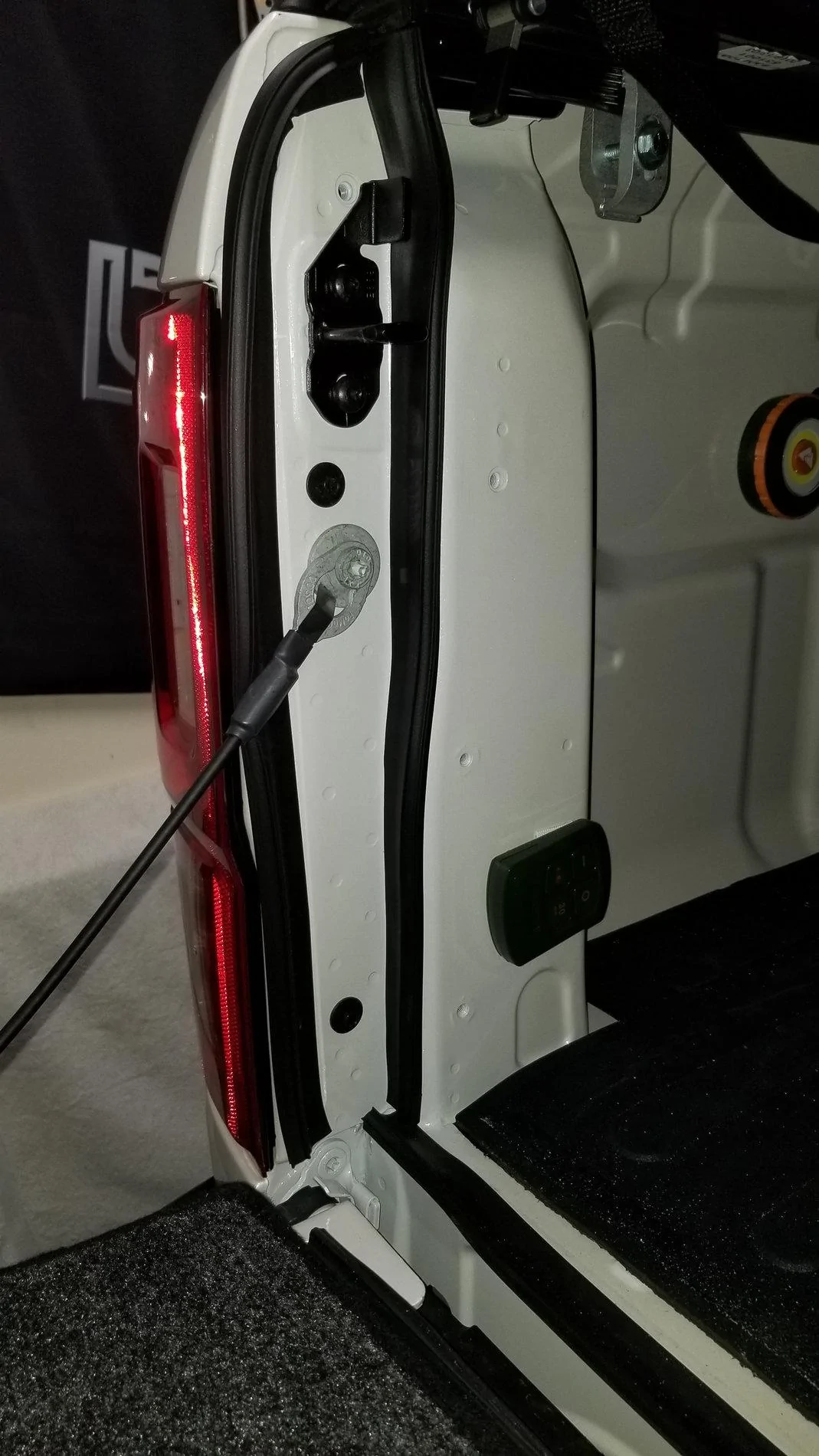

I used a double seal on the tailgate, It is completely waterproof. Like most vehicles, the rear gets dirty fast and all that can get inside the bed. Since we carry musical instruments, I need a dry bed.

Looks like you still have the gap by the hinge. Do you not see light coming thru at that spot with the tailgate closed?

So do you need both inner and outer? Why not just the inner?

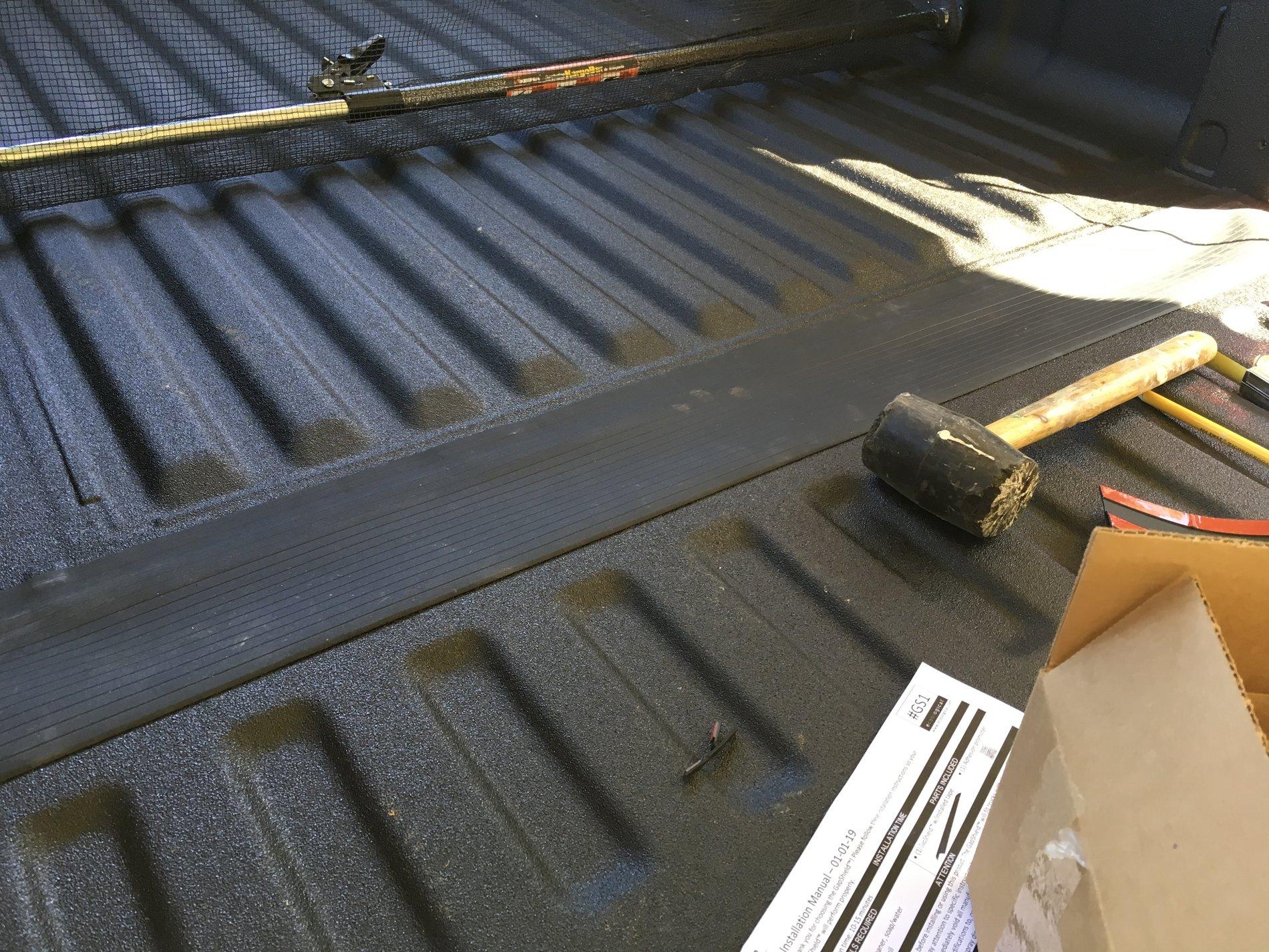

I looked at that and thought it was to narrow. Put this on today. More photos in my garage

My measured about 5 inches which is why I went with the wider strip
