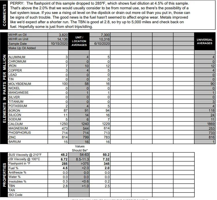

Fuel in oil
geophb
Aug 3, 2020
530
750
2019 Ranger
Mechanical Engineer
-My first oil change at 1500miles because it was at the twist. A lot of short daily trips under couple miles. It didn't reek of gas to me, maybe a hint but its hard to tell with new oils today.
-From 1500-2200 miles, more short trips. Was at the dot in 700 miles, about the same level increase timeline as previous.
-2200-3200 (current) still at dot basically, maybe 1mm above it. Now I have a 30 mile one-way daily commute instead of 1 mile commute.
So far the extreme short trips was my issue, time will tell. I will keep an eye on it.

Wow! The oil viscosities are sure taking a beating in these engines considering the low miles on the oil. Even Doc's with no apparent fuel dilution.
Are you guys changing your own oil? I would almost suspect some dealers are using 5w-20.
I'll be changing oil on my Ranger soon and plan on sending samples to Blackstone and WIX Labs. My oil level has been constant over 4,000 miles so I'm not really anticipating fuel contamination. I'll advise.
Doc, I think the short trips are my problem also and here in Minnesota during cold winters the problem gets worse. After my last oil change I put ~750 highway miles on and the dipstick showed zero rise in oil level. For the last ~250 miles it has been mostly driving around town and the oil level is rising again.
My town trips are long enough to get the engine temperature gauge in the normal operating range but the oil does not get heated up. I'm starting to think that the only solution to this is frequent oil changes for this truck.
