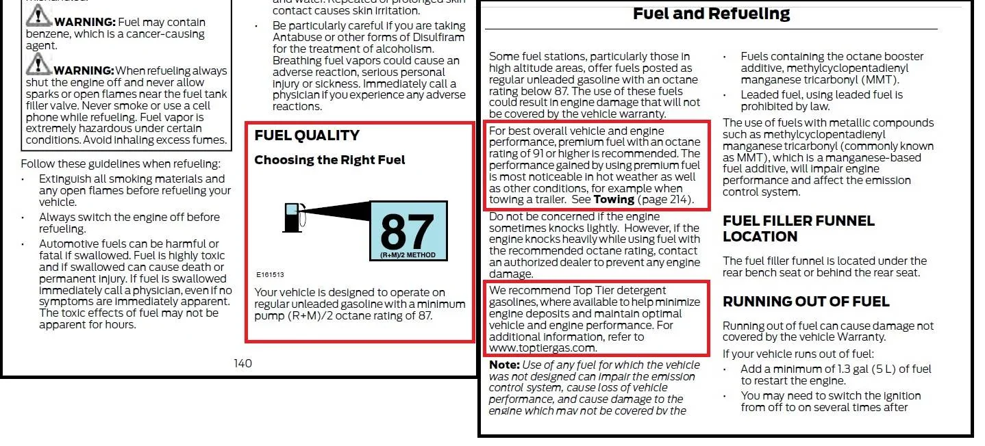

I'm no expert, but I don't think MPG correlates to longevity. It would make sense that MPG improves with premium since the computer can advance (retard?) the timing without knock. I intend to keep this truck long term (until a PHEV comes out). If Ford said premium was required it would be a different story, but they say regular is fine. The only time they even mention premium is when towing.
Actually in the manual it states " For best overall vehicle and engine performance, premium fuel with an octane rating of 91 or higher is recommended "
And they also recommend top tier fuel to help minimize deposits.

I still maintain that is for performance, not longevity. It does recommend top tier gas "to help minimize engine deposits" - if premium had other benefits I'd expect there would be similar wording on the premium text.
Like I said, I'm no expert, but that is my take.
@P. A. Schilke - what is your take on this? Does running premium enhance longevity?
Hi Rob,
The 2.3L was tested with a range of octanes but not the M+R/2 pump number...it was Research octane numbers from below design intent to above design intent. This is a programed dyno of the engines only at our dyno labs building. The program reflected durability cycling of the 90 percentile usage. These engines were then subjected to post test metrics like leak down tests...valve lash measurements etc, and compared against pre test numbers. Then when indicated, torn down and again measures with manufacturing specs on the various components that indicate being in question. If abnormalities were found further research and testing would be conducted. Not every test engine was torn down, but the engines reflected high and low end and middle test fuel octanes.
So this long prelude is I do not know the answer other than the engine should operate acceptably to achieve 150,000 miles of durability with any specified fuel in the owners manual. So unless you are running tunes that are above octane like racing fuel for example or Ethanol mixes all bets are off...
Tier one vs lower tier is not all about octane but on the additives blended into the fuel. I am not a fuel expert by any means so do not know what additives do what.... There is another whole thread that could be started if anyone here is a fuel expert or wants to google the tiers.
Not sure this helps much... At Truck Engineering, I only got involved when we has a failure or a dyno test when south...
