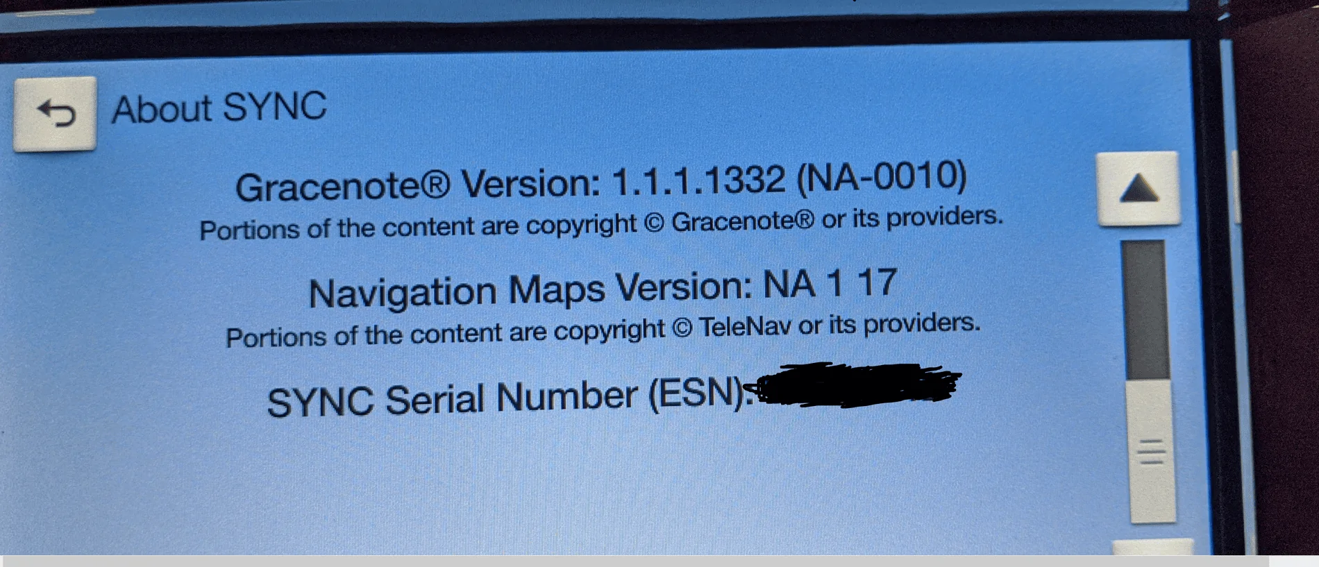

Too weird and very frustrating! So, I finally get to the point where it says the System has been updated, I can remove the USB Stick and updates will be applied when I restart the Truck. OK, restart and get a couple Update notifications but when I check the Map Version it’s still NA 17. Wtf? When I start the truck with the USB Stick now, nothing happens!
The exact same thing happened to me. Did everything the instructions said.
The Gracenote seems to be updated. I didn't see a version # before the update. Now it says 1.1.1.1332 (NA-0010) after the update.
That's a known glitch with the update on v3.3. It's actually 18Q1 after the update, but that version string doesn't change. You can double check the package versions in the diag menu and compare them against the ones on the update stick to confirm.
Yeah, that’s what I got as a result of the update. Grace note has version info now and Navigation is still NA17

So, is the glitch that it doesn’t show the correct version number, but we actually do have the update installed?
That's correct. It doesn't look like it's updated based solely on the About screen info, but the actual map and voice data have been updated.

I did the map update today and same as others it completed successfully, the Grace Notes now shows a version, but the maps still show 1 17.
