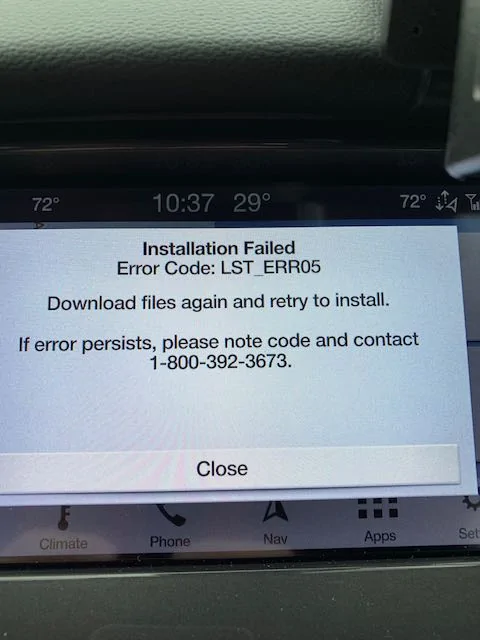

I downloaded several times from my email link as I was having difficulties in unzipping the file. Finally got it unzipped and loaded to USB, went to the truck and received error message that is attached. What a fiasco, decided to just break down and spend the $40 and order the USB. Received notice today that it's being shipped, so hopefully it will work this time.
