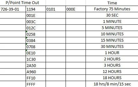

Did anyone ever find a mod for the 12v plug time? It stays on for 2 hours after turning the truck off and for me that 2 hours two long with the stuff I have plugged in.
airline tech
Aug 24, 2022
4,734
9,058
Midwest - KS
Aircraft Tech
If you are talking about the Power Points (Cigarette Lighter) Sockets
BCM:
