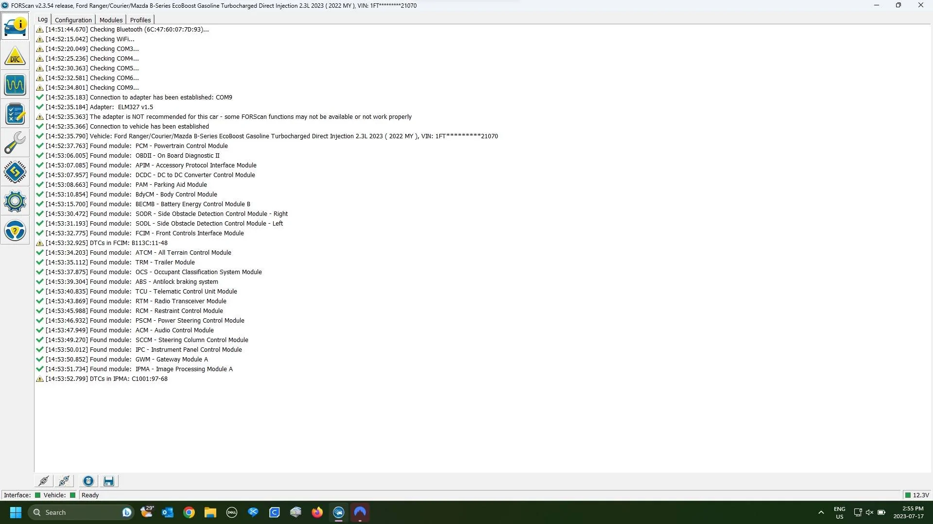

I am dumb, I can intubate people, I can give meds to revive you, can shock you and I can even deliver a baby in the back of a small box..... but for the love of god, I have no freaking clue where to go to activate bambi mode in forscan -_- I am new to this, I just want my fog lights to be on when on high beam and don<t want to mess up the truck...!!! HELP!!! here's the screen I have and I dont know where to go after...

its in the bcm
Fog lights if High Beam is on (AKA - Bambi Mode)Allows the fog lamps to stay on when the high-beams are used.

Found it and now I can't stop looking at those available options I could change ??
Bambi mode activated, drl turns off when signal light is on ?
edit: changed the color of mabiance led when opening the doors to white, changed the splash screen to bronco, activated the speed limit sign (yup, got the NA version!) also added the heated seat icons on main screen (not available in the climate screen?)
