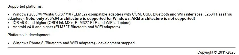

Will it work on a Chromebook? I had a Windows laptop now only a Chromebook. I have the cable will it work?

I doubt it unless there is a work around (run a windows) platform in the background like the Mac users employ to get Forscan to work.

I never tried but from the Forscan site. Looks like only Windows from a laptop.

Doesn't that Mac work around with Windows running in Parallels still require Intel CPU?

No - I know someone on here posted a thread about it and there are videos on YouTube on how to get Forscan to work on a Mac - I recall it was something like (VM), basically its just an emulator that emulates the windows platform but still uses the onboard installed hardware, so as long as the (VM) is open and Forscan is loaded through the VM - when you connect and use Forscan, it sees an (fake - emulation) of the windows platform and runs the program - not sure if Chromebook will allow the same (emulation)

I may have to look into again. A while back I was able to install ForScan on Windows for ARM running on my MacBook (M2) I was unable to get it talking with the USB-OBD2 (OBDLink EX) adapter. Would be nice it is does work. Would be one less reason to keep the old Windows laptop around.

It should work on a chrome book if you run it in android mode and use the android app. Must say I haven't tried this though.

Well, tonight I was able to talk to the adaptor from Windows for ARM. Not sure if a Parallels update that fixed it or what. I will note that the firmware updater failed to scan for the adaptor, I had to manually set the serial port for it to see the adaptor. Once it saw the adaptor I was able to flash the latest firmware as well.

You'll need to lodd Virtual Machine Software such as Oracle VirtualBox, but that operates on a Chromebox OS. I fear that the CPU will not be powerful enough to handle a VM.
There is a way to do it what you want, but it is complicated process. You need to install a "Linux development environment", then download and install Oracle VirtualBox, then install Windows 7, 10 or 11, then install Forscan in the Windows Virtual Machine.
It is complicated, but if you are fluent in Computer OSes and Software (an I/T Techie), it is pretty straightforward. You'll have the most trouble configuring the VM to allow access through the USB port.
But it IS doable... Here is a link on how to get it done.
How to Install and Use VirtualBox on Your Chromebook
Once you've installed the Virtualbox, you'll then install your versions of Windows. I use Win 7 as it is not as big a hog on resources as the newer versions.
Once windows is installed, you can download and install Forscan in the Windows Virtual Machine.
It IS complicated, but it can be done.
A much easier way to go is to purchase an old Thinkpad T490, and use it. They can be had for ~$240. Then install Forscan on it and enjoy.
