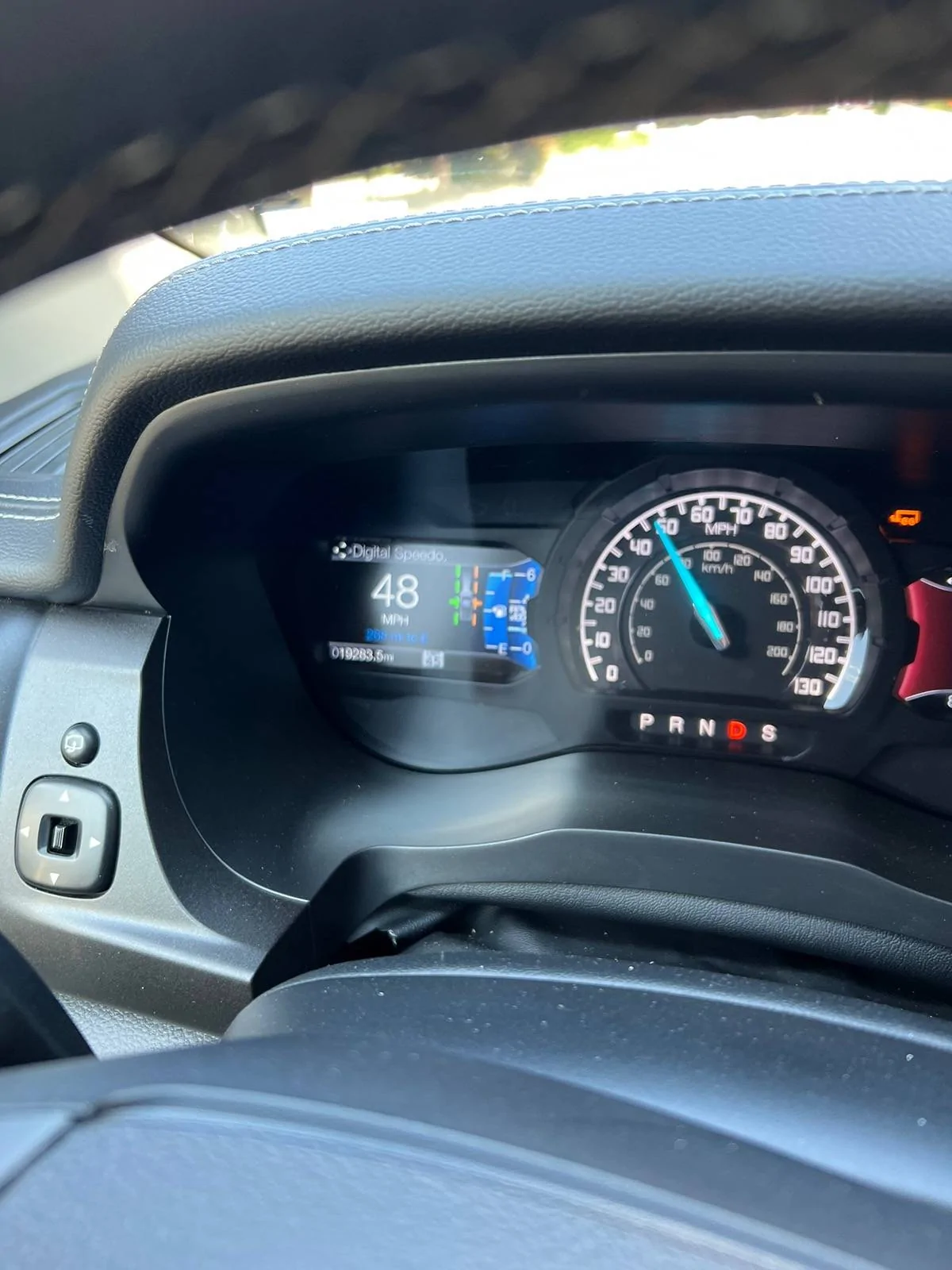

Anyone else enable the speed limit sign display and have American style signs? Unsure if I ever posted the photo but I’ve had this for a year plus now.
Yes. I enabled mine over a year ago and are American style.

I enabled mine a year ago but only get Euro signs which I believe is because mine is a 2019.

I've had it enabled on my 2019 for 3+ years with the European signs. I think the US signs were a firmware change with the 2020 MY. I also have an extra blank circle next to my speed sign that I believe is for passing zone or caution signs in Europe.
