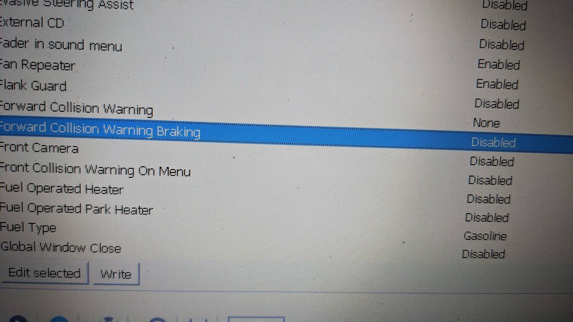

I'm only guessing, but based on other firmware I've played with the firmware option may only enable showing the feature in the dashboard cluster menu. If physically available, it would then need to be enabled in the dash menu as well.
I have a 2020 XLT and it definitely has automatic braking on by default. I was taking my wife to a doctor's appointment and it saved us from a red light runner when our light turned green. I was impressed, as it reacted faster than I could and we stopped just inches short of a collision.
Yes but is ur forscan screen disabled like mine?

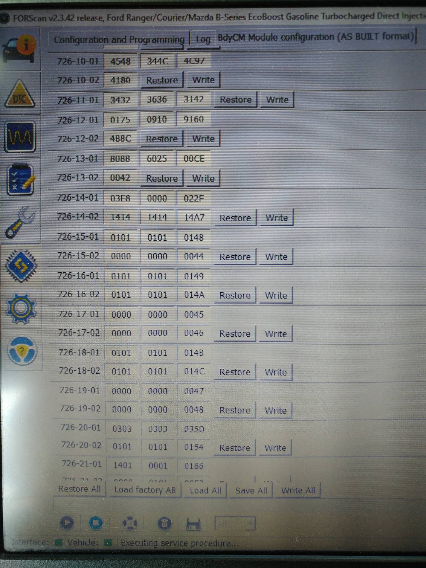

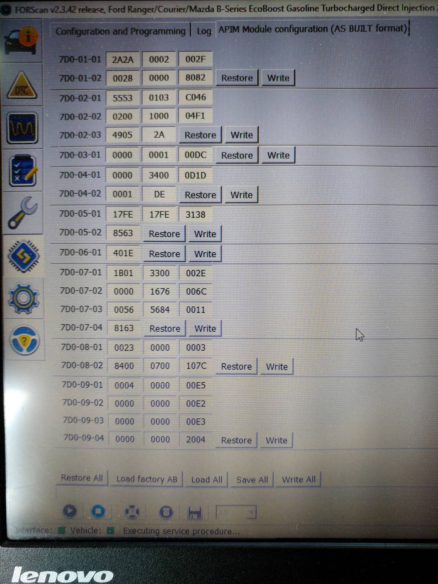

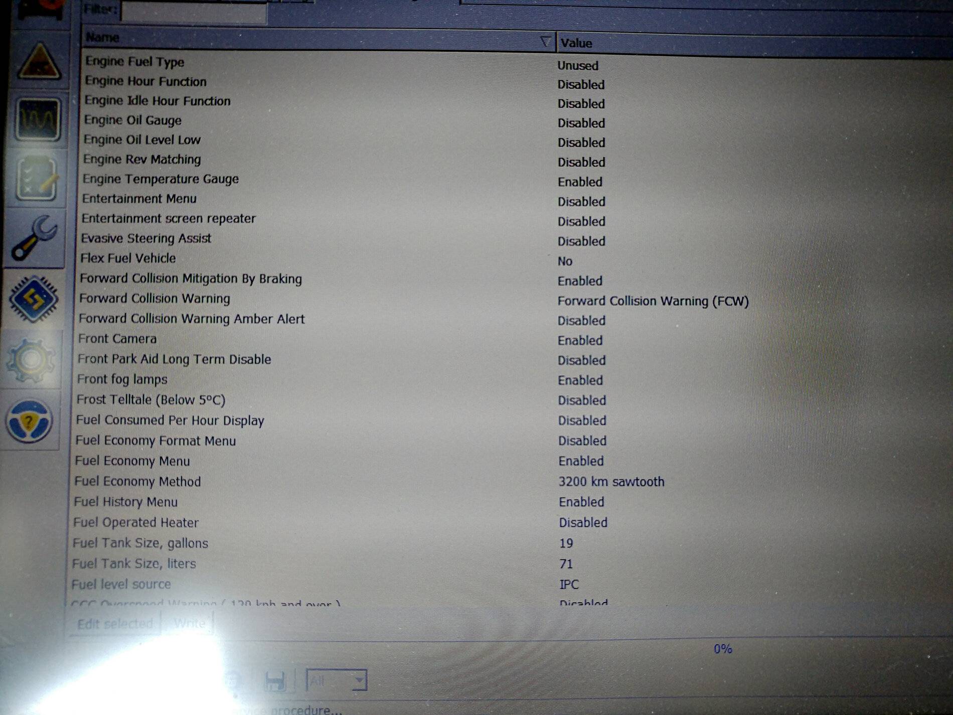

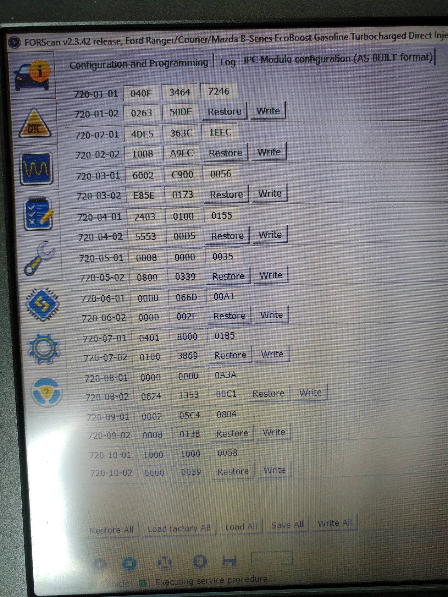

Plz let me know and refer to my photo...thks
Sorry for the delay. I've attached a photo of that section of the IPC module.
But also, I noticed on the F-150 there are four locations that store Forward Collision-related settings. They are:
720-01-02 (IPC)
720-03-02 (IPC)
726-13-01 (BCM)
7D0-09-01 (APIM)
Again, that's from the F-150 so I wouldn't follow it blindly & we can't be sure the byte position is the same (ie 999-99*-999, where the asterisk denotes which byte holds that setting). But it might be worth digging around on the Forscan forum & comparing the values to these? I've a feeling from that forum that some settings enable others that then in turn enable a feature, if that made any sense.
(edit: Also, apparently phone orientation makes a big difference in the Moiré patterns/interference lines in a photo of a laptop screen. Sorry bout that, let me know if any are not readable. The second & fourth are particularly nasty.)
