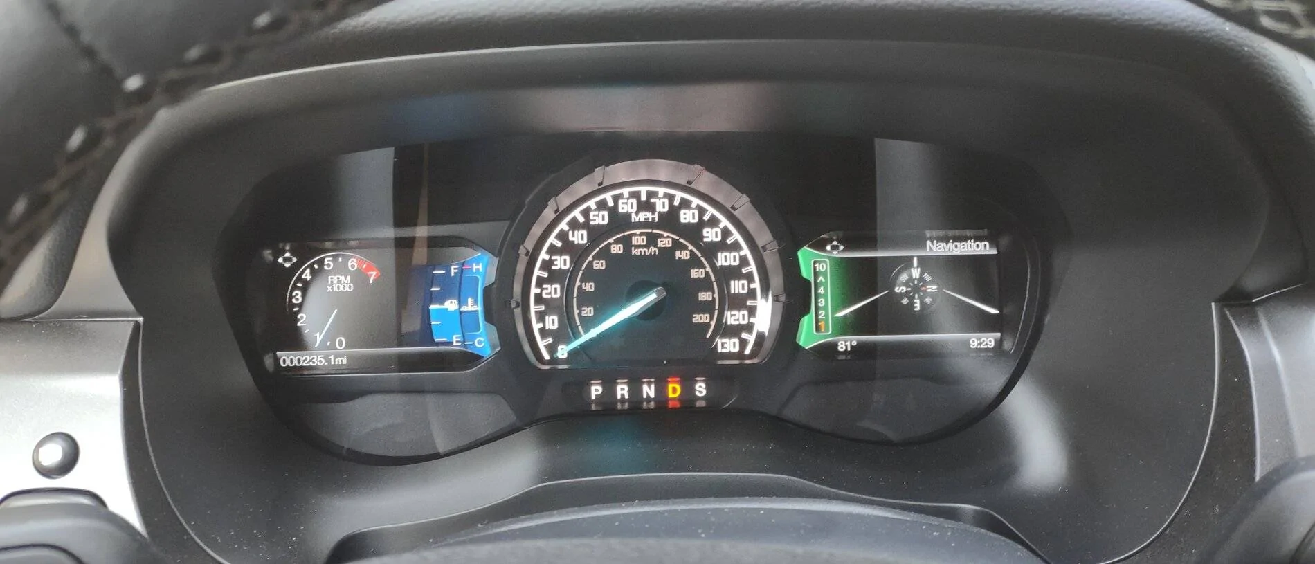

Couple of questions regarding the Lariat instrument panel and ForScan changes.
1. Looking at the right display I can show the gear the transmission is in when in Drive and hitting the down shift rocker. Can't do it in Sport because of course hitting the rocker puts it in manual mode. Is there a ForScan mod that will make the gear selector always be present?
2. Looking at the left display I have the tach, fuel gauge and water temp gauge. There appears to be enough room for another vertical gauge. Is there a ForScan mod to add boost, volts or oil pressure?
Thanks!

Side note but I wish you could put whatever you wanted on the right screen. Most of the time I have the compass up Bc the other screens are useless in my opinion.
Would be nice to have gas mileage on the left and the tach on the right.

1) Nope - S mode doesn't show the gear (for whatever nutso reason) unless you're manually shifting and there's no known current way to add it back - I would be very surprised if it was possible.
2) There is not - we don't have an oil pressure sensor and boost nor volts are available in our PCMs to display anywhere.

Correct to a point. There are no sensors for oil pressure or temp, only switches for idiot lights. Boost and voltage are available for display through aftermarket apps using the ODB2 port. The boost is probably a calculated value using MAP sensor and Barametric pressure. There are several other parameters that can be displayed, just not on the dash displays.
I use Torque Pro to display Boost, coolant Temp, Transmission Temp, Voltage and F/A Ratio while towing.

I'm aware, my point was it's not available to the dash.
I use Torque with OBD2AA to display voltage, boost, trans temp, intake temp, and coolant temp on the sync screen as well as logging it.

I have used OBD2AA to display Torque Pro gauges on my Mustang Sync screen but was hoping to get something more in the dash. My Mustang had an analog boost gauge in the dash between the ac vents but it was out of the line of site and not angled toward the driver making it pretty much useless. I was able to use ForScan to add a boost gauge to the center display between the tach and speedo on the Mustang.
Since I will likely never use the six aux switches on the top of the dash I am going to investigate removing them and put a gauge pod in its place. Anyone know if the switch pod just pops out?
