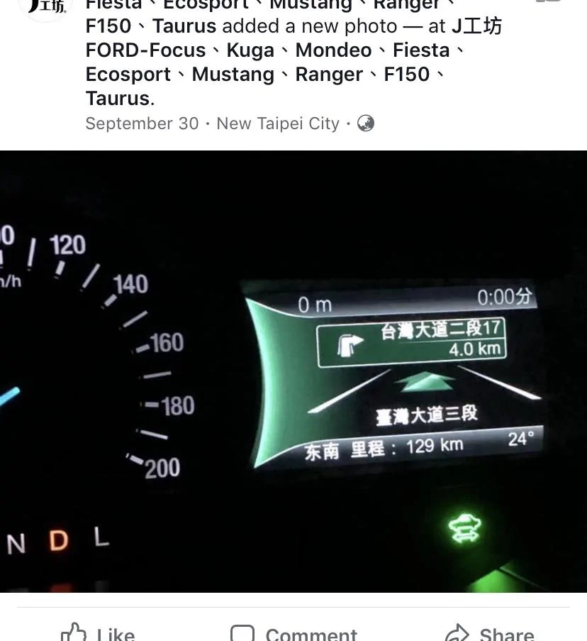

Hi everyone,
Great thread, found many of my questions answered.
Is there anyone who knows how to get the navigation on the right instrument cluster?
Additionally to what’s already in the Wiki, most shops here in Taiwan also offer to unlock “auto door lock” function (doors lock auto. when traveling over certain speed).
Cheers!
