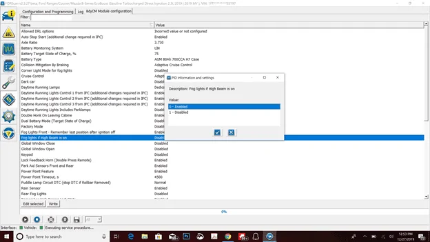

has anyone utilized the new configuration modules where you don’t have to modify any numerical/alphabetical characters(more simplified, enable/disable or options listed)?
Is there a diff between the two?
Easier to modify?
Probability of succeeding in changes in one then the other?
One reason why I ask is I attempted changing the theme and a few other things in the simplified section and it didn’t work. A few did including Key chime, raptor splash screen.
Any thoughts, assistance, solutions would be greatly appreciated.
global windows, start/stop, Bambi mode also I don’t believe worked. Vehicle just shuts off and I receive an error. I did read something about not choosing my saved vehicle though. Will try again without choosing my saved vehicle shortly.

I used the menus for these ;
Disable double horn honk.
Bambi mode.
Corner light mode for fog lights.
Daytime running includes park lights.
They all worked after I remembered to hit the Write button after changing the settings. I think it is a bit safer and easier than messing with the Hex numbers. I did have to use the Hex codes to adjust the speedometer for larger tires.

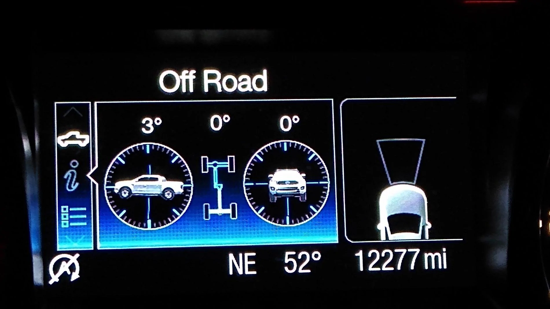

Thanks. That’s the menu I’ve been mainly utilizing as well. Not sure if this helped, but after not choosing my saved vehicle;I was able to get Bambi mode and the 4x4 cluster display. Did try hex with background for Lincoln timeless(black icons) with no success, but when I tried Lincoln next(light icons)and key cycled the ranger and it worked. Afraid to try for timeless again cause the background already looks way better than the default. Another thing I don’t recall exactly what I did but I tried a few things trying to turn the 3 chime on start off with no success until finally all of a sudden it just stopped. Also noticed, instead of my 12v connection I have my New 12 inch dash cam connected turns off a few sec after truck shut off now so it doesn’t stay on for extended amount of time. Something I was researching a solution since I received it. I believe I did Hex for key fob 2 press. Was going to attempt disabling stop/start but believe I should be ok and pass on that for now. Didn’t attempt auto folding mirrors or global windows again to see if I can get them going without choosing saved vehicle. Debating..if I do I’ll let y’all know. Progression not perfection.

There are more options available to change currently in the “Hex” changes, versus the UI options.
When you made the changes using the UI list of Enable/Disable did you make sure to “WRITE” your changes after you made them?

I just went to the Ford as-built to retrieve the factory settings and while it did list a lot of settings, it does not list them all. For example, the list is missing the 726-x so the bambi and the double honk are not listed in my report (used my VIN).
In ForScan, they are listed and I was able to change them.
Does anyone know why some of the settings are missing from the Ford VIN report?
OK. I just stepped outside and remote started. The lights came on. It is dark out and my light switch is on auto. I am not sure that matters, but I will try in again tomorrow when it is light out.
@gfitzge2 I must have screwed up when I did this. So I really goofed and forgot to do the Backup before making changes. As mentioned above, the Ford VIN report doesn't list everything.
Can you please open ForScan and look up the Daytime running lights module and take a screenshot of the settings? I would like to compare yours with mine.
update: I just realized that using the ui to change things does't tell you the hex numbers for the Daytime running lights, so not sure which line is for that. Maybe if we can figure that out, we can add it to page one so people can change manually via hex.
