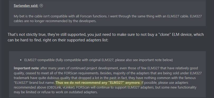

Actually, what I wrote is strictly true. They even say it in the part of their webpage that you quoted, as highlighted below. I stand by what I wrote. I'll bet the cable being used is not compatible with some functions of FORscan. And, the developers no longer RECOMMEND ANY ELM327 cables.
