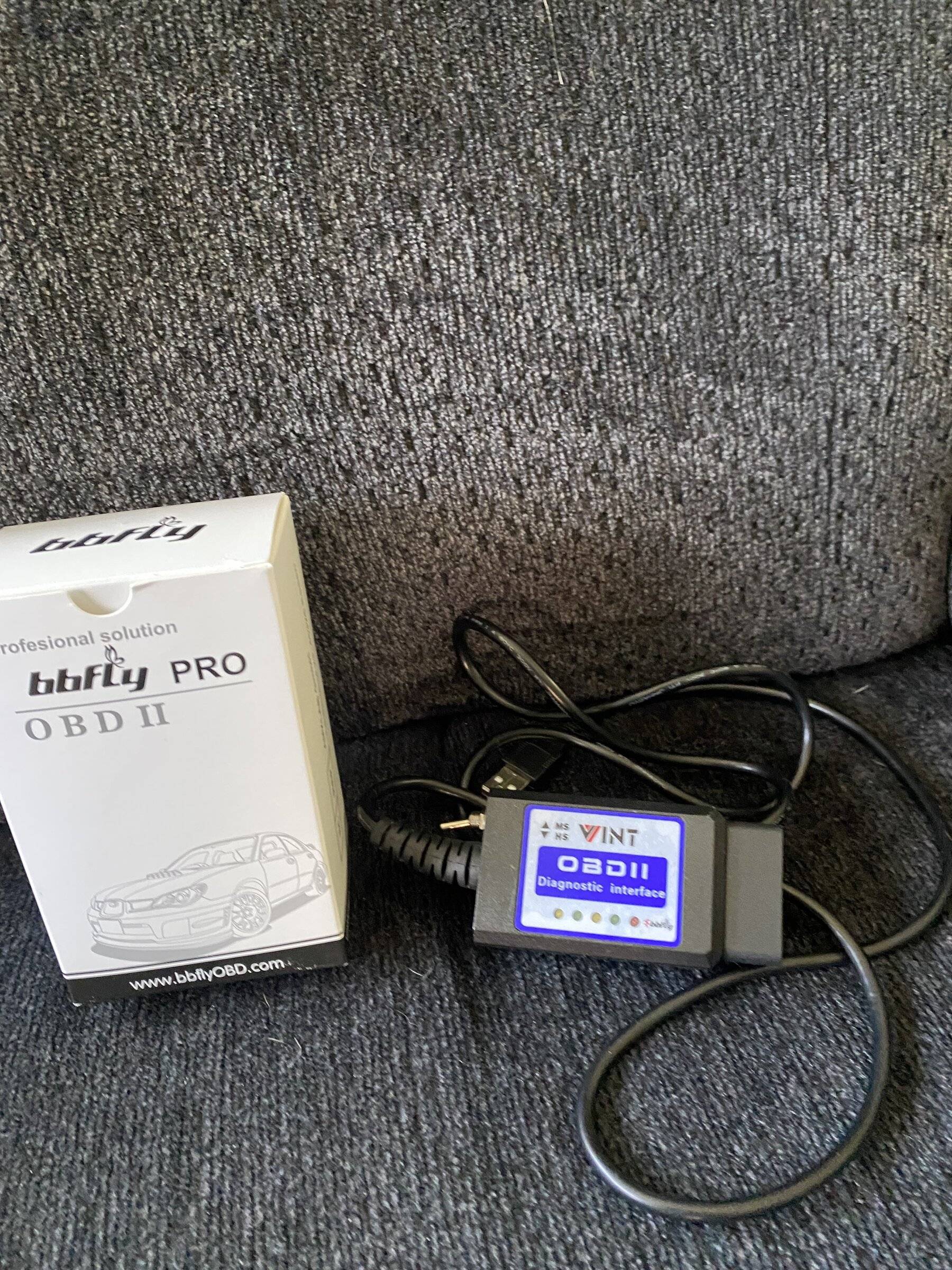

I bought this cable on the advice of a friend but instructions are minimal and I was unable to download a driver to make it work. I may or may not try again. I supposedly downloaded Forscan but when I open it nothing is there and when I tried to register for their forums it told me I didn’t answer the question or enter my email, which I had done. I thought this would be easy but I’m starting to think it’s not worth the bother.
Cable is going back to Amazon.
I have that one and it worked just fine with ForScan on my Focus ST and two Mustangs but would not read all the modules on the Ranger. I used it on Windows 7, Windows 10 and Windows 11 and when I plugged it in it installed whatever generic driver Windows was happy with.
I got the OBDLink EX that was recommended by ForScan and it works perfectly with the Ranger. I have only used it on a Windows 11 machine and same thing it installed what ever driver Windows was happy with.
Forget what “friends” advise and do what the forscan website says and nothing more.

When I went to the website it did not list the model of cable that I had and my computer would not find the driver automatically, I just got "No drivers found".
Maybe it wasn't a good cable. This is the first time in at least ten years that I can remember having to go to a website and download a driver myself.
My cousin owns a repair shop so I might ask him if he has Forscan and a cable. There's only a few things I want to tinker with like Bambi mode and tire size and I'll probably never touch it again.
