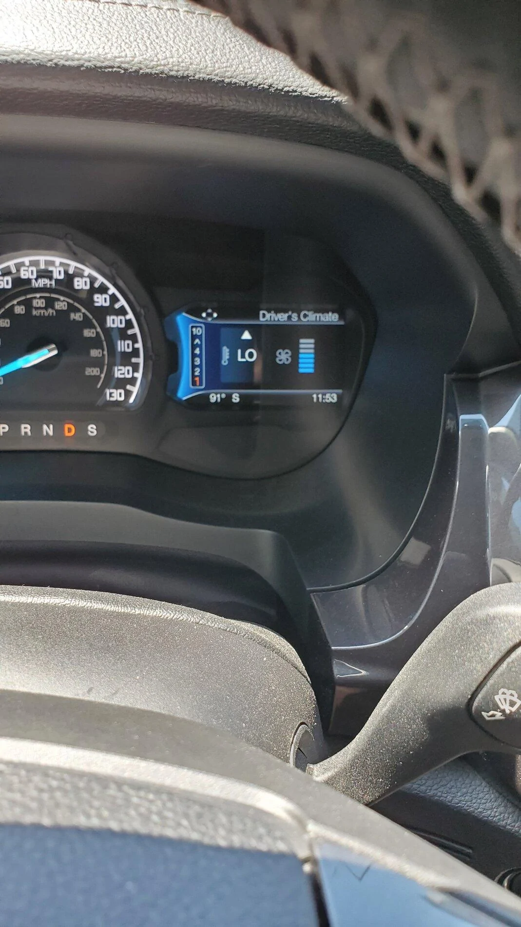

GrandpaD
Mar 19, 2020
Hampton Roads, Virginia
2019 Magnetic Ranger Lariat FX4
Being a little bored, I did the IPC modification for the Lariat climate on the lower right screen that @RCMUSTANG mentioned. As he indicated, the "climate controls" show but don't work. Not a big deal with voice and the 8" screen to control. Shame though.
I did notice (but not sure when it occurred ... either with the Ford 3.4 upgrade or my using FORScan for other things) that the small clock below the lower right box is blank. Just lines __:__ . Everything else shows (direction, etc.) Just a blank clock. I probably never used it but now that I know it's "missing" my OCD is kicking in. Lol
I might reset the whole system and start over now that I'm a bit more comfortable with FORScan.
RCMUSTANG
Ray
Jan 22, 2019
1,867
2,192
Los Angeles
2017 Fusion 1995 Ranger
Just reset the time on the settings. It does that after writing changes.

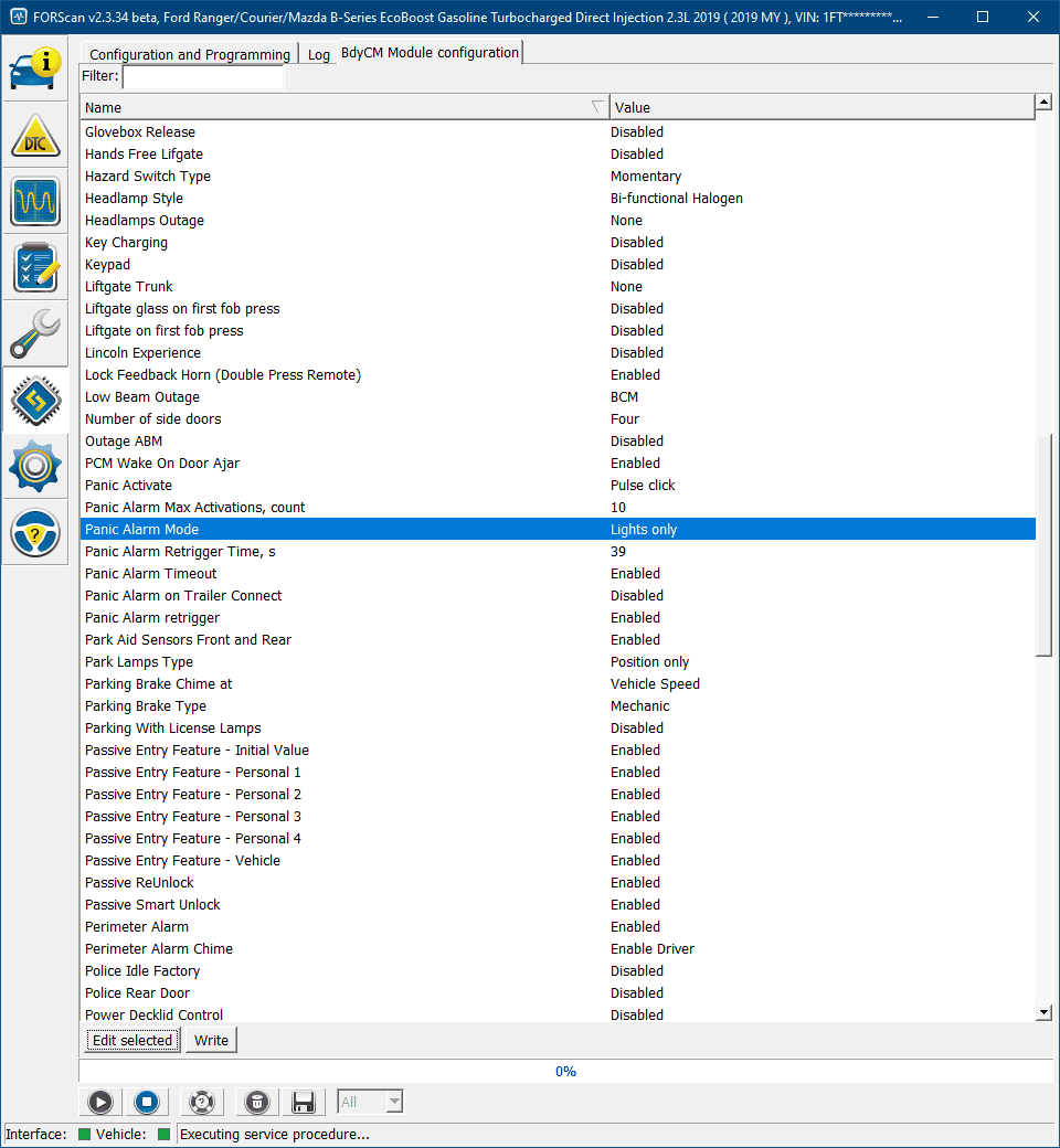

dmeyer302
Daniel
Feb 18, 2019
686
1,646
Carthage, MO
2016 Odyssey, 2021 F-150
Mechanical Engineer
I can confirm that "Panic Alarm Mode" in the BCM disables the horn when you hit the hazard button on the fob in your pocket.
Hirnlego
Jan 24, 2020
82
SC
2019 Ford Ranger XLT 302A
What is "Passive Entry Feature" it is Enabled on your vehicle. Mine has it Disabled.
