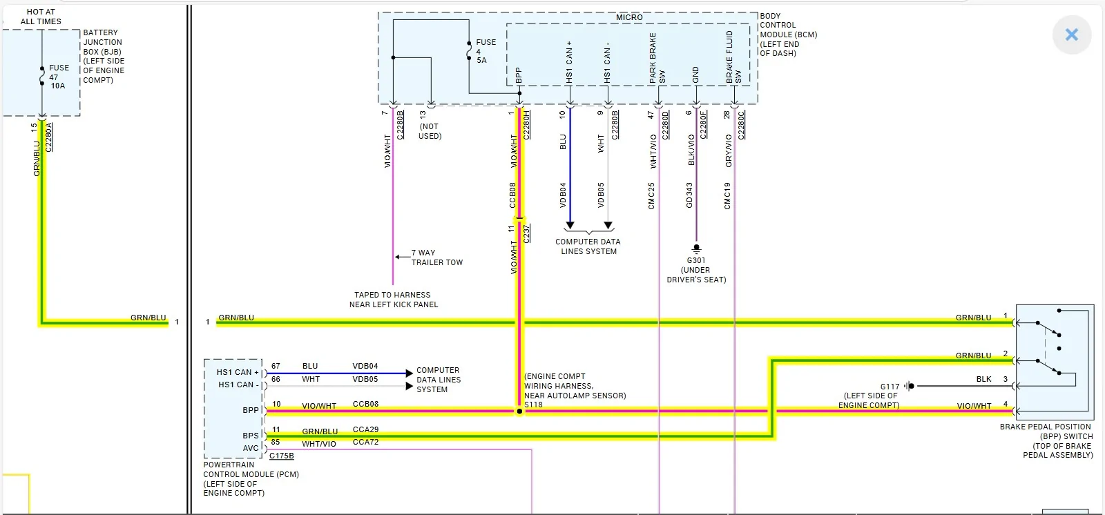

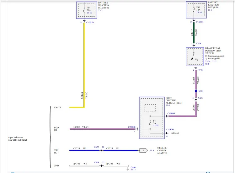

I will try to shed some light on this subject, granted the manuals do not cover a full description of operation of (AEB or ACC Decel - Braking)
TBC (Only Installed)
TBC Wiring
So above we have Power (VBAT) and Ground to the TBC
Then the TBC (Out) to the Trailer Adapter - This is the Trailer Brake Control (Apply) signal
To get that signal the Brake Pedal must be applied to close the switch.
This is all the TBC can do by itself.
Note the missing input (Brake Lights) Applied the Brake Lights come from HS1-Can Bus Data
Power Feed to the BPP
This is a deeper look into the power feed:
Fuse 47 feeds power to the BPP and when the switch closes it sends power to 2 circuits for a signal.
The BCM (BPP) Brake Pedal Position and the PCM (BPP & BPS).
If we focus on the BCM input, the power is tapped off of that 10A fused power and feeds another fuse (Fuse 4) which feeds the input into the TBC and when the micro controller sees a power input on pin #1 it generates a data transmission on HS1-Can to activate the brake lights.
Note: This is Unregulated Voltage - so full battery voltage feeding the TBC
This is where the issue lies, the TBC does not see the Brake Lights Applied (output) and the reason for the Lumen Module as it was designed to pick up that data transmission when the lights trigger on.
I dug into the As-Built Files as well as the Data Transmission Message charts to see if I could find anything that showed if - During a (Automated Braking) event do the brake lights pulse?
I do not see anything stating or showing that.
I would expect I would find a (As-Built) setting to configure it - I do not see it.
But did find this setting in the As-Builts
BCM- 726-26-01 xxxx-xxx3-xxxx - We are set to 3 - Control Stop & Position Configure
3=VRMS/VRMS
Options are: 0= Duty/Duty - 1= Duty/VRMS - 2=VRMS/Duty
So the BCM is using this to stabilize and regulate the voltage on the Brake Light Circuit.

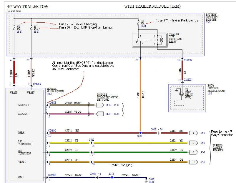

BCM- (HS1-Can) - GWM / GWM - (MS-Can) - TRM
NOTE: This is from the input of the Brake Pedal Position Switch (BPP) which powers the Brake Light circuit. Note the BCM is the originating module.
NOTE 2: the TRM feeds power out to the Trailer Connector, so if you tap the input at the trailer connector its a secondary source.
Note: Being that this is the only message that specifically states that the message is being sent to the TRM, I think that any and all HS1-Can (Brake Light) apply messages will also trigger the trailer lights on no matter what module initiates it even though they do not list it as a receiving module.
Trailer Lamp Connected:
TRM - (MS-Can) - SODL/SODR - GWM / GWM - (HS1-Can) - PAM - PCM - BCM
GWM - (HS2-Can) - ABS -IPMA / GWM - (HS3-Can) - APIM- IPC
So in short the Brake Lights are controlled (Triggered to Power) via the HS1-Can Bus by the BCM and at the GWM that data transmission is shared by the MS-Can bus feeding into the TRM
The reason for the Lumen Module is it needs to be able to (read) the HS1-Can data to see that the brake lights are applied or requested or the secondary data message from MS-Can.
Since the Lumen Module uses the CHMSL as its input source - the CHMSL is commanded on by the HS1-Can bus signal that is powered from the BCM as you will note any Brake/Stop Lamp request is sent along the HS1-Can bus.

TRM - Output (MS-CAN) options
As the HS1-Can data is sent to the TRM, the TRM translates the HS1-Can data and activates the Brake Light output power to the trailer connector.
This is secondary data transmission and to get an input that the brake lights are requested on requires it to go through the TRM to get it.
Now we know that the Lumen Module will accept the input that the BCM outputs but will it accept the output signal of the TRM (?)
2 separate modules providing the power source for brake lights depending on where you tap for it and since we do not have the (Lumen) requirement specs for that input voltage it would be best to stay with the BCM output source, In my opinion.
Does it matter ? - IDK - Probably Not
But here are some options:
Wire Tap either Brake Light (output) at the TRM itself, keeps it inside the cab - short wire run
C2498C
Pin #1 = Left Brake Light
Pin #8 = Right Brake Light

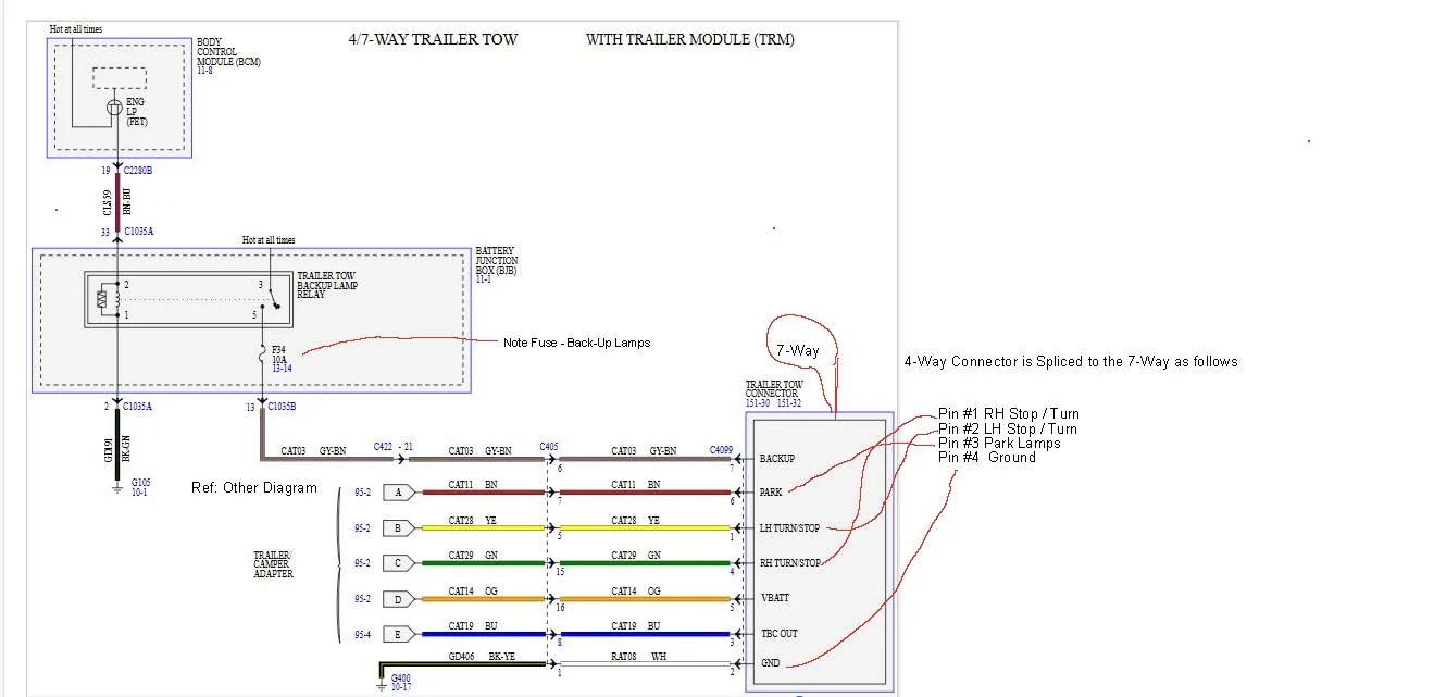

Wire Tap either Brake Light (Output) feed at the Truck Side (Trailer Connector)
Edit:
Thanks to @BigBlue - highlighting my error in overlooking (forgetting) that important detail as I have been through this circuit in the past and vaguely remember the TRM does (intermix) the 2 light circuits (noted below)
I am now editing my above and due to the fact that the circuit from the TRM (Back) to the Trailer Connector would be powered by both Brake & Turn so the turn signal in addition to the brake lights would be a input to the Lumen Module, it would know know the difference.
So this rules out the TRM and Trailer Connector as a tap point
From my previous venture into the circuit as ref
C2498C

The main reason for using CHMSL location is this is the only location in the cab to get at the brake light signal without taping into the wiring harness, or creating a huge T-harness for 2 wires under the dash. Something Ford would not allow, and could not do for safety reasons. Definitely a design miss by Ford.
I may be wrong, and probably am, but I believe the Lumen module is used for signal conditioning of the PWM signal used, for whatever reason, and isolation of any voltage from the TBC getting backfed to the PCM.
Now to my issues with the suggestion of tapping into the brake light signals from the TRM. The problem with this is. Do to the, let's call it outdated, wiring standards for trailer wiring. The outputs from the TRM have the brake lights and the turn signals combined into the same wire. This means which ever side you tap into, whether at the TRM or the 7-pin connector, will cause the trailer brakes to pulse when the turn signal for that side is activated. This an issue that any plug mounted or trailer mounted brake controller must deal with.
