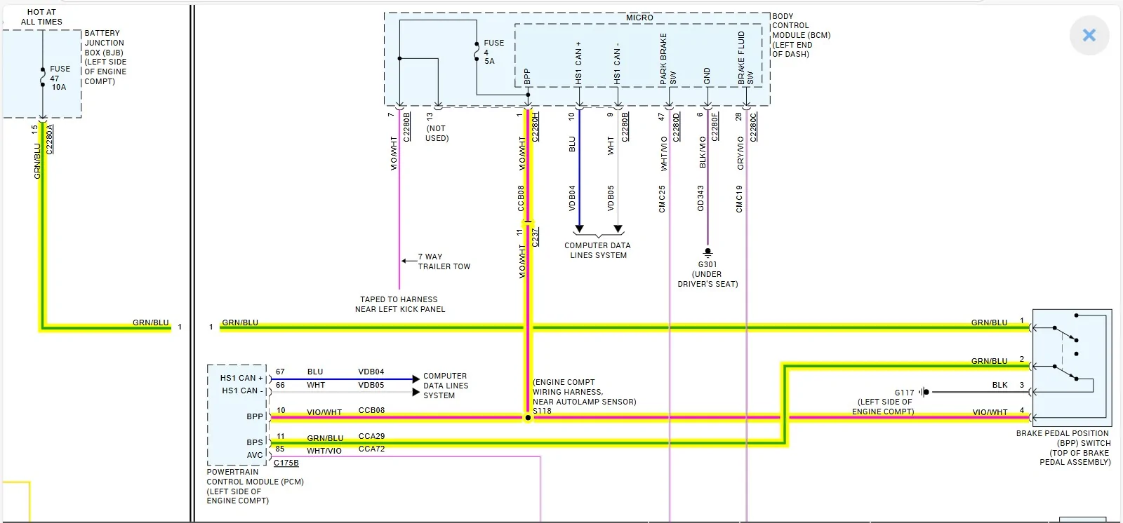

The output of the Brake Switch (BPP) signal is going to be more of a constant voltage - when viewed on a scope as this voltage is direct off of the (BJB) fused feed - it will be more of a straight line however increasing or decreasing with the battery voltage.
So the plan is to - back probe 3 total signals to compare:
The BPP - CHMSL and Brake Light, since the BCM has the CHMSL on a separate circuit, I want to see if the waveform is different and may show the reason Lumen taps to that vs Brake Lights.
as this is the only true way to find an answer and what will the testing show.
Same or Different waveforms.
I have a hunch I am going to see a difference between the BJB and BCM outputs, not sure between the CHMSL & Brake light - I think they will be the same.

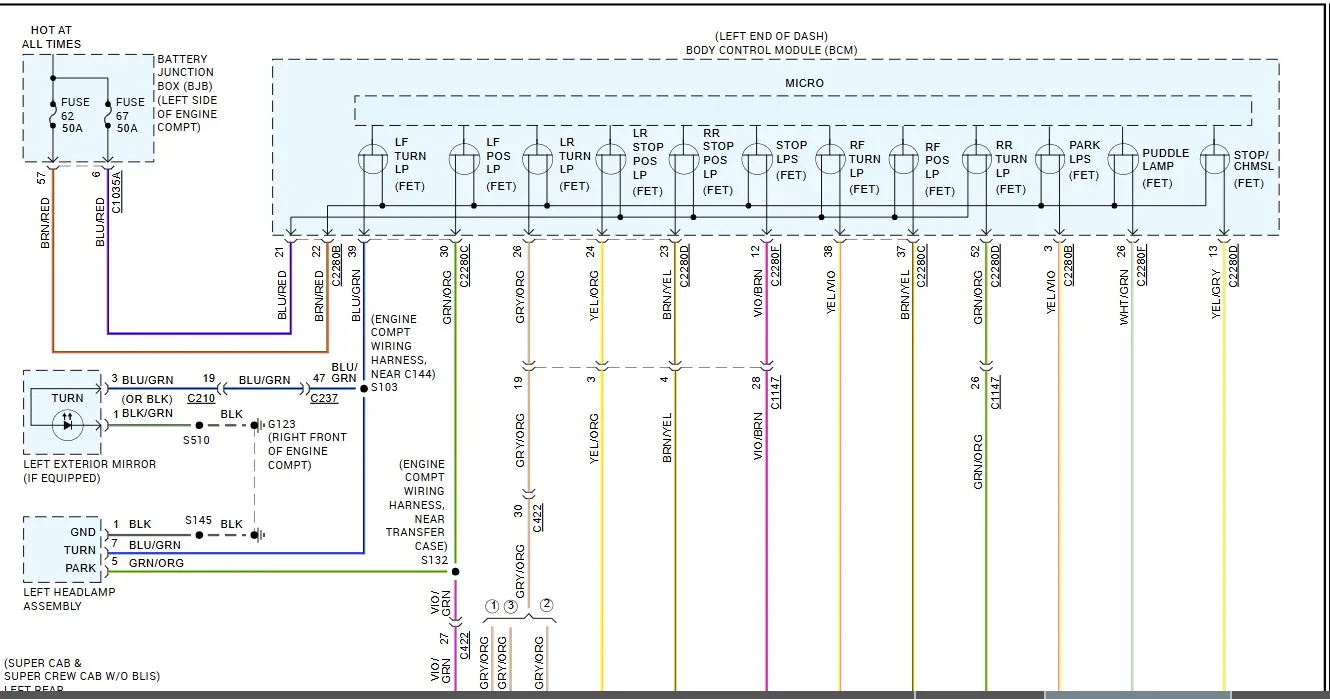

For a Ref:
What is not shown here - it takes a Can Bus signal to provide the output power to the circuit
These would be Stop Lamps and Stop CHMSL.
So it boils down to - how does the internal circuitry of the BCM control the power output through the (FET) Field Effect Transistor
I know the basics of the (FET) protection - Control & Monitor the output, but what does the actual voltage output look like in a waveform?
We know that the BCM is very finicky with outputs when others have added lighting etc, this is the reason why - the FET protection that is programed into the BCM and the unknown is:
What is the Min/Max allowance variable (of Current)before it triggers a fault or flicker/flash issue?

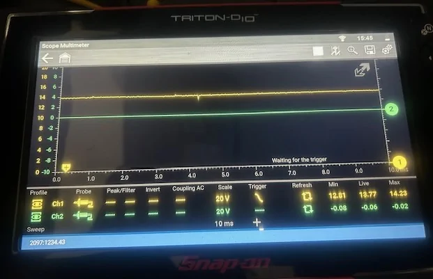

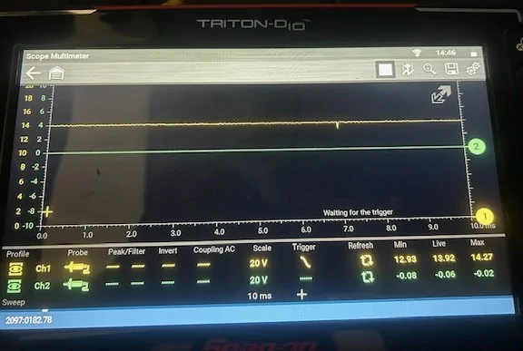

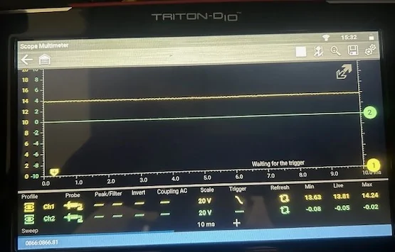

Ok, as I said - I need to dig into how to truly use the Lab Scope
I could have used 2 signals on each (Screenshot) but was planning initially on picking up the (Light-Outputs) at the lights themselves but then decided on using the BCM Outputs for the lights instead.
I could not figure out how to (Zoom) in on the signal but did get the (timeline) down to 10ms and 5ms as well - did not have the instruction manual in the garage with me - :question: to get tighter views, so I need more self training on its use.
But I did pull out the information that I wanted from this little trial use.
Notes: for tapping points:
BPP Output - Direct off of the Violet/White wire that is in the (4-Wire) tapped set, this is the voltage input signal to the TBC that the Brake Pedal is pressed.
CHMSL Output - Probe Tapped into BCM Connector C2280D - Pin #13 Yellow/Grey, this is a direct feed to the CHMSL
Stop Lamp Output - Probed Tapped into BCM Connector C2280F - Pin #12 - Violet/Brown, this is a direct feed to both Left/Right Brake Lights.
I wish I could have figured out how to get a (Zoomed) waveform but if you look at the: (Min-Max) voltages in these shots - tells me the information I was wanting to know.
All of these shots were taken when the brake was applied and the waveform (refreshed) and the engine is idling.
BPP (Brake Pedal Position) Output
So this is following actual battery voltage and you see the charging variation of (0.61v)
I had my (Voltmeter) plugged in to the Power-point) as well and the voltage matched the Live Voltage.

CHMSL Output:
Note the variance in the (Min/Max) and when you watch the waveform (live) you can see some voltage fluctuation as this is a load and lighting the LEDs, but I do not see a (Switching) or pulsing waveform like I thought I would see, I even dropped down to 5ms here and did not see what I think should be more or a Square Wave

Stop / Brake Lights Output (Taillights)
Same signal as the CHMSL

On the other side of the coin, we need to also factor in that they need to tap off of the Brake Light circuit for the input.
This adds a Power & Ground to the circuit that the FET is monitoring (Can Bus) sees this and can possibly trigger faults as its out of its monitoring OEM specs.
The Lumen Module may be only needed to allow (Error Free) tie in that the TBC cannot do.
