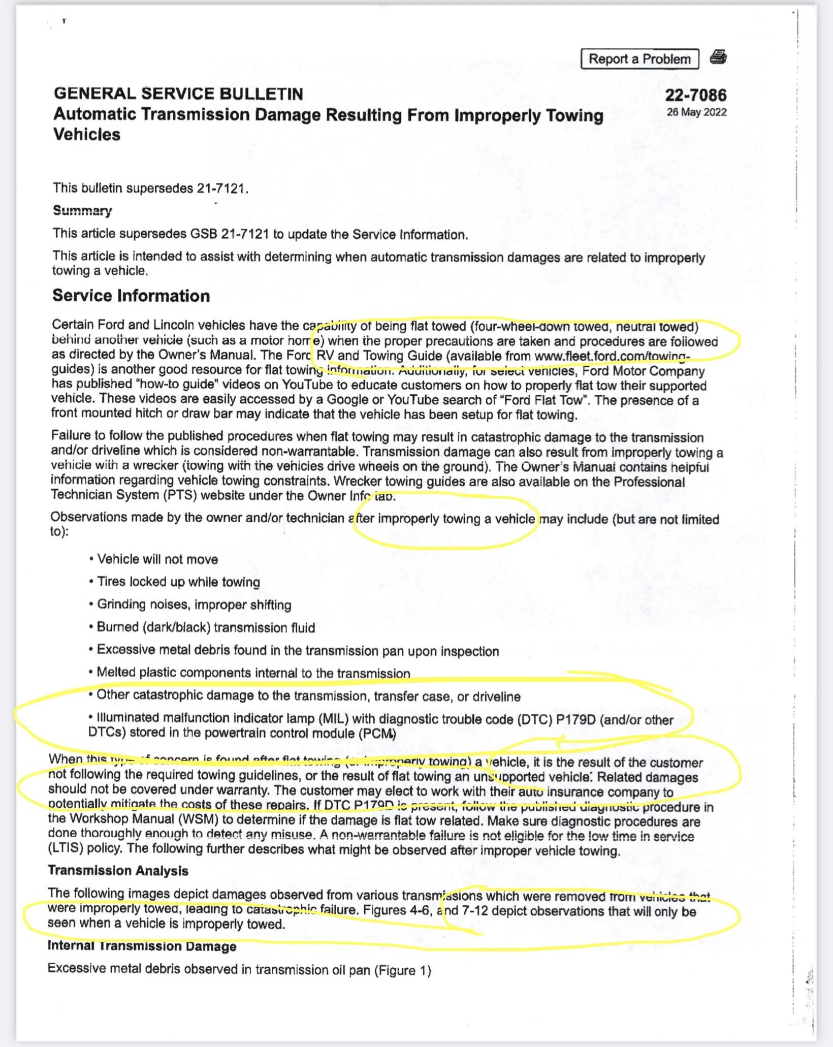

The denial was based upon a memo/directive from Ford (i was given a copy of the memo) that stated if this damage occurs deny the warranty. No one verbally stated that I was in error regarding placing the Ranger in neutral tow. The denial was based upon the memo and not discovery of the problem.
Let's see this "memo."

It’s all in that SB - it talks extensively about “improper towing”, ”procedures”, and it gives a code that could be thrown, talks about others. It also includes attached photos that show the dealer what to look for.
I would guess this was denied based on what the dealer discovered when they examined your truck, not just a memo that said to deny all these claims. Rather, it says, when you see any of this…deny the claim.
The dealer is the party that needs to tell you what was found. I’d demand to know what it was.

After reading the GSB, I can see why the dealer would reject the warranty claim. Ford is essentially telling him that this damage can only occur due to operator error. Of course that doesn't mean that Ford is correct, but as a dealer, he can't afford to do the work and then not get his reimbursement when Ford denies the claim.

What the Service Bulletin really says is if you are dumb enough to warranty a transmission with this failure and DTC the claim will be denied. Don’t blame the dealer.

And contrary to your earlier posts they (Ford) ABSOLUTELY say you did it wrong.

I don't know anything about towing a Ranger. But that memo seems to state no warranty for improper towing. For example, "It is the result of the customer not following the required towing guidelines." Not saying that is true in your case. So is Ford claiming you didn't tow it properly as a reason to deny the warranty claim? And if so what did they provide as proof that you didn't follow the required towing guidelines? The later is something I'd certainly ask them based on that memo, "Can you show me proof I didn't follow the required towing guidelines?"
I guess it could be a situation where it is your word against theirs in that case. But I'd still request any information they have that can show you didn't follow the guidelines. That memo to me reads like if X happens the customer was obviously at fault no questions asked. Oh also funny it mentioned Google Youtube videos for "Ford Flat Tow" information because I guess they think owners should not rely on the manual and have to do Google searches for more information. :)

Sounds like a Ranger has no tranny warranty while it's being towed , be hard to prove you did it "right " , according to them , even if you do it exactly right and then a part fails while in tow and gets ground up , still your fault , they seem to be taking the position that it is IMPOSSIBLE to have any damage if you did it right ,I have no idea if that's true or not ...

Sounds like dealer made their determination by codes stored possibly? I would like to see the readout from the module to set the record straight. In other threads owners did follow the instructions. It seems transmission grenades if battery voltage falls below a certain threshold.

I just read the procedure a little bit , you do have to select and save and verify stuff is enabled, I could see it going bad , BUT , even if you do it correctly and something fails , they can wiggle out it looks like...
