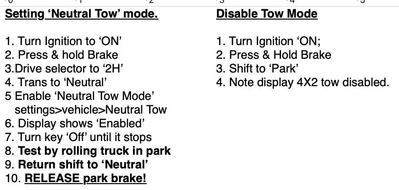

Here is my issue and question about Flat Towing?
This is from a 2022- Online Version of the manual.
Note: The printed version of the 2019, 2020 and 2021, Leave out Step 8 of this On-Line Version
But my question and I believe trips up owners is:
Note: These steps from below.
Step 2, Press and Hold Brake Pedal
Step 3 through 8 - (Still Holding Brake Pedal)
Step 9 - Still Holding Brake Pedal, but with an extra (WTF)
Now for Step 9, Hello Ford, how do you expect owners to perform this step when you have not instructed to release the brake pedal.
Note: Step 9 clearly states, (With-Out) pressing Brake Pedal, so how are owners expected to follow this poorly written documentation?
My thought is that if you follow the procedure and while holding the Brake Pedal, then the engine will start (Brake Interlock Switch-Engaged)
Owner then (oops) and cycles key/button and now the proper sequence is out of whack. I am theorizing that that misstep is somehow the cause.
Step 10: Release Brake Pedal
So, I am only assuming here, Steps 9 and 10 are reversed.
Plus, Step 9, is vague for (Keyed Ignition), I have a feeling that the Keyed Ignition (Rangers) may show the most issues, as they miss the statement.
Turn the key as far toward the off position (The manual leaves out) the rest of the sentence or needs reworded to: (Turn key as far (Back) (Toward the Off) Position as the key will turn, thus taking it out of (Assy) mode. I think that this small step is causing the key to be left in (Assy Mode)
Then Battey voltage drops, and disables the Tow Mode memory, and reengages the transfer case.
I believe what Step 9, neglects to point out, is that the key will not fully turn to the off position, to remove the key, but it will turn back towards the off position and take it (off) electrically. (Out Of ASSY-Mode)
I do not have the keyed ignition but think that this is how it operates.
And to make the procedure more confusing, they add the note under step 9, to leave the key in the ignition, thus another step where you are led the think that the truck stays in (Assy-Mode)
For those that have successfully flat towed, what am I missing here?
I am trying to grasp what is actually happening here, and why this appears to be an issue for many owners.
And I believe the Improper Steps of 9 and 10, and the wording of Step 9 itself is the root cause of this issue.

I have a 2019 Lariat FX4 with electronic (keyless) start so I can't directly answer your question. The following is my check list to start towing behind my motorhome. It has a couple of extra steps in there just to make it best for me.
1. Connect Ranger to RV
2. Fold up outside mirrors. (Pressing button above mirror controls on dash to the left of steering wheel.)
3. While the Ranger engine is running, press and hold the stability control button on the lower console for 3-5 sec. ( In front of shift lever, last button to the right on lower row. Looks like a car skidding.) A display will appear that says Stability system is off. Turn off engine. (Note: if engine is started again, Stability system will auto-turn-on, so you would have to repeat this again to disable.)
4. Press the engine START/STOP button once without pressing the brake pedal.
5. Press and hold the brake pedal.
6. Select Recirculate Air from front panel
7. Note: if Ranger in 4-wheel drive, rotate the four-wheel drive switch (by shifter) to 2H
8. Shift the transmission to neutral (N).
9. Enable Neutral Tow by selecting Settings on the instrument panel display menu via arrow keys steering wheel left side
10. Then select Vehicle.
11. Then select Neutral Tow and follow the instructions on screen.
12. Note: If successful, the information display shows Neutral Tow Enabled Leave Transmission in Neutral. This indicates that the Ranger is safe to tow.
13. Note: If you do not see the message in the display, you must switch the ignition off and perform the procedure again from the beginning.
14. Release the brake pedal.
15. Press the engine START/STOP button once without pressing the brake pedal. Take your keys and lock Ranger normally.
16. . Turn on brake system (on left kick panel) switch to the right

Thats my point, you are releasing the brake pedal before you select ignition to off, my above post is direct from the owner's manual as the very last step (Step 10) release brake pedal, so if owners are following the exact procedure posted in the owner's manual then it is a Ford issue as you followed the written and documented procedures as outlined and I believe they are poorly written and incorrect procedures.
The last steps are important, and I think owners are unintentionally leaving the truck in ASSY, BMS kicks in and starts dropping modules to save the battery, and it ends up out of tow mode being engaged, trashing the transmission in the process.
I agree with you on ambiguous wording. I followed the manual's steps (for my push button start Lariat) and at the last step, you must release the brake in order to obey last step to push start/stop without touching brake pedal. If you don't do that, then the engine starts while still in 4 down mode. Maybe in court, you could convince a jury that the manual could not be followed as written. But it would be Ford's lawyers against yours. My pockets aren't that deep. I suggest that anyone from Ford reading this, get a memo to rewrite that section asap..

OK, it has been 1 year and another 7500 miles towing my 21 Ranger without any issues, I do take precautions as in photos of the dash display at the start and finish of the tow event. I have a tow charger to keep the rangers battery full, and follow a checklist to both engage and disengage tow mode. With a total of about 15,000 miles flat towing not one issue. (except for that one weird steering thing which might have been my fault). This is the checklist I use if interested.
