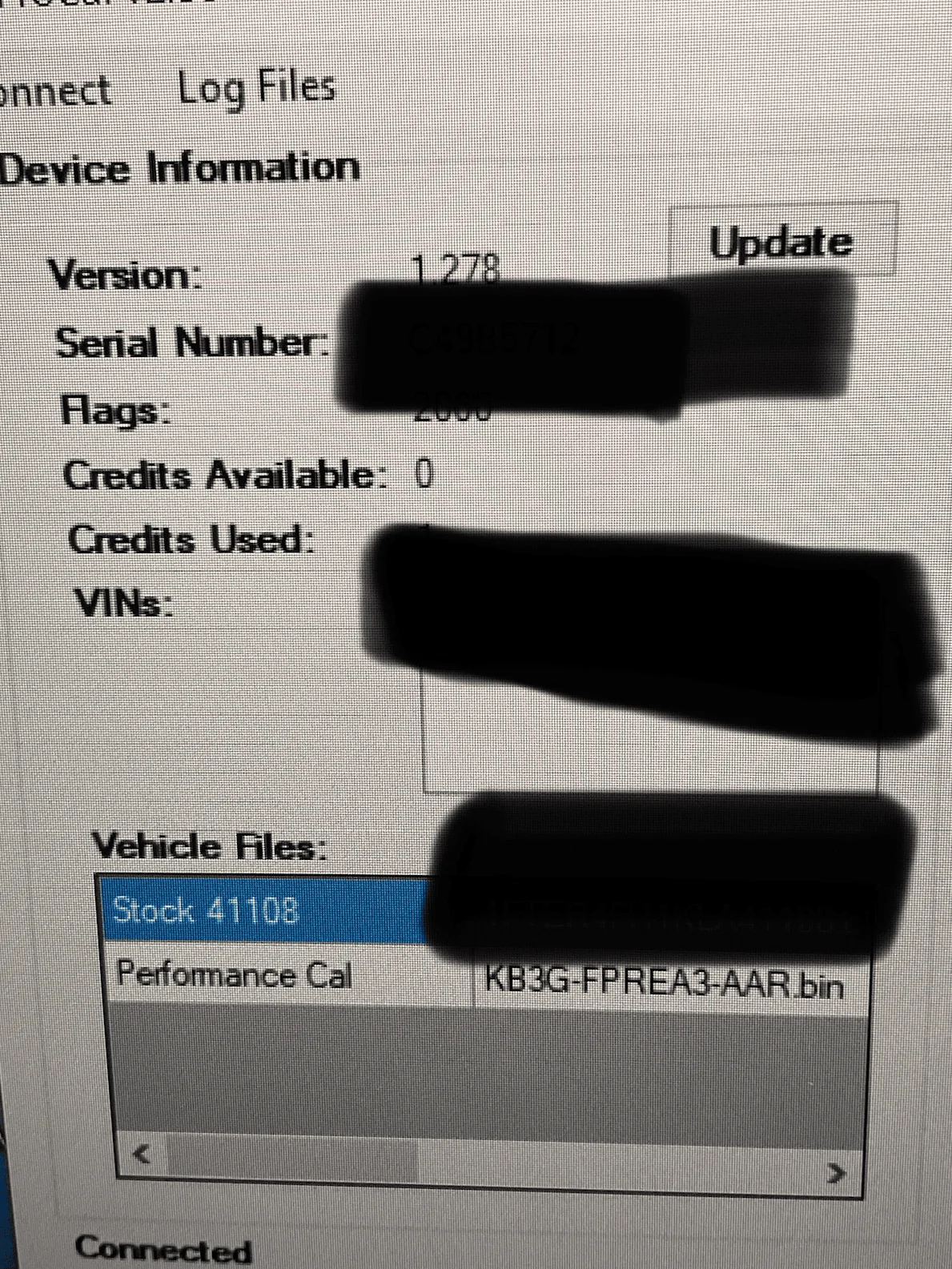

You only had access to the KC.bin file at first too?
That’s what mine was before it went to .AAP. I was able to download from the site but I asked them what the latest file was and they just said how to download the latest file. They never told me what file number was newest. Since then I downloaded .AAR
I will say the .AAR tune is the best of the three. Runs about the same in all three but the transmission is way better.

Interesting, I just updated mine and the file is LB3A-FPREA4-ACB.BIN
Wonder why it is different?

Just in and this will clarify. Quoted from engineers respond to tech’s inquiry about latest files:
ā€œJohn Doe (he addressed me by name lol)...from engineering:
ā€˜For a 2020 KC is the latest with trailer tow. If it’s a 2020 with the torque convertor change LB3A-FPREA4-ACB is the latest.ā€™ā€
-Couple things to note. I never told them I have a base model 2020 XL. That tells me some legit legwork was done to look up my VIN to see what .bin was correct.
-Note how engineering response is worded ā€œfor a 2020ā€. This tells me each .bin depends on Yr. model.
- I have never heard of a ā€œtorque converter changeā€ option in the Ranger. With my truck being a base model it must not have the fancier converter or the higher end models must have some additional converter tech built in. So it appears if you have an ā€œAxx.binā€ file after updating you have the referenced converter change and if you have a non ā€œAxx.binā€ file you do not.
So in conclusion, my update to the KC.bin was indeed an upgrade since I got last update in Sept 2020 (old file was HB1.bin or something like that).
RP930 and others who had that KC.bin file prior seem to have had a tune not optimized with the torque converter tech in their trucks and the Axx.bin tunes correct that leading to a better driving experience.
I bet it has electronic converter lockup or something like that and those sensors needed to be calibrated too. Until Ford got corrected they said no towing to be safe. So now, tow away. Kudos to Ford for doing the right thing with free tune updates.

how are you getting to this screen? sorry but I struggle with this stuff

I can get to that but when I download the procal 4 it simply ask me to save it, which I do, but it never seems to "run" meaning it shows as downloaded but from there nothing happens. I plug in the procal device and click the download and I get zip.
