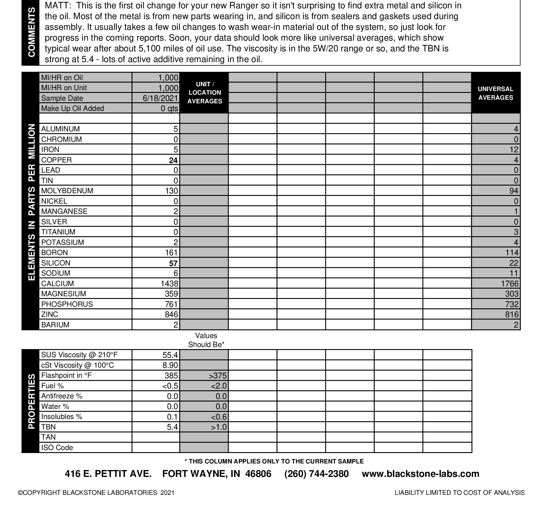

Why did you change your oil after 1k miles? am I missing something?
Brand new truck, he wants a baseline report on Oil status & engine wear. I will be doing the same shortly, bought the oil sample pump from Blackstone, came with 2 sample bottles and mailers.
