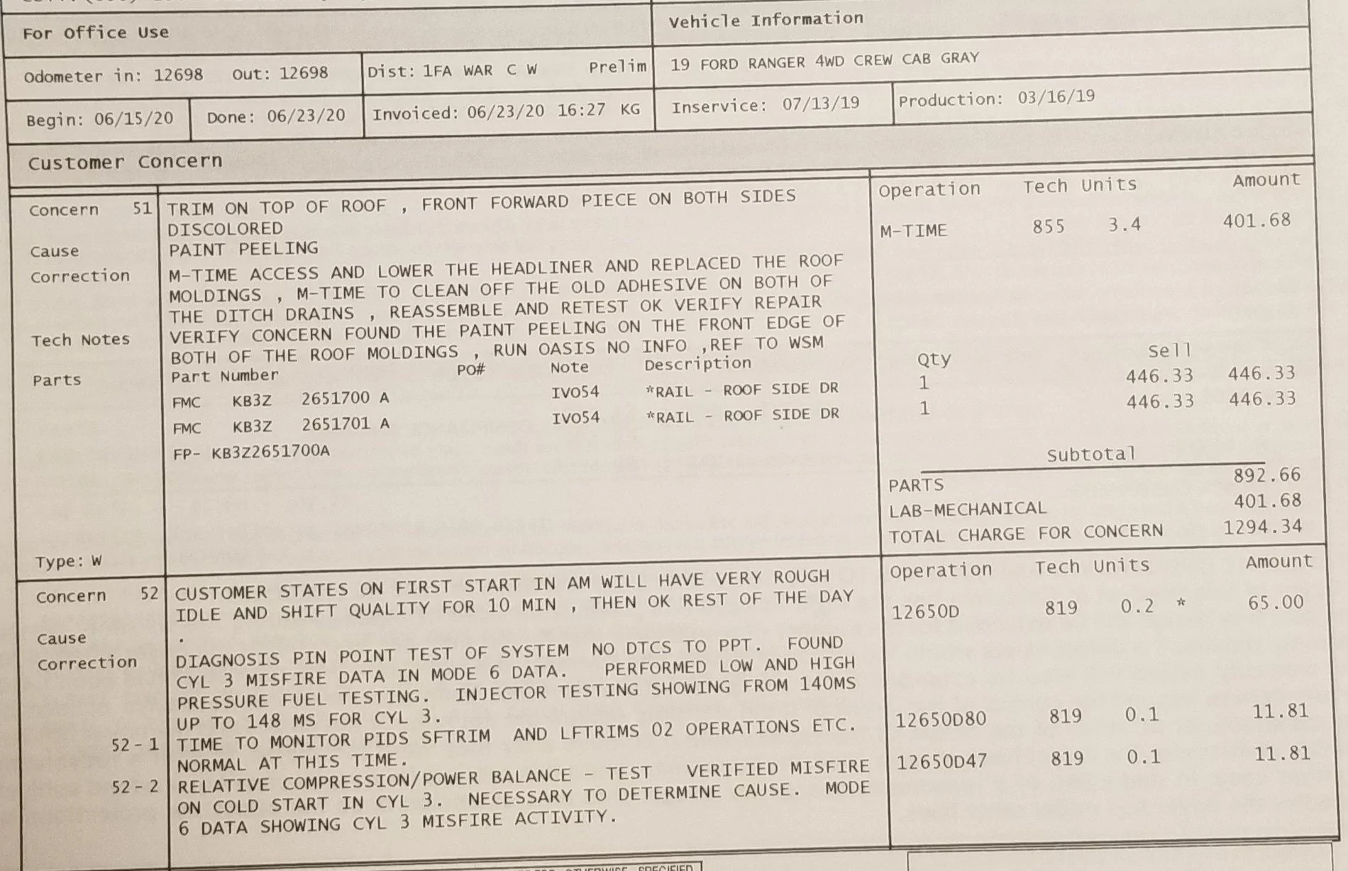

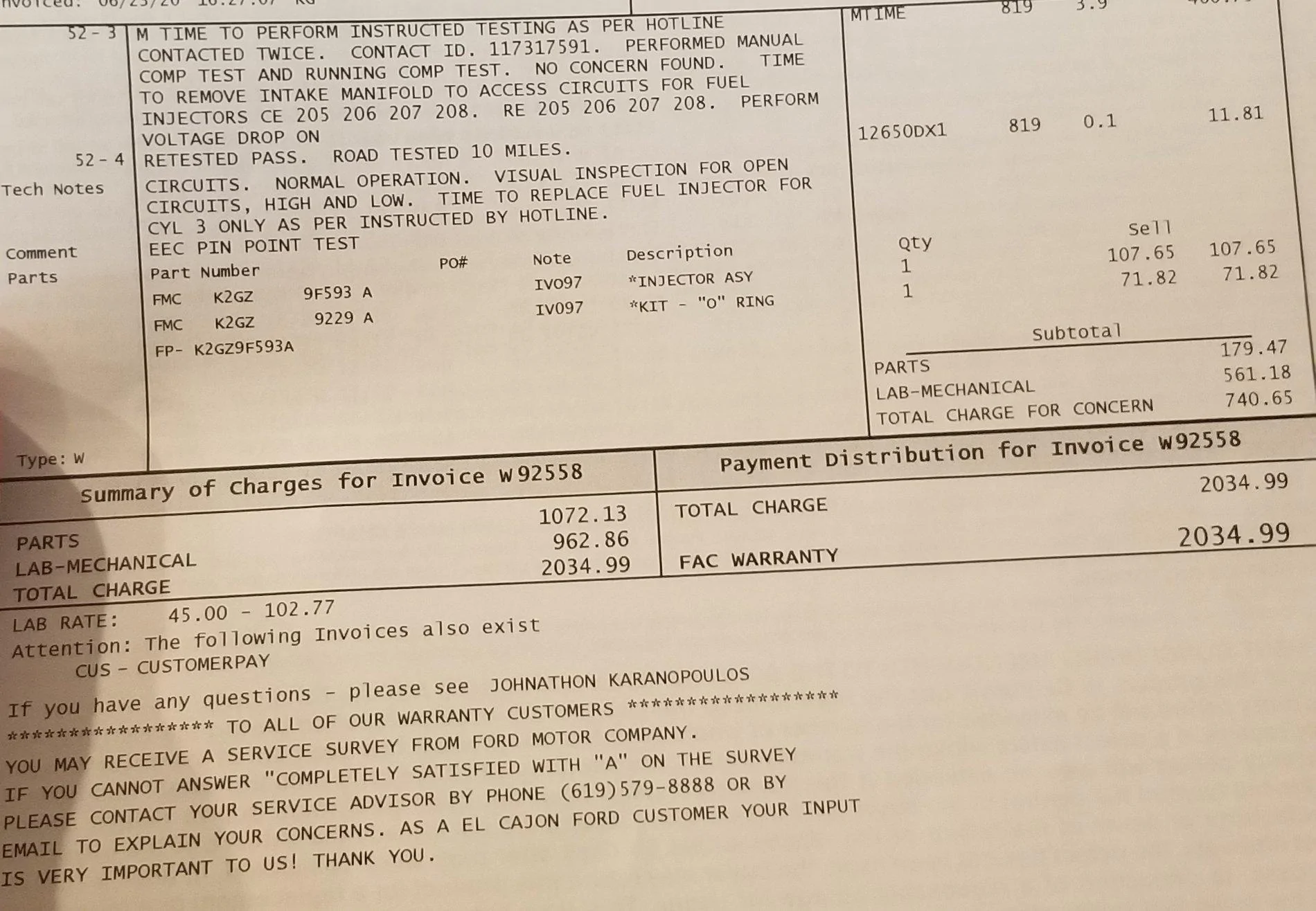

Got my truck back and here is what was done under warranty. See attached pics.
I must add that El Cajon Ford did a FANTASTIC job thoroughly addressing my complaints.
Hi Kevin,
More importantly...did this repair fix your problem?

BDUb we are all waiting with baited breath to see if the problem is resolved. One start is fine; lets see after more cycles. Please check back in a week or two.
Phil, thank you for your input. It is great that you share your knowledge, expertise and incite.
10-4...this morning cold start and go 0 shudder/srudder felt really good. Will post again next week. Please remind me if I forget.
