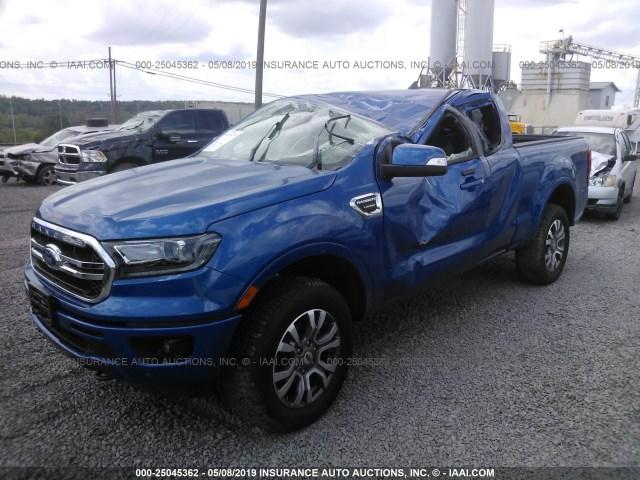

remember this truck?
the owner had an engine stutter.
he fixed it with a chainsaw on a windy day....just sayin'
Took the insurance money and bought that jeep truck thing.
Probably not a good choice in replacement vehicle.....FIAT is ruining Jeep.
Mine was a POS that i bought new and owned for less than a year. Was in the shop more than i had it.
Should have lemon lawed that months ago.
